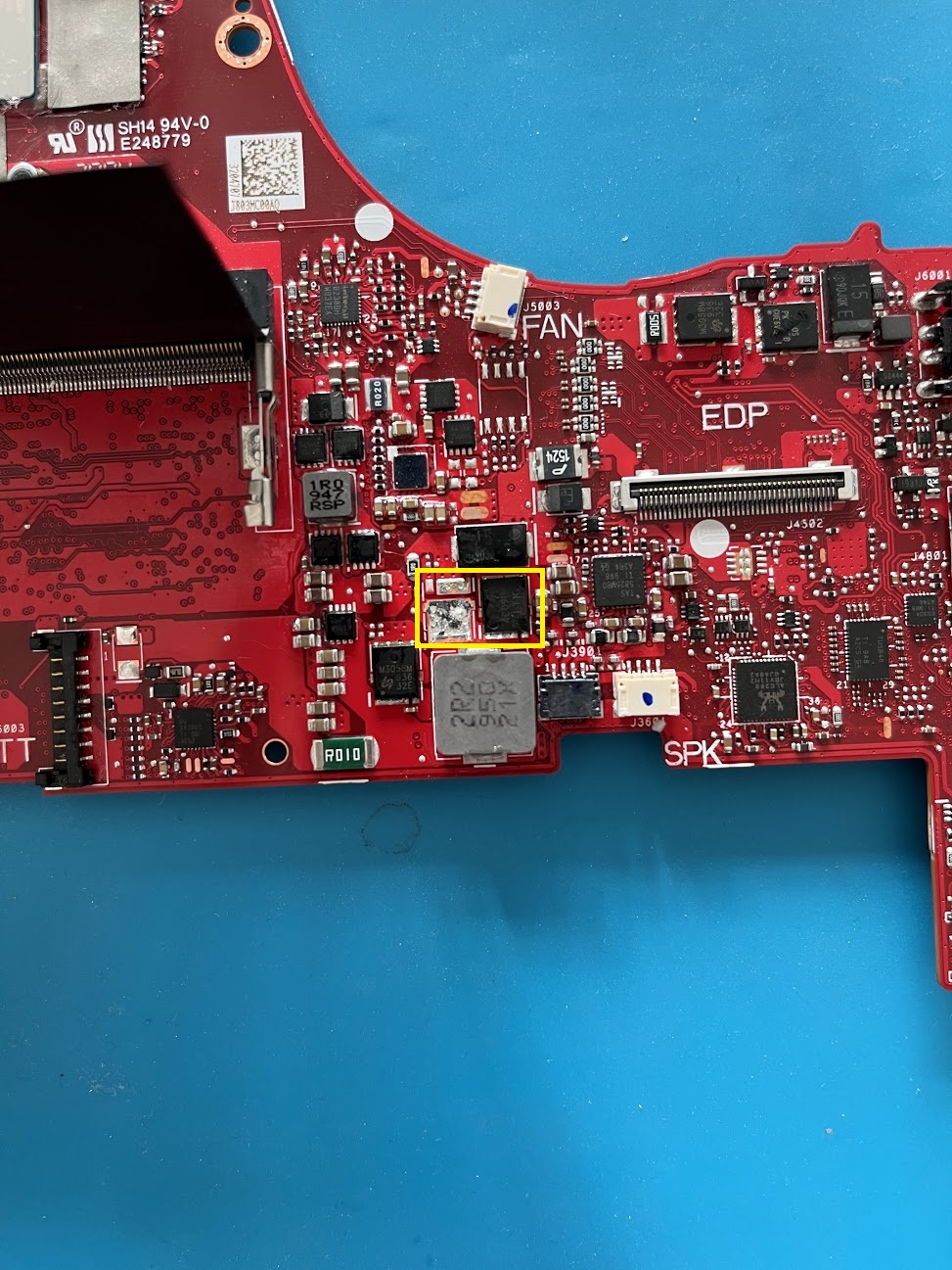

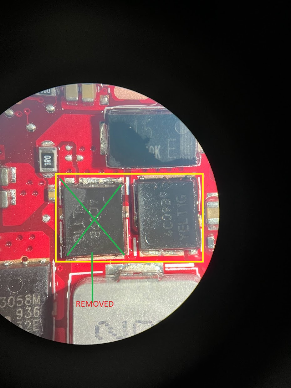

    Alright, I'll get the mosfet removed today, and see if the short is gone.

      Removed the mosfet, and all shorts are now gone
      The mosfet is shorted yes, do I still need to replace all mosfets?

        Re: ASUS ROG G14 (GA401) battery spark, dead.
        The high and low side mosfet for sure and controller bq chip. De

          #84
          Is it due to them having taken damage? It is around 10 mosfets I need to replace then. I resoldered the BQ chip, but I can replace that as well, just more IC's to buy from China I guess...
            No just the one is conected to phase pin are two ones. Not does from cpu . Like on the shematis i sent q51 and q80.
              So just these two?
                Yes those two

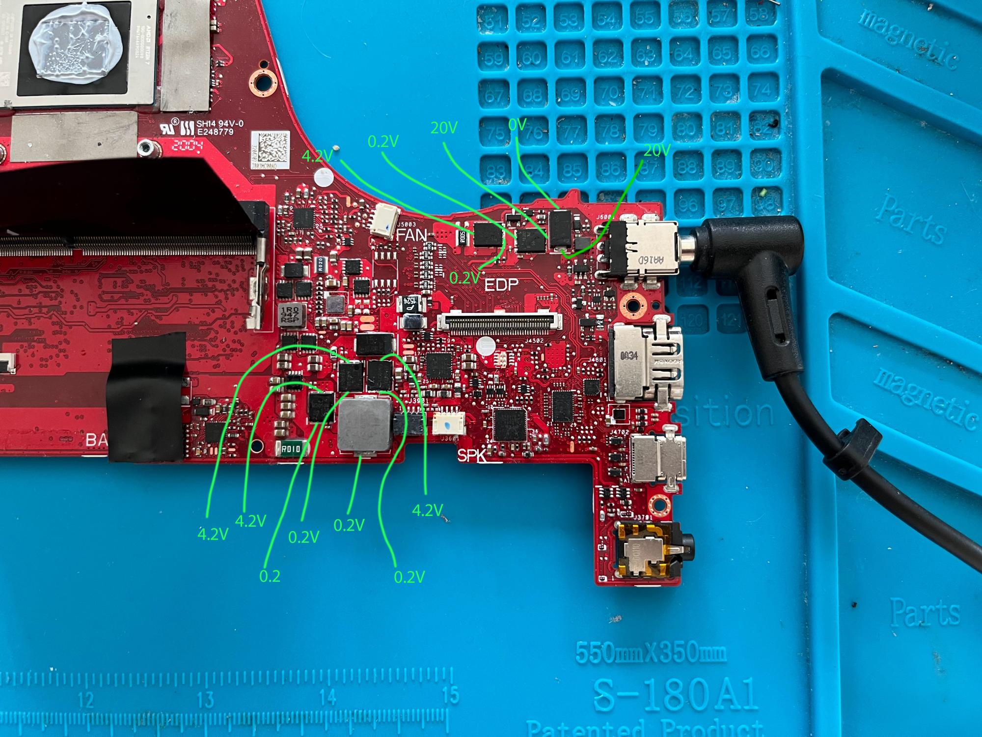

                              UPDATE!
                              Got the mosfets and BQ chip all soldered on, not shorts on the board afterwards.
                              Thought I was good, and assembled everything, plugged in the charger, and now nothing works, no lights, start button does nothing, charging indicator not showing, completely dead, machine wont start and USB charging also does nothing...
                              Double checked connections, and they are fine, disassembled the machine again, and did new measurements, can anyone help again? Still no shorts on board, nothing gets warm when plugged in.
                                Where is the +4v2 coming from (since the front side 2 x mosfets are not turned on) ?
                                Is there a battery connected ? If yes, remove it.
                                  Mystery of the day, no battery is connected, I guess they must be in parallel with the input?
                                  EDIT: The second mosfet at the input outputs 4.2v

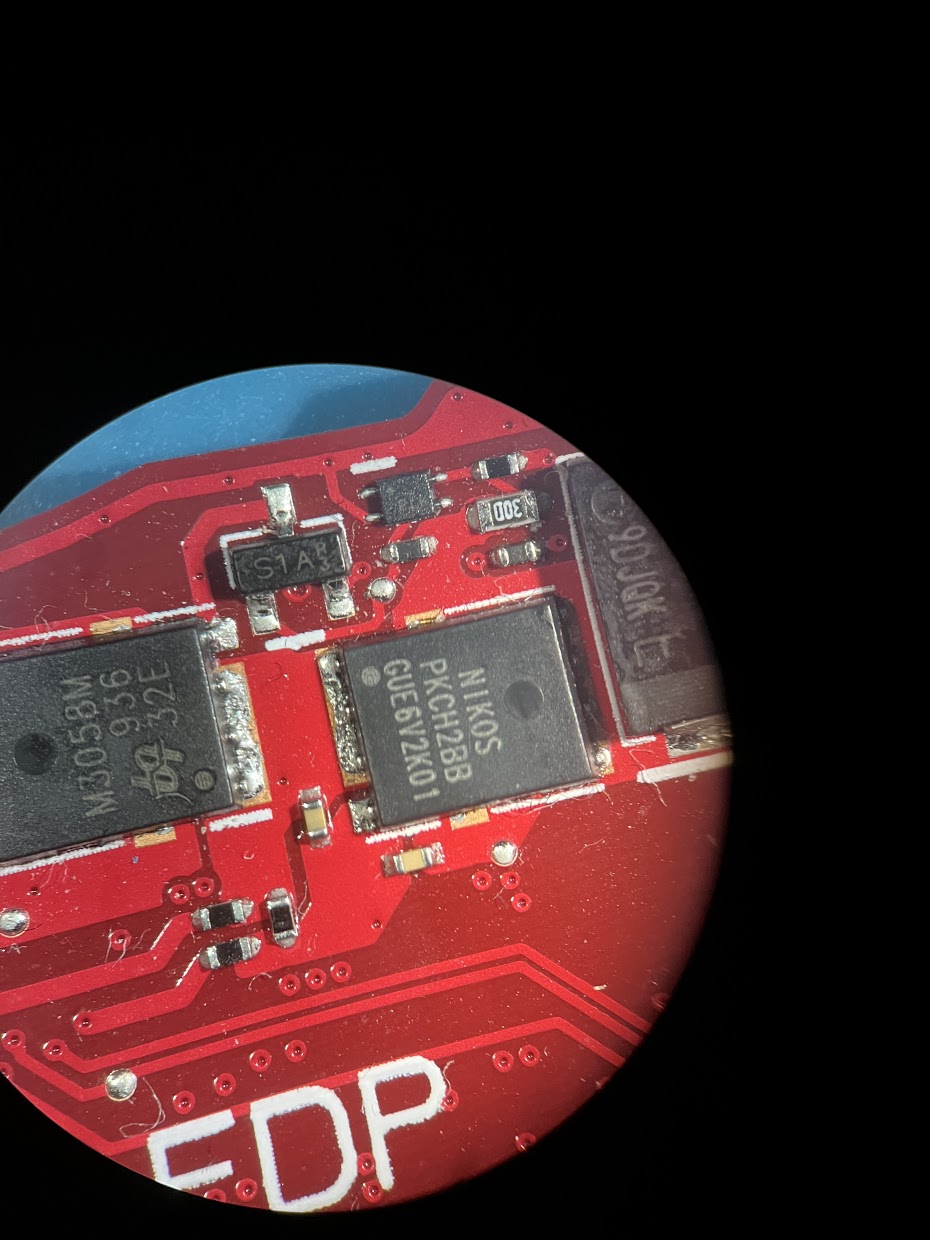

                                        Ok. Then remove all power and check the resistance of the DC IN mosfets.
                                        Meter in resistance mode (2k scale is ok).
                                        Check each mosfet with meter probes across:
                                        Source (1-2-3) & Drain (5-6-7-8)
                                        Source (1-2-3) & gate (4)
                                        Gate (4) & drain (5-6-7-8)
                                        Post each measurement. Repeat for the 2nd mosfet. Checking for a low resistance = defective mosfet.
                                        Also post the markings of each mosfet so we can find their datasheets (or a valid replacement).
                                          Thanks, already purchased replacements for them, as it was easier to get all of them when I was already purchasing the ones at the IC charging area.
                                          The PKCH2BB meassures:
                                          S-D: 2.1 MOhm
                                          S-G: No reading, (not 0 ohm, no reading at all.)
                                          G-D: 5 MOhm
                                          The M3058M meassures:
                                          S-D 3 MOhm
                                          S-G: 4.6 MOhm
                                          G-D: No reading, (not 0 ohm, no reading at all.)
