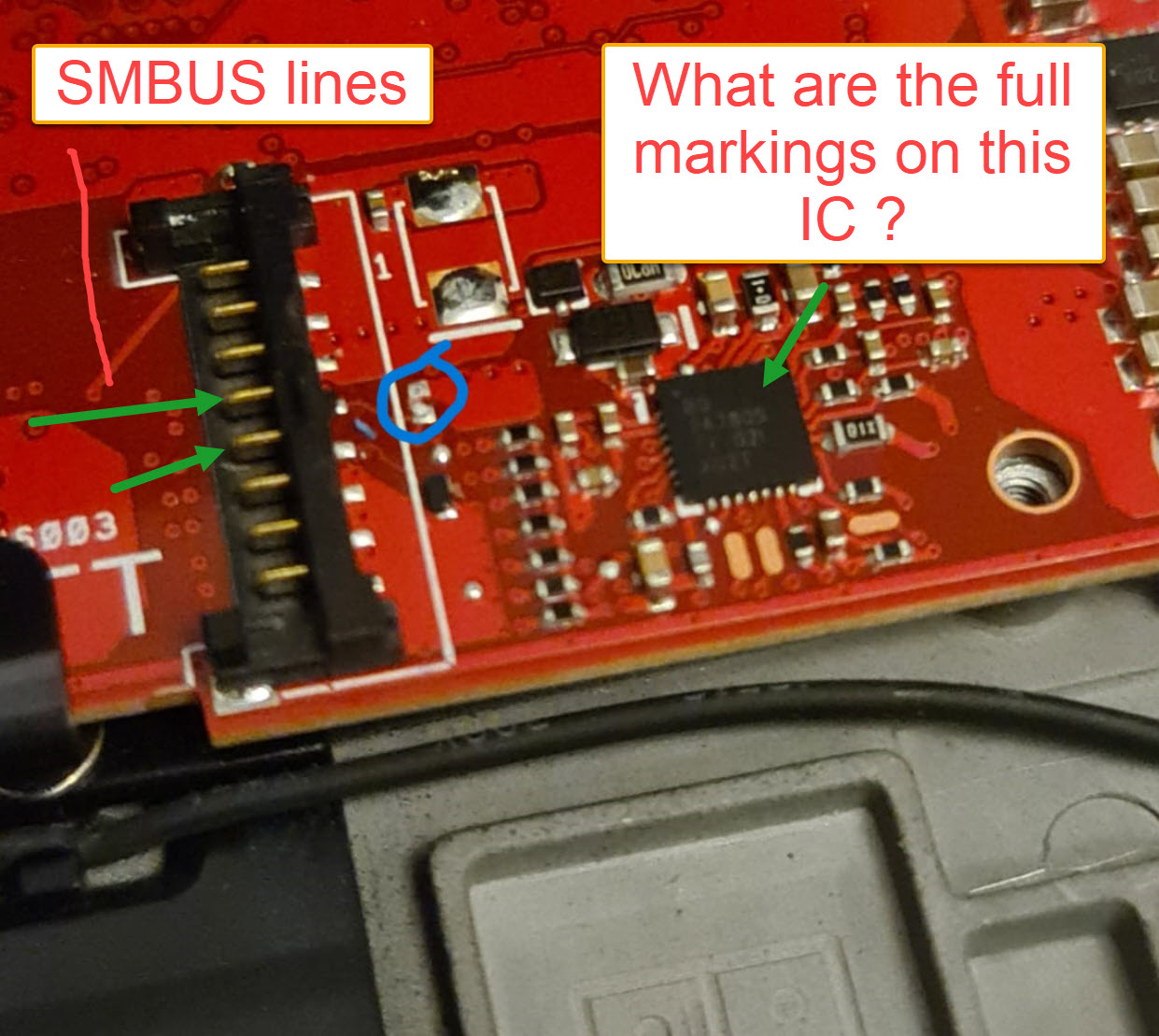

        Hey guys,
        I'm fairly new to this, but before i start checking i have one missing, might it be the reason the battery doesn't charge? the laptop works just fine, with the ac power, i also bought a new battery but no luck. Thanks in advance
        • mon2
          • Dec 2019
          • 14672
          #184
          Re: ASUS ROG G14 (GA401) battery spark, dead.
          No. But be sure the solder between the pads are not shorting to each other.
          Meter in resistance mode. Remove all power.
          One probe on one pad.
          Other meter probe on the other pad.
          What is the reading? It should not be 0 ohms.
          The pin is linked to the smbus lines. You are missing an esd diode like the black part nearby on the battery connector. That is the other smbus line.

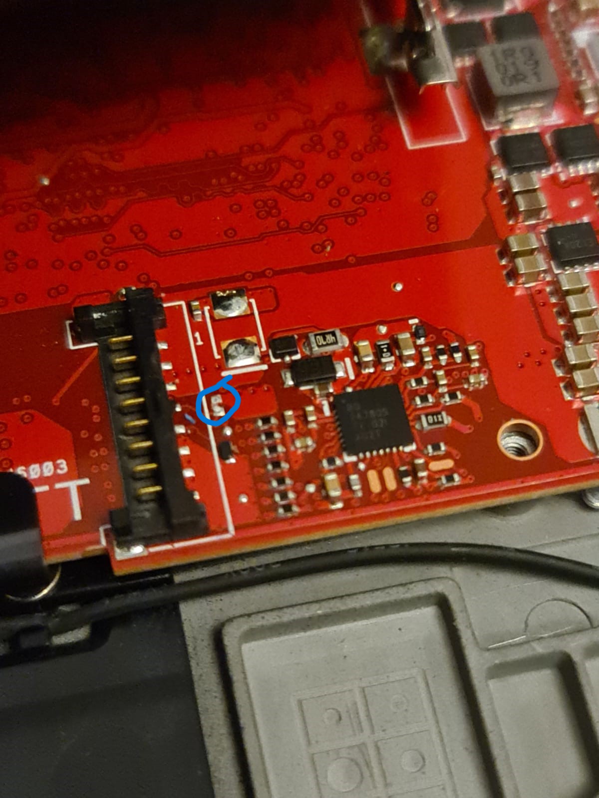

            #185
            thank you for the reply.
            I tested and indeed the reading is not 0 ohms at least. I see no visible damage either, i really don't know where to start
            • mon2
              • Dec 2019
              • 14672
              #186
              One side (the large PCB traces) = ground.
              Other side (the skinny PCB trace to the battery connector) = signal lines.
              We need to check if the skinny traces are at the proper voltage or not.
              There are 2 such lines for the SMBUS interconnect:
              SCL
              SDA
              Each must be not stuck voltages.
              Meter in dc volts scale of 10v or higher is ok.
              Red meter probe on the pad with the skinny trace. Black to ground.
              What is the measurement? Repeat with the other skinny trace that is right beside this one but has the black ESD diode still on the board.
              Each should be ~3v if all is well. You do need to connect the adapter to measure these legs of the circuit.
              Post each measurement.
