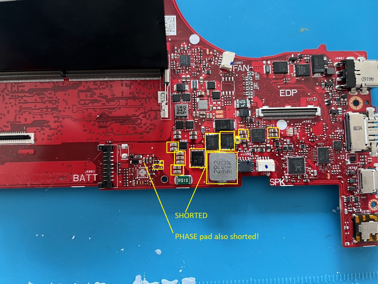

          Removed the charging IC, and phase is still very low resistance, and short is still present on board

                        Mosfets connected to phase pin checked?? All caps near charging ic checked?? If yes, proceed with voltage injection of 1V.

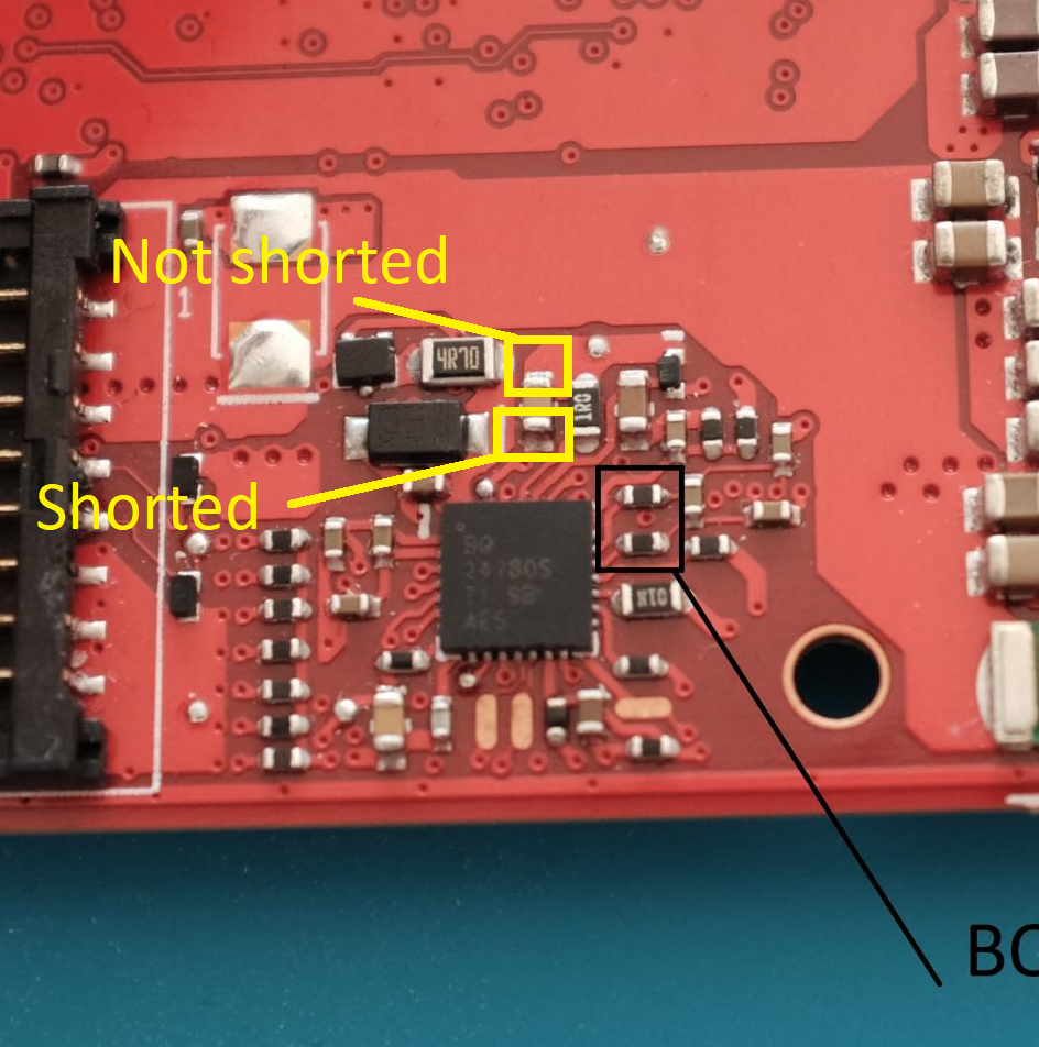

                          Just meassured this morning again, and the cap connected on the phase pin, is only shorted on the side of the pin, not the other side, how does this make sense? I would have thought that the cap would have been shorted on both sides, but it seems like the phase pin is shorted to ground, but not the cap?

                            Checked this caps a while back, the ones that were shorted before removing the charging IC is still shorted. I will check mosfets at charging area when I get home.

                                    Got some new measurements, all mosfets in the area are shorted, so I'm guessing they are fine?

                                      Shorted is not good he. I think It is time to inject voltage i would inject 1v/2a on the capacitors. Do not exceed1v but amperage you can increase.

                                        Does it matter which side of the cap I inject voltage on?

                                          Yes you need to get system side of the capacitor which is not connected to ground.
