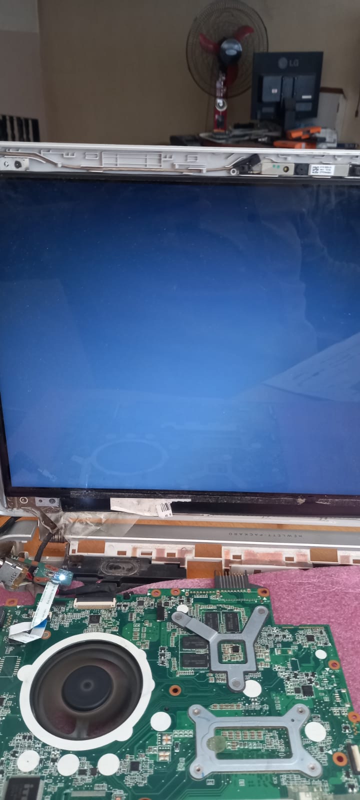

    hp 15-P202ne how to make UMA
    DAY16EMB8C0 REV C
    The problem is that it works, but no data appears on the screen, and I noticed that the screen lighting is working
  • mcplslg123
    • Jun 2015
    • 7262
    • india
    Re: hp 15-P202ne how to make UMA
    Just remove graphics coil.
