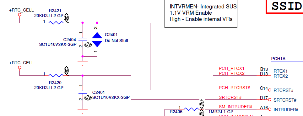

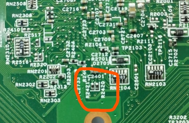

dell N5040 volts on any pin on PWBTN1
  • hamdykl
    • Oct 2021
    • 4
    • egypt
    dv15 cp uma mb 10263-1
    i need a help. i have dell 5040 this laptop working fine when i remove RC battery. but not responding to power batten and no volts on any pin on PWBTN1
  • mcplslg123
    • Jun 2015
    • 7262
    • india
    Re: dell N5040 volts on any pin on PWBTN1
    Check RTCRST# and SRTCRST# voltage. No power should be attached to mb(adapter+battery removed), only 3V cmos cell inserted.
    • hamdykl
      • Oct 2021
      • 4
      • egypt
      i did it and there are 3V on R2421 & R2420 (only RTC battery)
