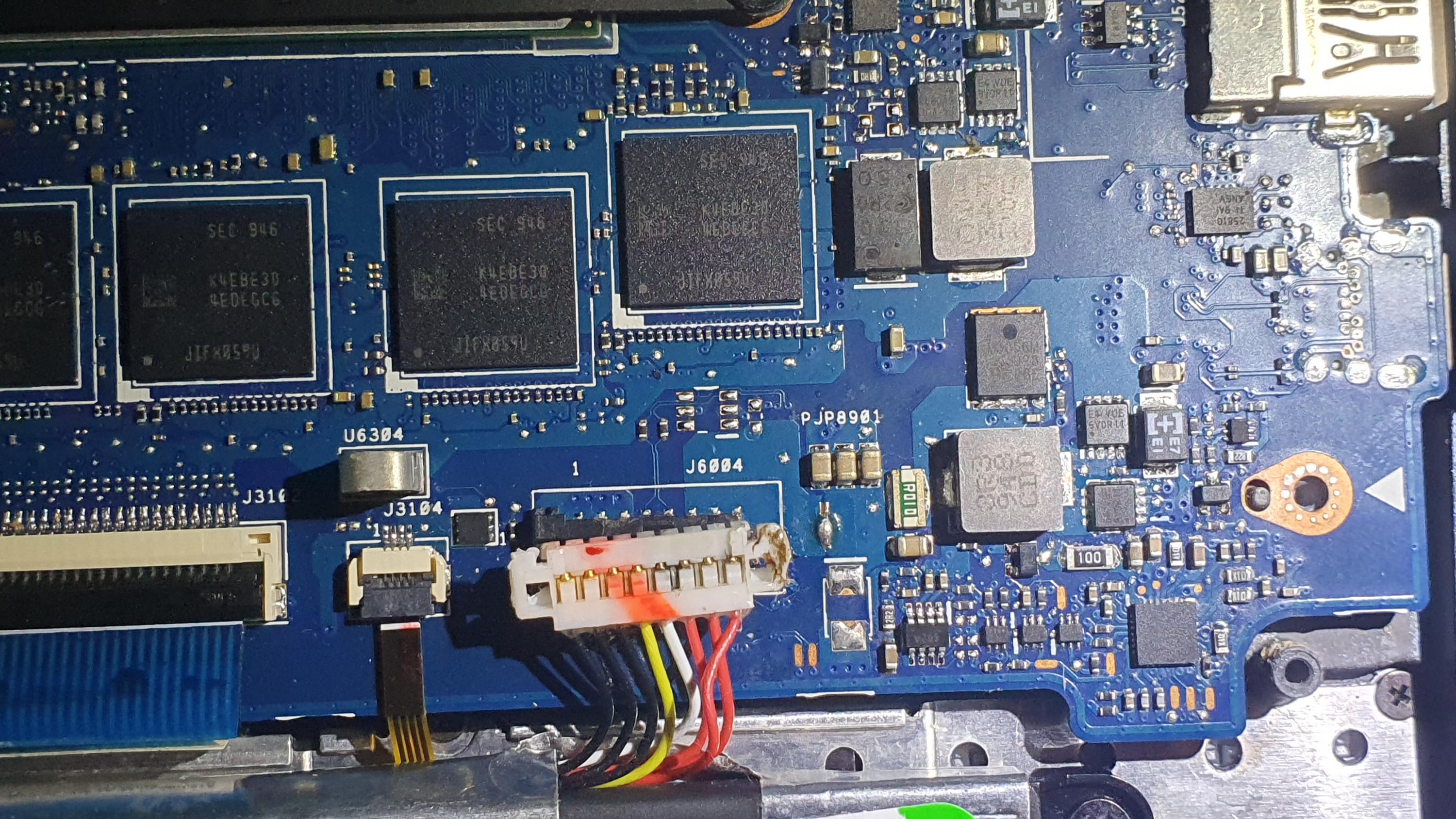

    Hello, the laptop has a resistor cdamaged by water and dead (open line) close the charging chip. I will replace it soon.
    I found a lot of thermal paste on coils and componets close CPU.
    With meter, I saw 2,6 Ohms between ground and shunt resistor close power jack. So I guess it's too low.
    I don't find true short (0 Ohms) on the board, no coil shorted.
    I don't found bad mosfet (shorted drain-source). I found 2,6 Ohms to the « output » of the second mosfet close power jack.
    I found a coil (close CPU) at 2,6 Ohms.
    I measured between the output of 2sd mosfet (2,6 Ohms) and the CPU coil (2,6 Ohms), and I found 0 Ohms. So I guess something is shorted on this line. Right ?

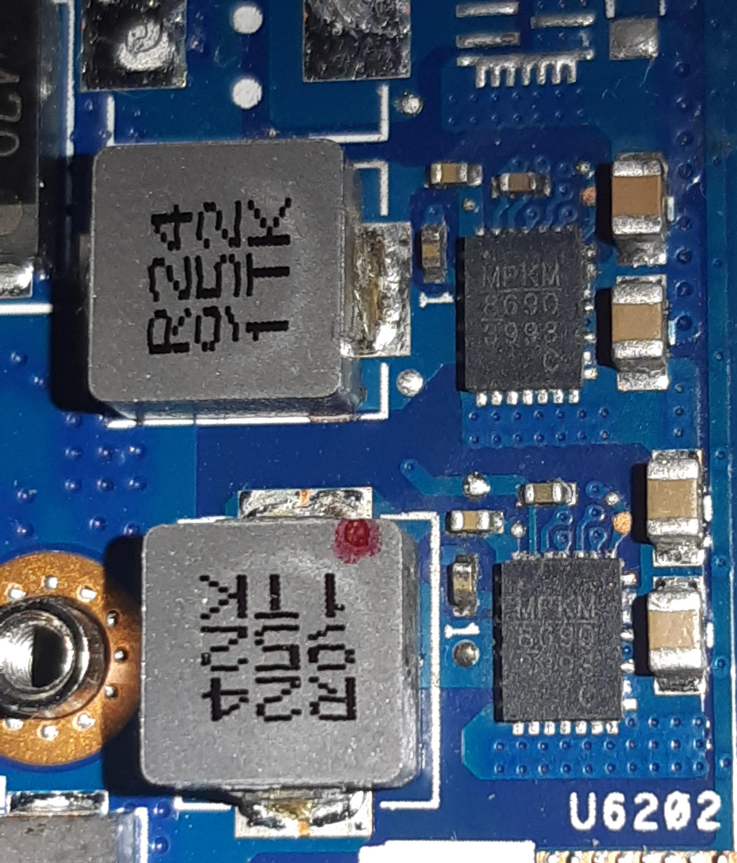

    I found a second coil close CPU at 2,6 Ohms
    To summarize, the output for 2sd mosfet (high side, close power jack) is directly linked (biping, 0 Ohms) to 2 CPU coils. So 19v rail is directly linked to CPU. I guess there is an issue on this line. Right ?
    To put it another way ; this output of 2sd high side mosfet is 2,6 Ohms to ground. I guess it’s the CPU internal resistance.
    I guess something in this line is dead. Right or not pls ?
    On this line, there is these 2 CPU coils so, associated to 2 MP86905. I don’t understand what is it ? Buck convertor or regulator ? I don’t thinks the twice are dead. But I don’t know how to test them. Measures compared seem to be the same.
    Whar else ? Do you see wich component could be dead on this line pls ?

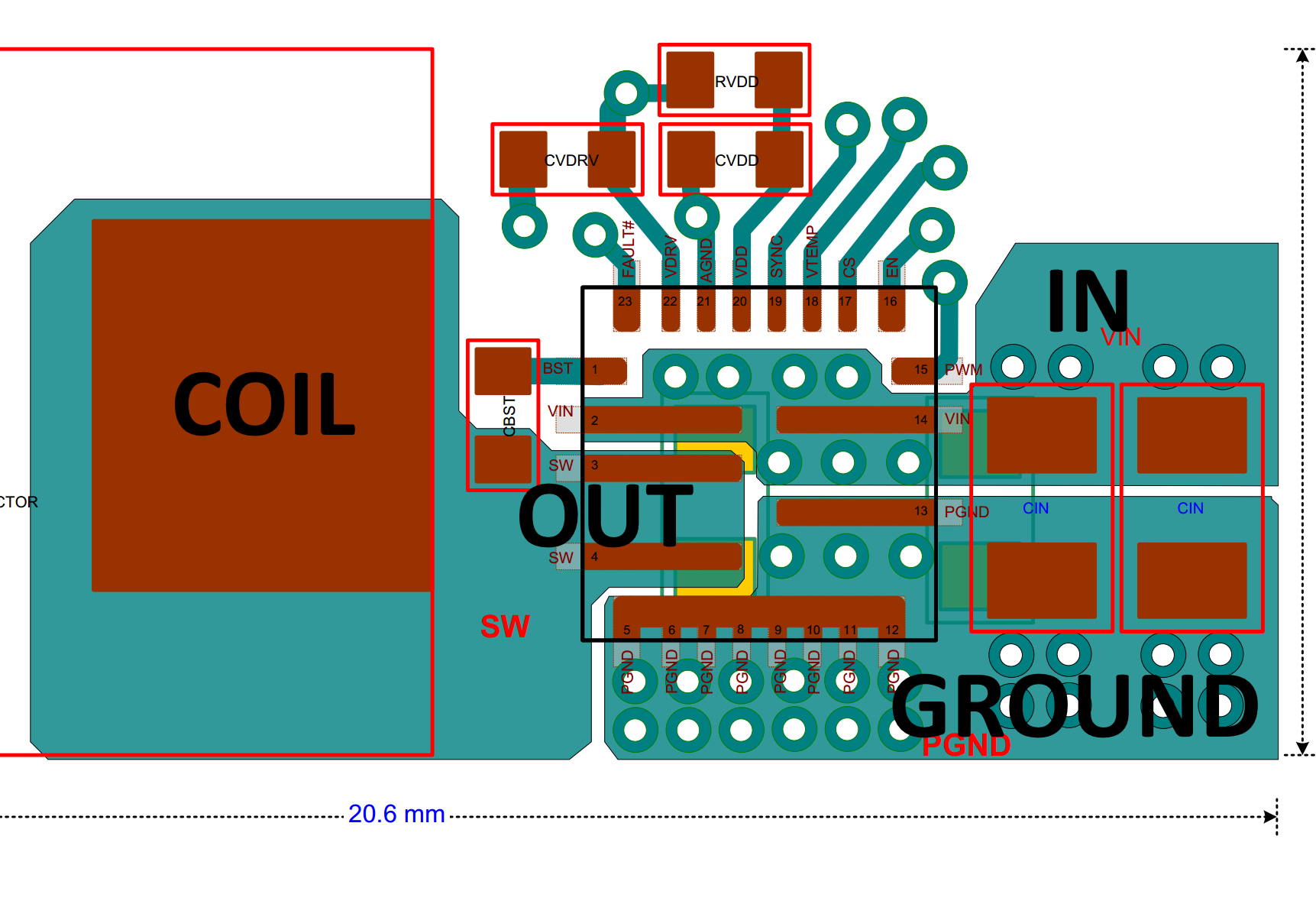

      According to datasheet (in attachment) of MP8690, there is a « IN » and « OUT » (see schematic, and photo below, components are at the same place). I measured between in and out : 0 Ohms, for the 2 chips close CPU.
      I found 2 other same chips on the board (same configuration, close coils) and there is a resistance between in and out.
      So, something is fautly for the 2 chips close CPU.
      But I can't believe the 2 chips are dead, with the same issue. I wonder if another component could be faulty and has effect on these 2 chips ? Any idéa pls ?

        I surmise you are saying you have 2 ohms to ground on the +19V rail? You indicate the driver for the CPU buck converter is also shorted.
        Liquid usually interferes with the feedback and/or the PWM for the converter resulting in MOSFET destruction, and the CPU/PCH/GPU cops the full rail (at least till protection kicks in). Its usually fatal but I have seen some designs survive this if the protection mode of the power supply is quick enough, but that is rare.
        Both drivers being shorted isn't unusual BTW with liquid damage if the source of the PWM is what was affected.

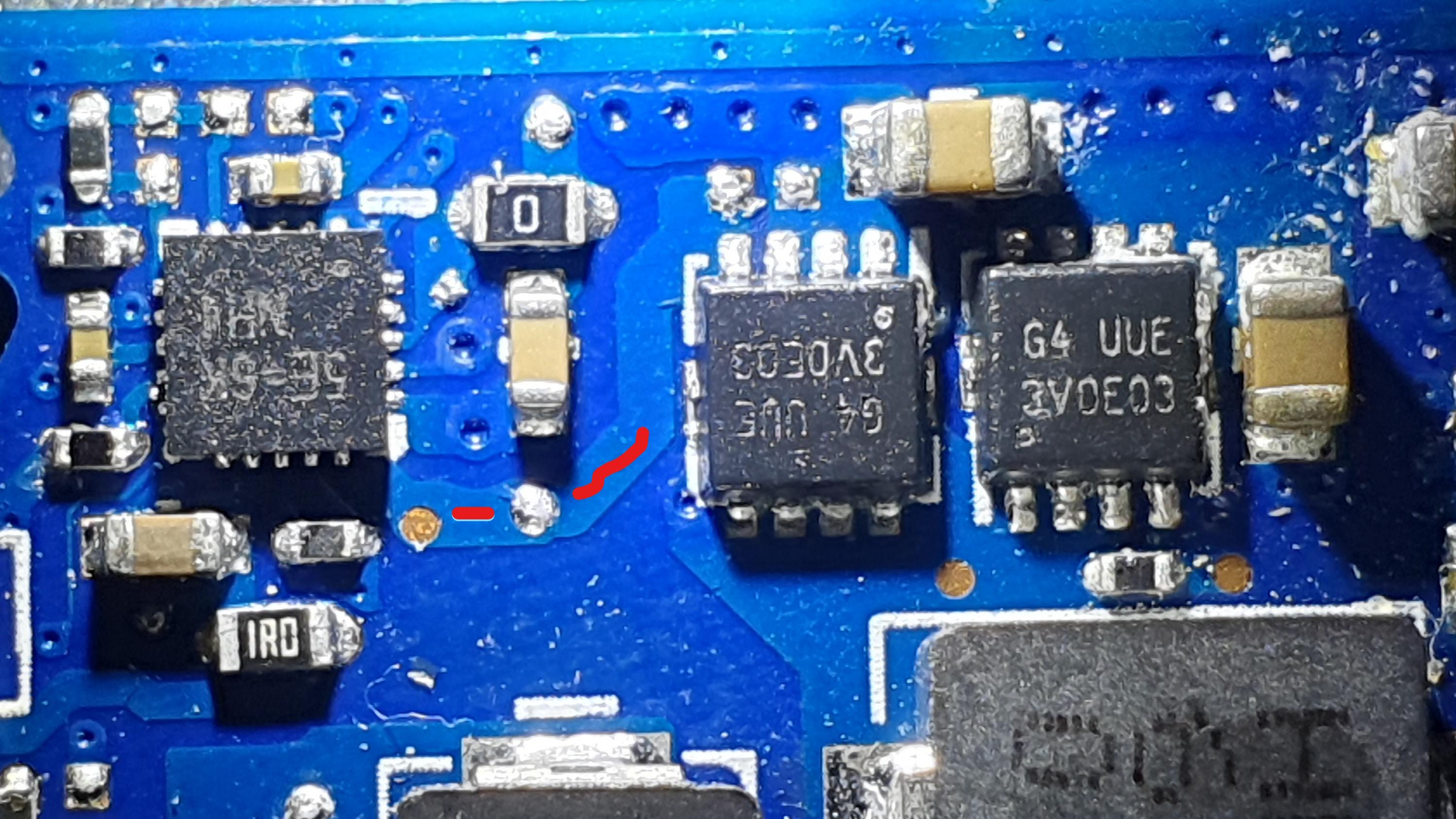

            I desoldered the 2 chips and ok, the little « short » (2,6 Ohms) is gone. So, this part is solved.
            Now, I measure 127 Ohms between ground and the out of 2sd high side mosfet (in place of 2,6 Ohms before I remove 2 chips). I guess it’s too low.
            Probably one mosfet (or the twice) is dead. But I can’t understand what I read on the meter.
            In resistance mode, between drain-source : 60 KOhms (1st mosfet) and 3,5 MOhms (for the 2sd)
            So, my first think was the two mosfet have an issue (leak)
            But in diode mode (not the beep mode) : I measure 0,5v in a direction, and after inverting the probes : 3v for the 1st) and (3v for the 2sd).
            So, 0,5v seems indicate the junctions are goods ? And finally, I don’t know how to measure the mosfet onboard.
            I need help pls ?

                Update : (for the previous issue, see the post of reformatt above).
                I replaced the dead dual mosfet close the CPU, the short on main power rail is gone but le laptop don't start (maybe another issue)…
                When I plug the charger, I have now LED light on power on button (blinking slowly 3s, maybe that indicate standby/sleep state ?) And when I press the button, nothing obvious happen (maybe a little change on blinking led but not sure). The LED keep blinking.
                Battery charging, the battery LED blinking when the battery is unplugged, and stop blinking when it is plugged. So the charging chip seems working but I have doubt because a voltage (HIDRV seems to high, see below) and because there was oxydation close and component linked to, destroyed by oxydation.
                On another coils, I measured 3,43v and 5v, so the 3.3v and 5v are presents. (Maybe 3.43v is too high ?)
                I don't know what to diagnose after ? If the charging chip is ok, that could be a super IO issue. Any idea pls ? I have schematics but no boardview.

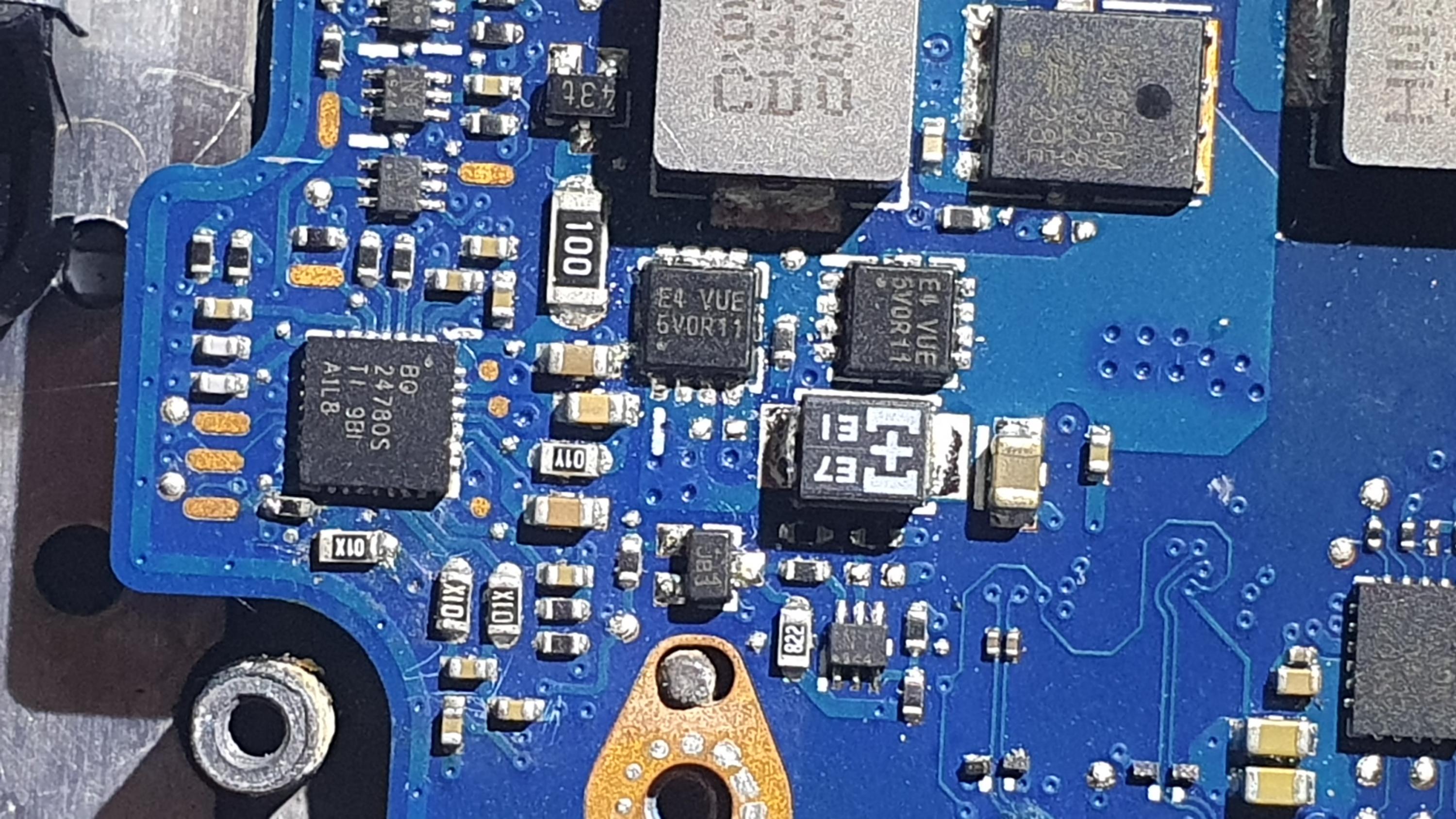

                      I checked new, PROCHOT and TBSTAT are « blinking » with start of blink synchronized with power LED.
                      I noticed TBSTAT is linked with the resistor in oxydation damaged zone.
                      The twice seems output signals generated and sent by the charging chip (according datasheet above), can I deduce the chip is dead ? Thanks to give your advice pls, it's a big job for me to replace a qfn-28.

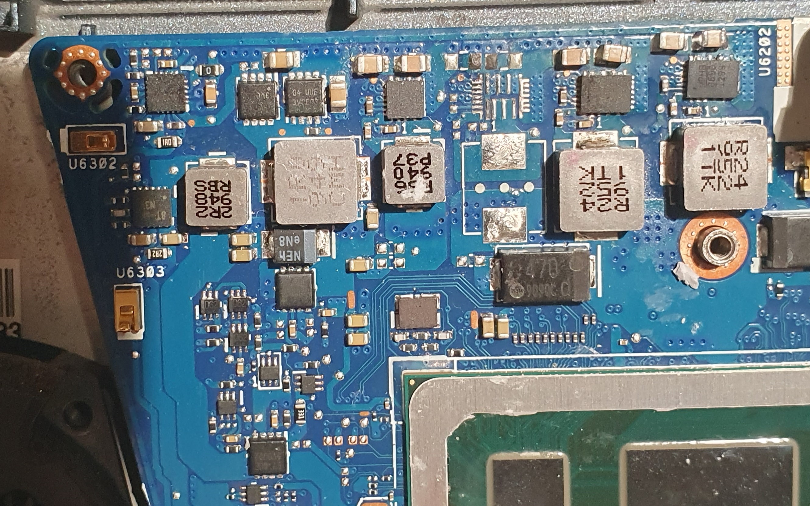

                            I checked the voltage coils present
                            CHARGER PLUGGED ONLY (NO BATTERY)
                            3.3v
                            5v
                            1.83 probably +1.8VSUS
                            1.06 probably +1.05VSUS OR/AND +VCCSA ? (above PCH)
                            battery coil : 0.17v (and 16.29v when only battery plugged, for 15v battery)
                            All other 0v
                            I checked the RAM power chip ; almost all voltages at pins are blinking and it don't provide 1.2v

                                  I'm focused on something weird : there is a chip 5E= a step down controller at up-left on picture. This chip is usualy for power supply Ram memory but I guess not in this case. It close the chipset, and provide (via 2 mosfet) the second coil (up, left of the board on the picture) mesured at 1.06v stable.
                                  The LGATE (track in red on picture) of this chip is unstable and blinking between 0.7v-2.5v, the UGATE too but in a little range of 0.03v.
                                  It's weird because LGATE is an output and there is no other pin of this chip whith voltage unstable or blinking. How it is possible ?
                                  Logically, if all inputs voltages are stables and the output voltage is unstable, the chip could have an issue ?
                                  How can I check ?
                                  The mosfet is good : it has resistor in MOhms gate-GND, gate-drain and gate-source.

                                    Don't touch unrelated circuits, very likely to kill PCH if you mess with the buck converter for its core voltage.

                                      I'm searching the cause of boot loop with measurments :
                                      The PSU consomption : 10 – 100mA
                                      I plugged an USB key and when the LED flashing very briefly, the boot loop restart instantly.
                                      The 5 coils above chipset/CPU :
                                      1 coil : 1.8v : stable
                                      1 coil : 1.06v stable
                                      1 coil : 0 to low voltage, but unstable
                                      2 coils Vcore : 0v (don't try to start)
                                      At coils of 3.3v 5v chip :
                                      1 coil : 3.42v (stable)
                                      1 coil : 5.18v (stable)
                                      At coil of ram memory :
                                      1 coil : 0 - 1.4v (unstable)
                                      Battery coil : 0.2v (battery unplugged) but charge when battery plugged)
                                      I measured some power good voltages but hard to find without boardview :
                                      (with boot order number, see the last page of schematics, link above in this thread)
                                      9 - 1.8VSUS_PWRGD : 3.3v stable
                                      10 - 1.0VSUS_PWRGD : 3.19-3.22 unstable
                                      15 - PWR_SW# : 3.25v stable (should be 3.3v ?)
                                      22 - ALL_SYSTEM_PWRGD : 0 to 2.22v unstable (boot loop)
                                      23 - IMVP8_PWRGD : 0v (need +VCCCORE)
                                      What is it possible to deduce pls ? Super IO and PCH are good because they talk to each other ?
                                      The boot sequence stop when the CPU is requested ? It don't respond (because it is not powered) ?
                                      3.25v stable (PWR_SW#) is it too low at power button ?
                                      • corrize
                                        • Apr 2021
                                        • 271
                                        • France
                                        Re: Asus Zenbook DUO UX481F – small water damage and thermal paste
                                        Update : indeed, VCC core was missing, I found a bad solder on CPU mosfets. Now, solder is good, I checked on all pins.
                                        New test : when I plug the charger (without battery), the chargin LED goes on, and next power LED on, it goes off after a few seconds.
                                        I measured VCC core at coil, It grow up very briefly like all other coils voltages (pulse) at 0.8v, and goes to 0v. (So VCC core is « present » now, it was missing before).
                                        So all other voltage, even the dedicated GPU have a same pulse (start to start).
                                        At PSU : when I plug the charger : the voltage goes at 400mV two time (pulse) and 0v.
                                        I measured IMVP8_PWRGD : there is now a pulse 1.7v (not present previously). But should be 3v and not 1.7v ?
                                        So, yes, the CPU could be dead. But not shorted (3,6 Omhs, for I7-10510U). What can I measure now for confirm the CPU is dead pls ?
