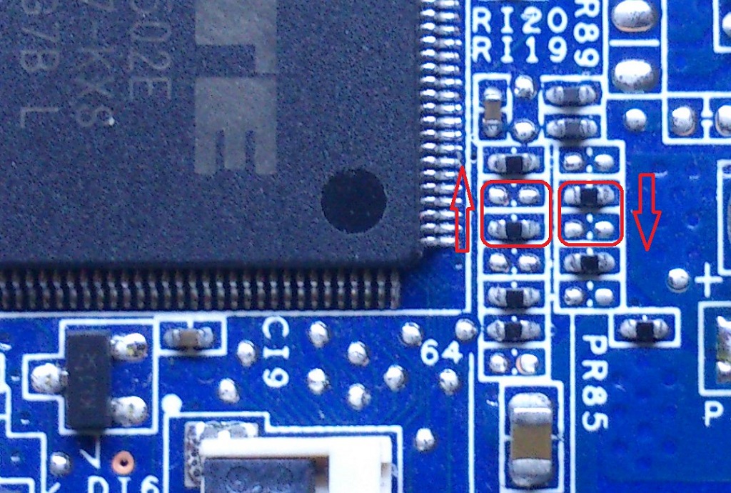

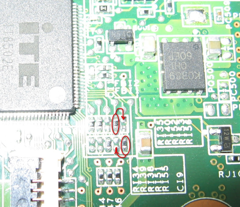

    hello gurus in the community,i need someone to explain what an what do i need to add or remove from the hp g62-a19sa board.i have detected that the ATi chip set fail all the time,all required voltage are present .here attached the schmatic for the board.thanks

    If you check page 33 where the Kbc ite8582 is. I don't know which resistor to swap or which one to remove. My mentor mcpslig123,lapfix,mons and Co where are you.

          The schematic and post your redirect me to does not match the G62 board am working one.
            Re: HP G62 conversion problem
            As per the schematic attached, SIO is on page22 and its IT8502 and not IT8582. I've attached 2 pics. Atleast one pic should match your mb. Do changes as per the pic which matches ur board. I've not done conversion on this mb ,so cant guarantee about its authenticity. The link given by @speggio91 is for Quanta AX1 and its completely different. However, that guide is tested by me personally to be working.
