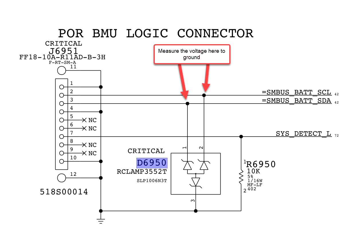

    this macbook had had liquid damage, i replaced trackpad connector, i also changed efi chip, battery was dead and put in a new one. Today I connected the battery without fixing with double sided tape, I switched it on and everything went smoothly. Before turning off I deactivated autoboot with a command from the terminal. I turned off, I unplugged the battery, I reconnected everything and now it does not turn on anymore. When I connect the charger it has a normal current draw and 20v, the symbol of the charged battery appears for a moment and then nothing, dead. It does the same thing if I close and reopen the lid, for a moment just the battery symbol.
    What can I do? all this is very strange .....

    D6950 - measure the voltage on this component.
    Post the readings of pin #1 to ground; pin # 2 to ground.

      Pin 1 0,40 - 3,4 v
      Pin 2 0,40 - 3,4 v

        solved, I bought a bios chip already programmed, it worked for a day, I got one from another logic board and now everything works !!
        I don't know if the terminal command "sudo nvram AutoBoot =% 00"
        may have created some problem with the bios chip.

          With Intel machines, you can't swap a EFI chip without first cleaning the ME region. Dirrty ME usually results in a slow boot, weird fan speeds etc.
