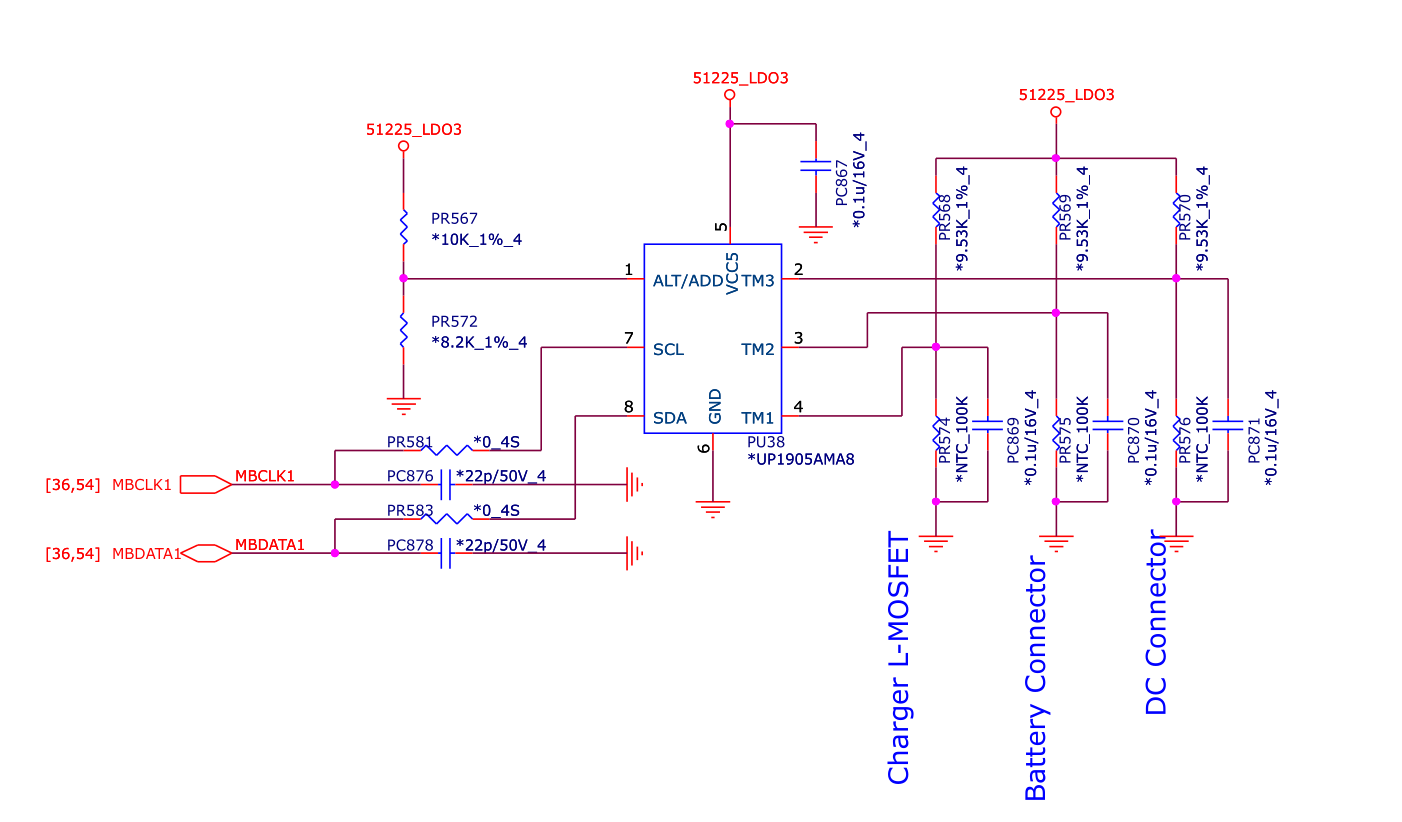

      The battery is defective as this pin should not be 0 ohms when connected to the logic board.
      This P_CLK pin is a signal that is used for communication with the logic board to share the battery properties, charge level, etc. Without this signal, the communication cannot proceed.
      Suggest to source another battery and test again.

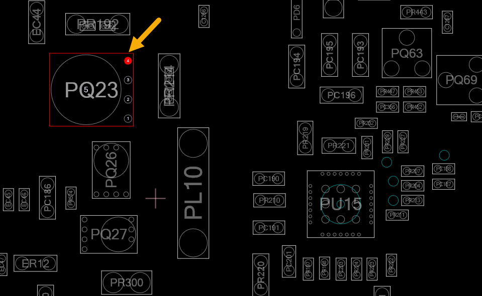

                Remove PQ23 (battery mosfet) and test again.

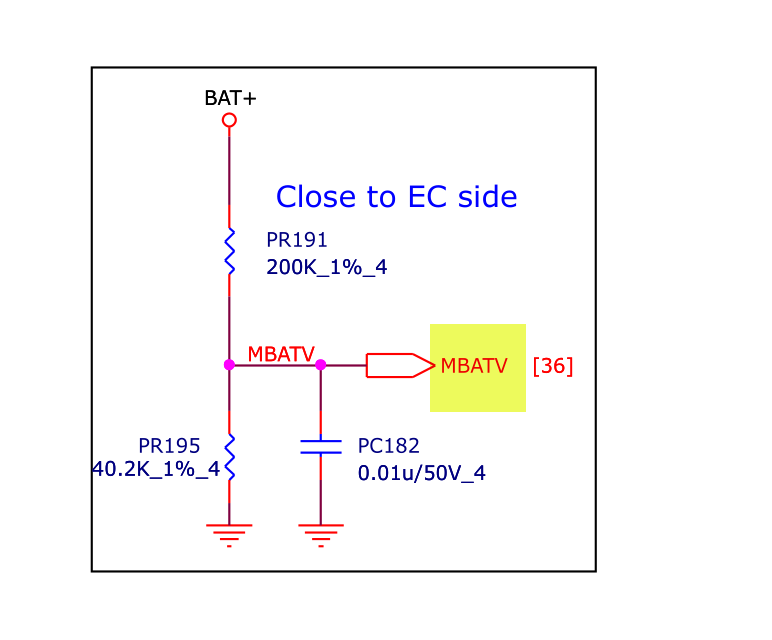

                    What is the voltage of MBATV ?
                    Check if the attached thermal sensing parts are stuffed on your logic board.

                      I don't think it is charging, voltage of battery is still the same - 11,52 V. With adapter or without.
                      MBATV is 2,15 V.

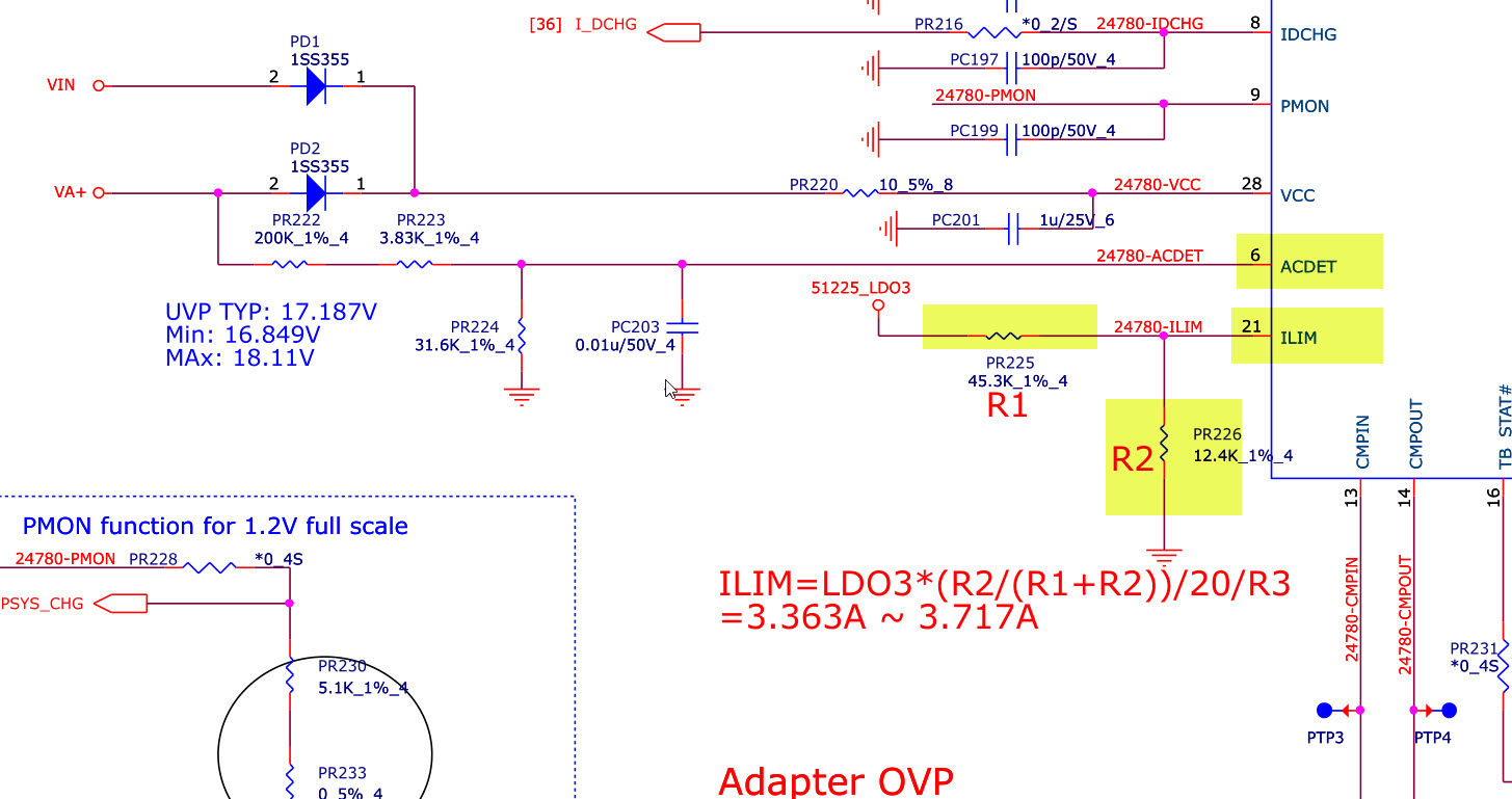

                        1) check the voltages on ILIM (pin # 21) and ACDET (pin # 6) with the battery and charger attached. Still leave the battery mosfet (PQ23) off the logic board.
                        2) remove all power -> meter in resistance mode -> check the resistance values of the resistors @ ILIM (pin # 21). Do the resistor values match the schematic values ?

                          This board does not have PU38 and its components fitted.
                          ACDET is 2,66 V, ILIM = 0,71 V. without power it has resistance of 11,9k ohms.
                          PR225 should be 45k, measures 35k (on the board, so it looks fine), PR226 measures 12k.

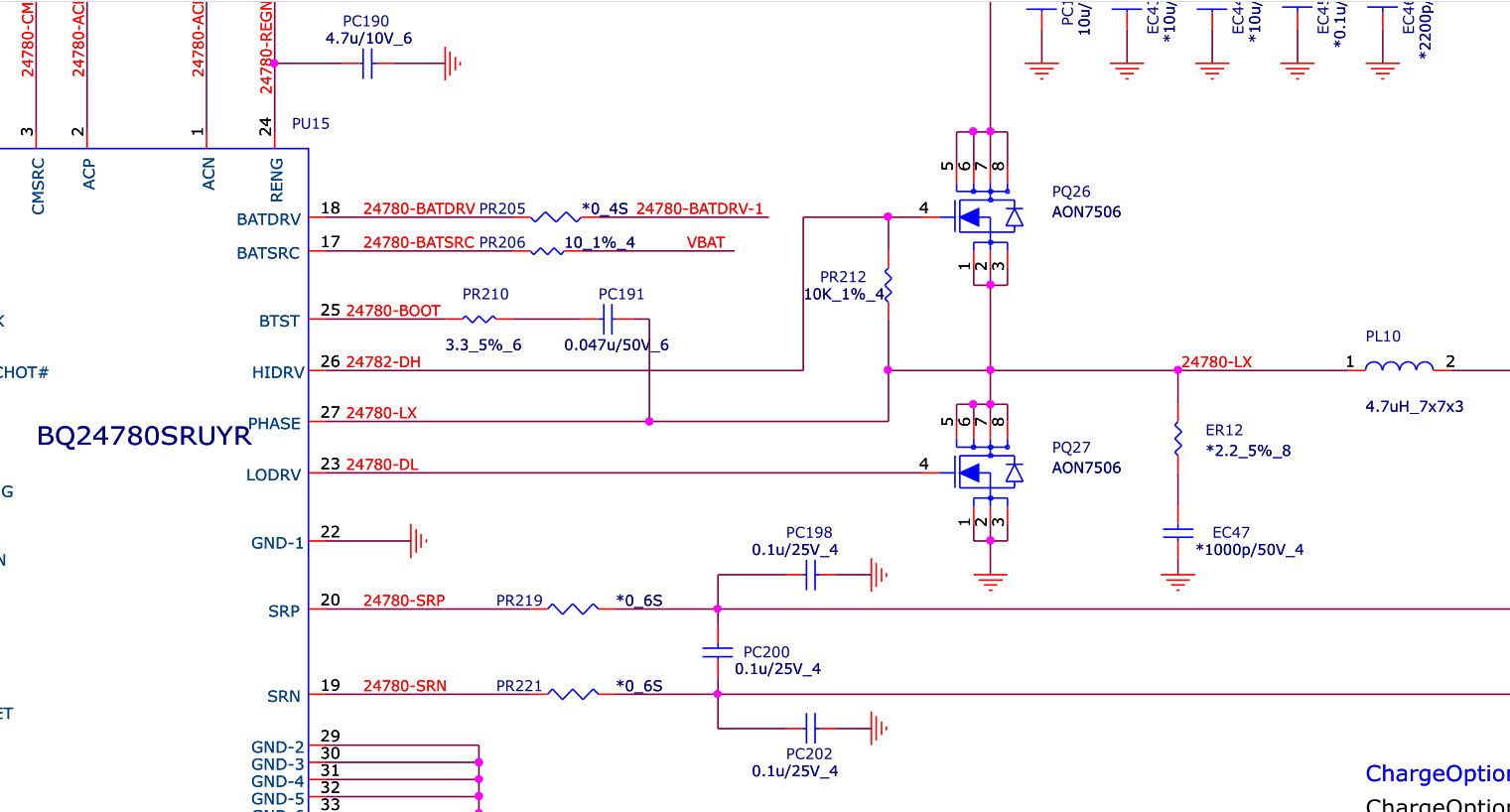

                          PQ26:
                          S-D starts at 50k, goes up for 2M.
                          S-G 9,3k
                          G-D 3,75k
                          PQ27:
                          S-D starts at 15k, goes up for 150k
                          S-G 200k
                          G-D 200k
                          BTW thanks for your help. You're amazing!

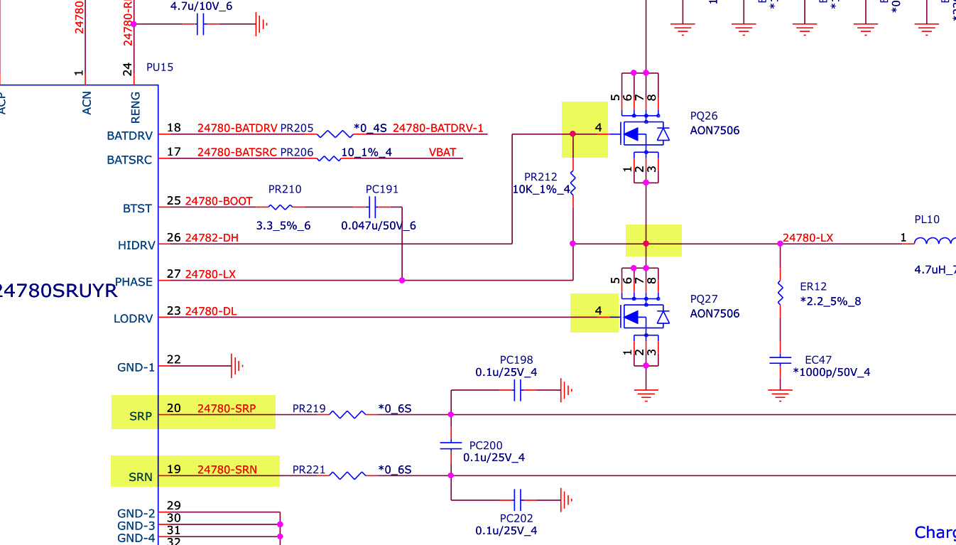

                            PQ26 mosfet resistance looks low.

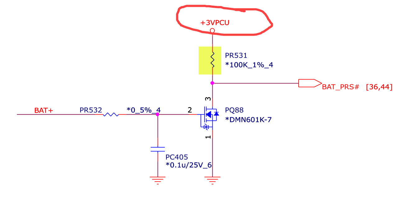

                            What is the voltage of BATPRES# pin 15 ?

                              BATPRES is 0V with or without the battery.

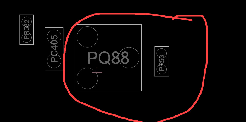

                                BATPRES# will be ok with 0v but see attached.
                                Locate the small mosfet on BAT_PRS# line.
                                Do you have this circuit stuffed on your logic board ?
                                WITHOUT the battery, the mosfet (PQ88) should be OPEN. If PQ88 is open, PR531 will pull-up this line to ~3v. Review if you have PR531 onboard and also measure the +3VPCU rail. It should be present.
                                1) Post the voltages on each pin of the HIGH and also the LOW side charging mosfets (PQ26 & PQ27).
                                Source (1-2-3)
                                Gate (4)
                                Drain (5-6-7-8)
                                Also measure the voltage @ pin # 4 (GATE) of the missing mosfet @ PQ23 (battery mosfet).
                                2) Also need the voltage readings of the pins # 19 & 20 on the charger IC.
                                Voltage on ACOK pin # 5 of the charger IC ?
                                Voltage on ACDET pin # 6 of the charger IC ?
                                Do connect the battery during the above testing.

                                  Mosfet and its components are not installed. +3VPCU - 3,3 V
                                  Battery installed, ASUS charger plugged in:
                                  PQ26:
                                  S - 11,44 V (same as battery voltage)
                                  D - 19,34 V
                                  G - 11,44V
                                  PQ27:
                                  S - GND
                                  D - 11,44 V
                                  G - 0 V
                                  PQ23:
                                  G - 11,44 V
                                  PU15:
                                  SRN - 11,44 V
                                  SRP - 11,44 V
                                  ACOK - 3,25 V
                                  ACDET - 2,67 V
                                  BTW where did you get the schematic? I only have boardview
