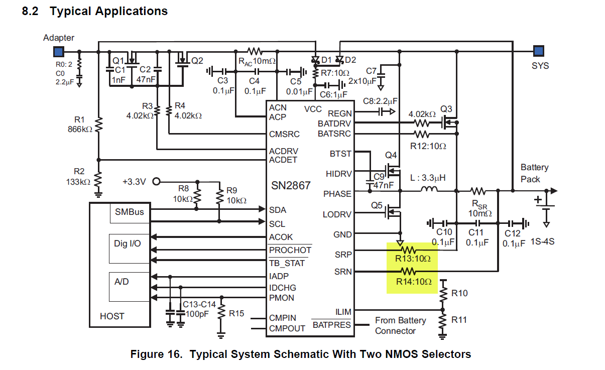

              Re: Asus FX504 not charging battery
              On boardview are two resistors - PR219 and 221, and the line goes trought them. My board doesn't have pads for them. Lines go right under the PR214 (which is 010R). Resistance between SRN and SRP is 0,3 ohm. In diode mode they both measure 532 mV
                Be sure to measure the resistance from the actual charger IC pin to the current sense resistor.
                Then repeat for the other charger pin to the other side of the current sense resistor.
                This is important as we have seen a case on this forum - took about 3 weeks to fix - where the trace was broken between one leg of the current sense resistor to the charger IC.
                Due to this fault, the charger IC is unable to gauge the current draw of the battery charge circuit and will shut down the process.
                  If I understand correctly, I should measure on PU15 (bq24780s) pin 19-20 and 1-2?
                  On ACN-ACP I measure 0,6 ohm and SRN-SRP 0,3 ohm at the chip.

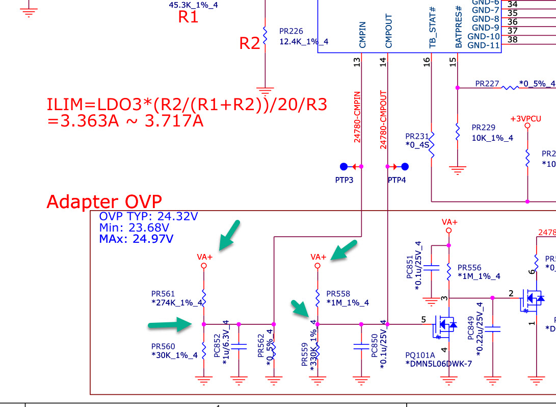

                    See attached. Is it the same as yours ?
                    (lost a post here...confirm that VA+ = DC adapter input voltage).
                    Then check the voltage dividers again @ pins 13 & 14.
                    Q: Is PR562 stuffed on your logic board ? If yes, remove all power and measure the resistance. If this part is ~0 ohms then pin 13 is ok @ ~0v.
                    The voltages you have measured are not correct IF the external adapter was connected.
                    See my concerns.
                      I will check VA+ tommorow, but I think it is.
                      No, PR562 is not fitted. Everything in that area, that connects to pins 13 and 14 is not fitted on my board.
