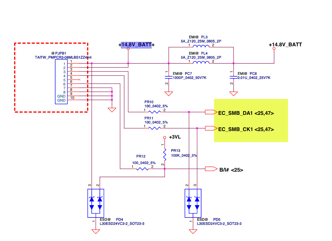

    Hi.
    Does the laptop work with the adapter ?
    You can boot normally into Windows if the battery is removed ?
    See attached.
    Measure the voltage of EC_SMB_DA1 & EC_SMB_CK1.
    Post the measured voltage on these 2 pins.

      thanks for replay
      yes laptop work with the adaptor ok no problem
      ec_smb_da1 = 3.3
      ec_smb_ck1 =3.3
      but pin 1 and 2 are 3.3v too

        Re: hp ahl50 abl52 la-c701p no charging
        The SMBUS lines look ok at this time.
        Have you tested with another battery? Could this battery be old and now defective?
