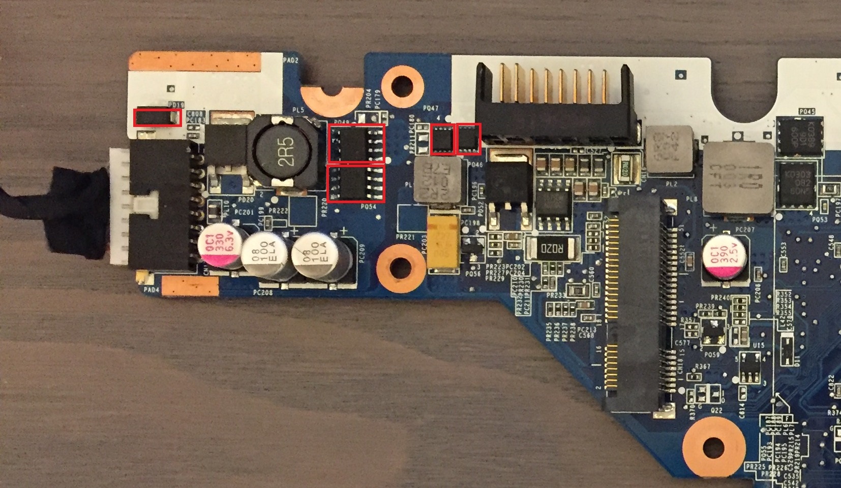

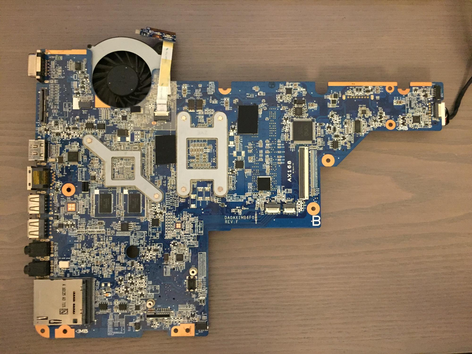

    Hi everybody, recently I bought for cheap an HP laptop (model HP G62-100SL) to make practice in repairing, just for hobby.
    I want to stress, the fact that I'm a newbie to electronic repairing.
    As I suspected the problem was simply a GPU that needed a reflow/reballing so nothing interesting. After the reflow the pc started to operate normally again.
    There was just a problem, using a DELL 65w AC adapter, the battery charged but the AC adapter was not recognized by Windows and the laptop refused to start without the battery.
    Now I guess that probably the reason was the fact that I was not using an original HP adapter, but at that time I was convinced that there was something wrong with the first MOSFETs of the power circuits.

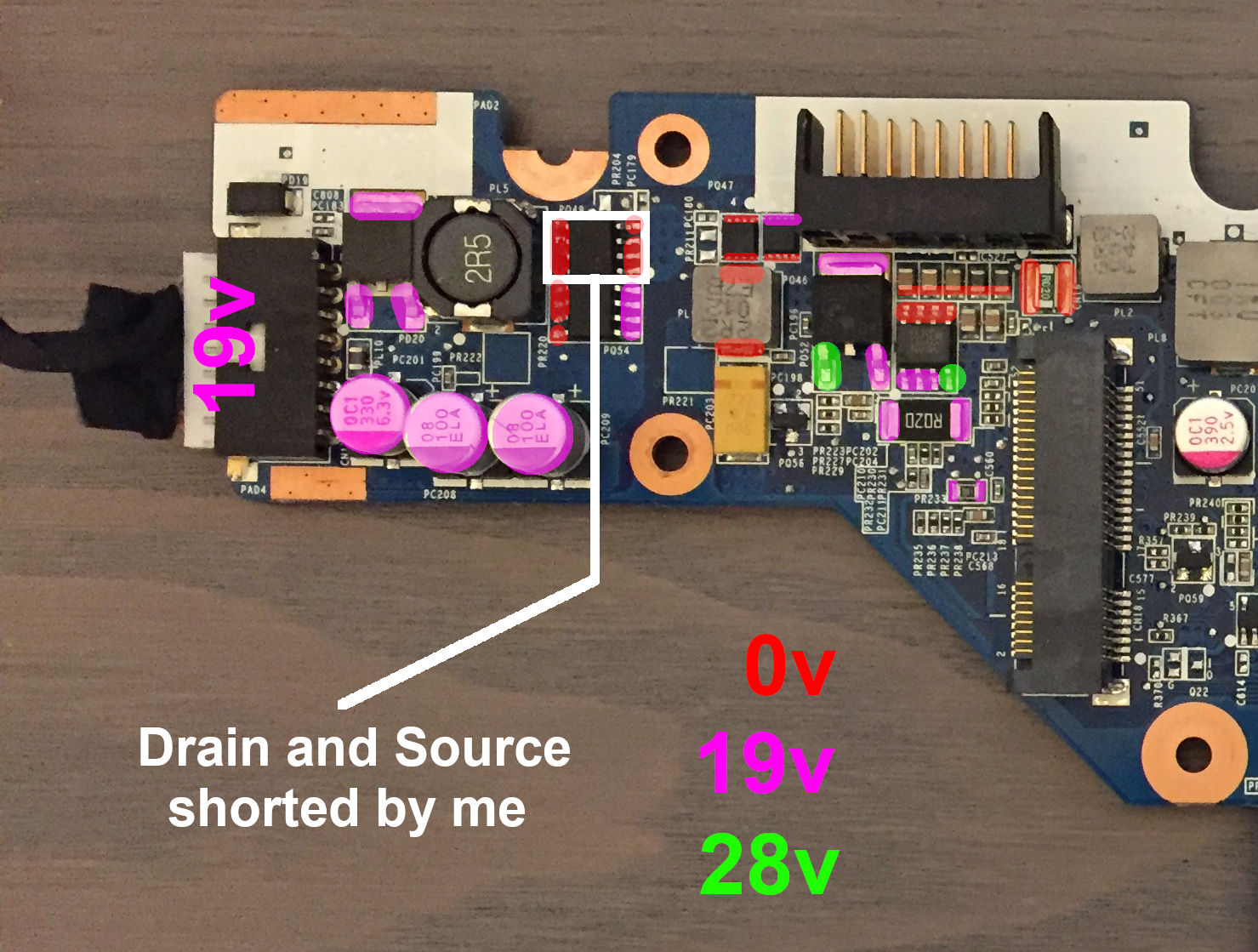

    Following a series of very bad actions guided by my ignorance:
    - Firstly I confused the MOSFETs of the 5v step down as the power circuit MOSFETs just because they were the nearest to the 19v plug
    - Then I obviously measure 6v instead of the 19v I was expecting, so I though that the problem was the second MOSFET not receiving the enable voltage on the gate.
    - So I decide to remove the second MOSFET (low side), short the source and the drain and plug the charger. "Unexpectedly" the laptop stopped to work: no power led, nothing.
    - Then I remove the short and plugged the AC adapter again.
    "Probably" I should have read good guides like the ones that I later found in this forum and also "maybe" took a look at the schematics before doing this mess.
    A brief recap of the current state and the tests I've made:
    - The MOSFET I shorted is the low side of the 5v step down. 19v in input and nothing after the first or second MOSFET. No voltage on the gates.
    - 19v after the current sensing resistor
    - No shorts on the main power rail
    - Charger IC seems to be powered. I attached few images with all the measures with AC adapter plugged in.
    - 3.3v missing on power button
    - No AC adapter led
    - No shorts on the board and all the fuses seem ok

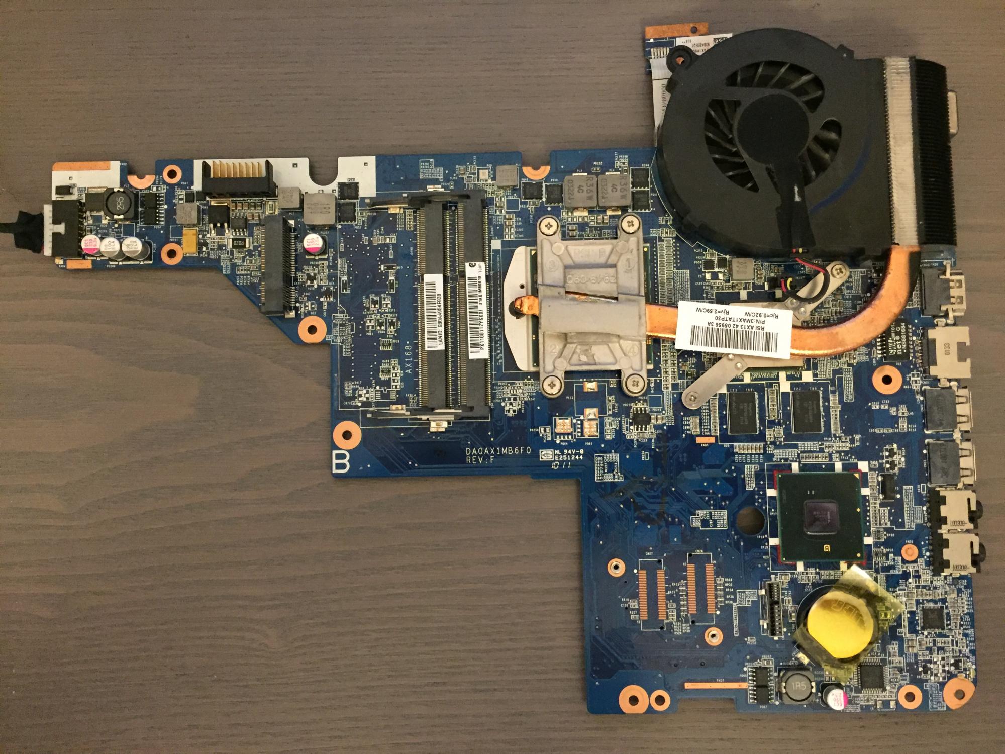

    Board: DA0AX1MB6F0 REV:F
    PC specs: Core I3 330M, Radeon 5430
    I kindly ask for a hint of what I should check and thank you for anything that can improve my knowledge. I'm here to learn.

    Re: HP G62-100SL "killed" by myself - No power

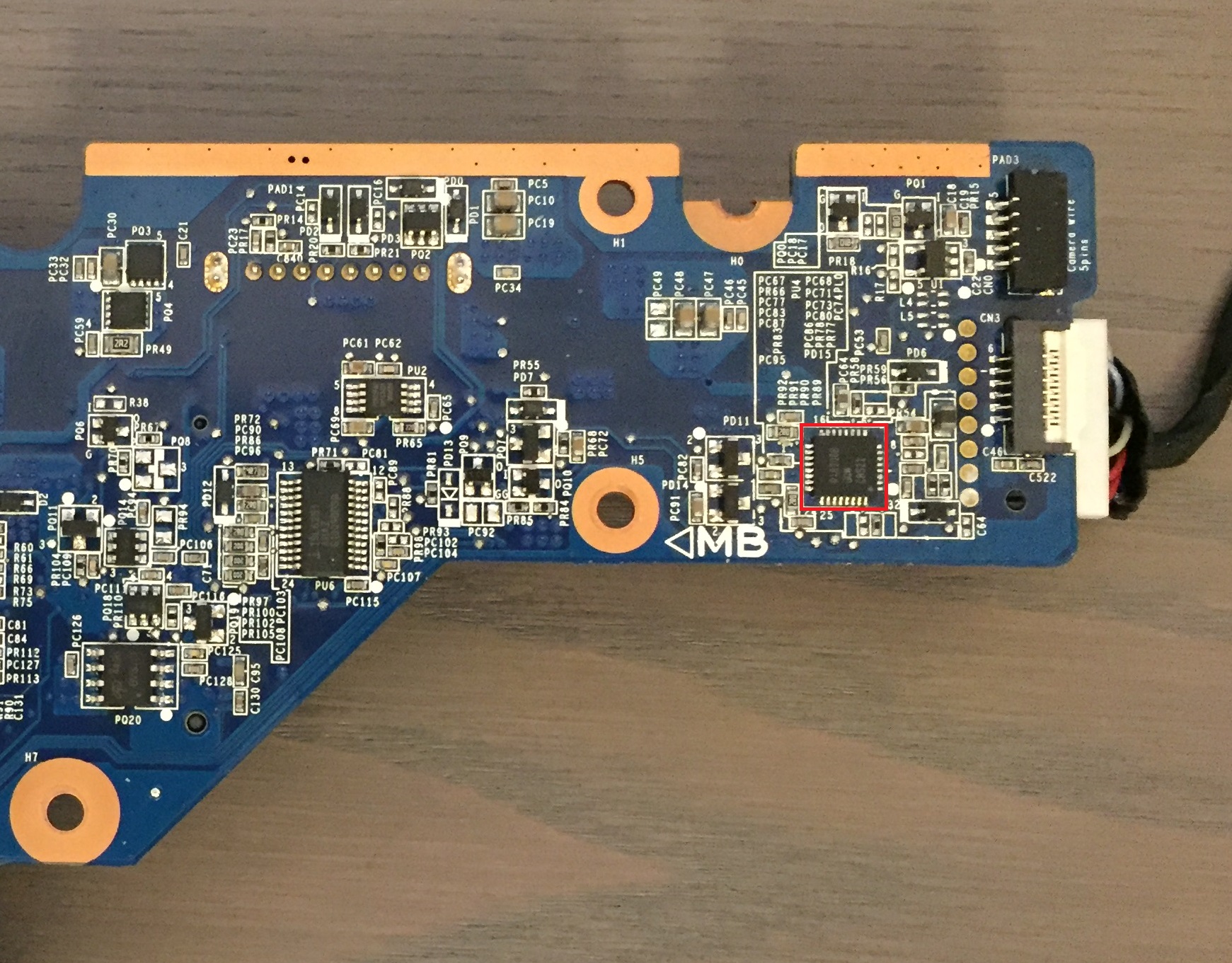

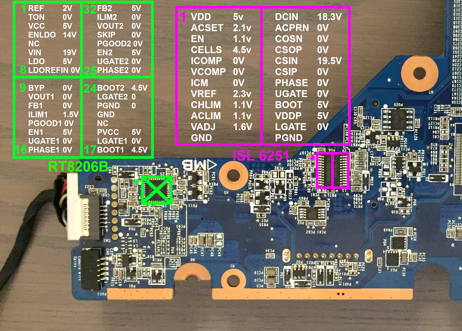

    I add the AX1 boardview, meanwhile I checked SuperIO chip VCCs and are all missing.
    Some observations on the stepdown chip RT8206 (labelled PU4 on schematics).
    - I guess the chip has power because VCC (pin3) is 5v as well as PVCC (pin19)
    - VIN (pin6) seems correct because is 19v
    - ENLDO (pin4) is high (14v measured) and LDO (pin7) is enabled (5v measured)
    - Enable signals of 5v arrive to EN1 (pin14) and EN2 (pin27)
    - No tensions for the 5v MOSFETs gate are generated at UGATE1/DH1 (pin15) and LGATE1/DL1 (pin18). Same story for the 3v MOSFETs with no tensions at UGATE2/DH2 (pin26) and LGATE2/DL2 (pin23). So both 5v and 3v lines are missing: 0v measured at resistors PR220 and PR221
    - PHASE1/LX1 (pin16) and PHASE2/LX2 (pin25) are both 0v
    The fact that power is provided to the stepdown IC along with enable signals and on the other side there are no outputs, suggest me that the IC is dead.
    Do you think the same or I'm missing some signals that can activate this chip? Are there other things to check?
      After your bad actions may be +3.3V_ALWP is short as you know PWM section Low voltage high in amps if one fet fault you replace all and never power up without fet , left one pad PL9 and see what side is short to GND , if EC VCC AVCC get a higher voltage ! May be bad EC also , no power in PWRBTWN is normal +3V line is down
      For ENLDO depending on the platform they have used Zaner Diode 2 R 1k /150k dividers

        Thank you for the reply. I have lifted the coil (PL9) and measured the resistence: on the mosfet side (Pin1) I read 100ohm to GND while on the other side (Pin2) I have open line.
        Do you need other measures?
        I've forgotten to mention that I put back the MOSFET that I removed.

          100 ohms to ground on the mosfet side is too low. The other pin of the removed coil SMD pad (+3.3V_ALWP) is a good value which confirms there is no shorted cap downstream.
          The low-side mosfet @ PQ47 may be shorted. Remove PQ47 off the logic board and then measure the resistance of this device to check if it is shorted.
          Meter in 2k scale (or similar).
          Check the resistance of:
          source (1-2-3) & drain (5-6-7-8)
          source (1-2-3) & gate (4)
          gate (4) & drain (5-6-7-8)
          of the removed mosfet. Post the readings. Checking for a low resistance reading that appears to be the case @ 100 ohms to ground. If still this low, this mosfet is defective and must be replaced.
          While testing, perform the same test of the high side mosfet @ PQ46.
          Post the readings.

            Ok, PQ46 is definitely good: open line for all G, D, S combinations.
            PK47 has source(-) to drain(+) resistance of 600ohm and drain(-) to source(+) resistance of 37Kohm. Open line for source-gate and drain-gate.
            EDIT: coil to GND resistance for mosfet side is 35 Mohm now (open line I guess). Probably my previous measure on the other side was bad, because I'm measuring 5Kohm (slowly decreasing over time). Probably my probe was not set correctly due to the restricted space.

                                Today arrived the donor board. I swapped the two MOSFETs (PQ46 and PQ47), I've also replaced the IC PU4. Nothing seems to be changed. Voltages are the same as before and no charger led.
                                Always voltages (5V and 3.3V) are still missing (measured between the coils and GND).
                                Now I have also a bench PSU. I provided from 5v to 19v to monitor the current, but the board does not take any current.
                                It seems that some missing signal prevent the two switching power supply to turn ON.
                                • Fr4gz0n3
                                  • Feb 2022
                                  • 31
                                  • Italy

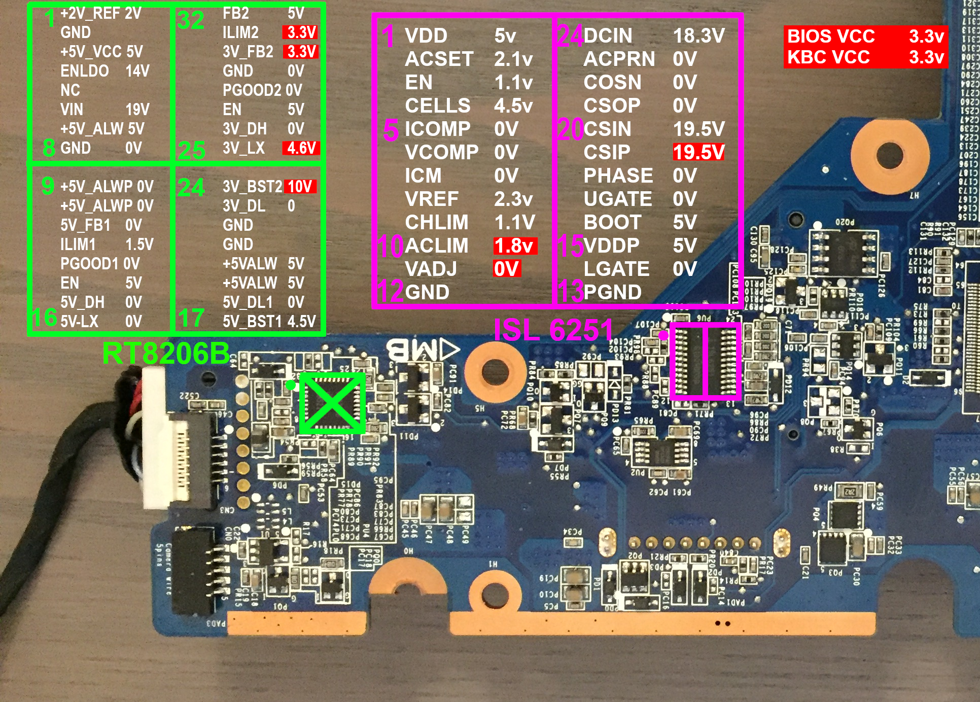

                                  Good news! Now the always 3.3v line is working. The problem was that the new step down controller was not soldered correctly. Probably 1 or more pins had bad connection.
                                  To recap the current status:
                                  - 19v main power line works. 19v arrives at the MOSFETs of the different power supplies
                                  - Always 3.3v line is working correctly. 3.3v to the BIOS, the KBC and the power button
                                  - Always 5v line still missing. Measured at coil PL5.
                                  - Still no power consumption from the charger
                                  - Still no charger led (Can it has been burnt? Or is just due to the missing of 5V)
                                  I attach few images. Two reports the components replaced in red and one contains the measurements updated (the changes are highlighted in red). I also rename the stepdown controller labels following the schematics, so now are clearer.
                                  Can it be a good idea to try a 5v injection to check if the rest of the board is working?
                                    Which 3.3 volt is working?
                                    Is it +3VPCU (created by PU4) ?
                                    Always reference the same labels as used in the schematic as there are numerous power rails that can confuse the review.
                                    Do you have +5VALW?
                                    • Fr4gz0n3
                                      • Feb 2022
                                      • 31
                                      • Italy
                                      I'll try to be more specific in the future
                                      The +3VALWP/+3VPCU is present (3.3v measured on PC302) while the +5VALWP/+5VPCU is missing.
                                      I measured:
                                      +3VALW -> 3.3V
                                      +5VALW -> 5V
                                      +10VALW -> 3.5V
                                      +15VALW -> 7.2V
                                      Can I ask you the difference between ALW and ALWP/PCU?
                                      To be noted that the PU4 has been replace with a used one from the donor board so it's not guaranteed to be 100% working.
                                      I forgot to mention that now I'm using the original HP charger.

                                        Respectively, each power rail will have its own characteristics or specs.
                                        Take for example for this logic board:
                                        +5ALW rail. This rail is created by the internal LDO (low drop out regulator) @ pin # 7 of PU4.
                                        Being a LDO (and not a switching regulator = often called a buck regulator if it takes a HIGH voltage as input -> converts it to a low voltage at the output), we do not expect this rail to be a very high current regulator. LDO regulators are not very efficient and literally 'burn' the high voltage down to a low voltage and this results in heating up of the regulator = PU4 IC.
                                        I would guess this LDO is under 1A max for the +5ALW rail. For this reason, the downstream (consumer) rail will be a light load.
                                        Now, take the +5VPCU rail which is still +5V but is rated @ 8A !! and is a switching regulator so it pulses ON / OFF very quickly to reduce the heat from this task. The catch is that this regulator is NOT always ON, it has an ENABLE pin. The above LDO is ALWAYS ON for light loads.
                                        The +5VPCU is a hefty switching power supply for heavier loads.
                                        The ALWAYS ON must be immediately ON upon receiving laptop power to allow for the basic circuits to be powered. Then the ball gets rolling from here...
