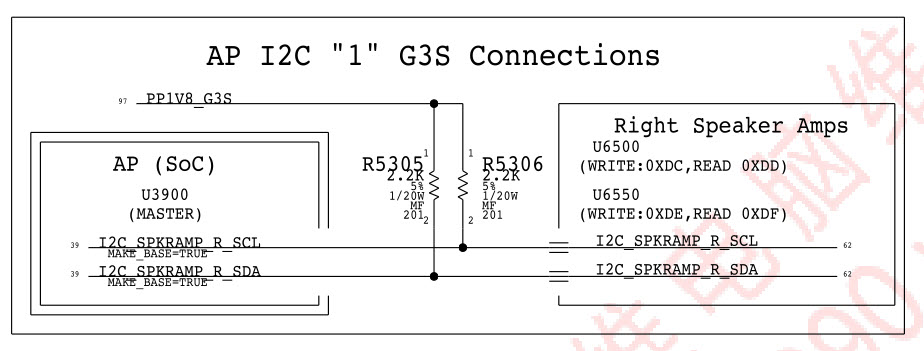

    I have an A1989 and it had some liquid on it. Nothing is visible on the board. Everything works! But I only have one short sound on the left speaker. When I ask Siri about the weather, there is only one sound on the left, after that there is no more sound!
    Even if I restart once briefly sound then nothing more.

                Re: Apple A1989 no Sound
                See attached.
                Measure the voltage on both sides of R5305 & R5306. These are the local pull-up resistors for the RIGHT side of the audio amp circuit for this open-drain circuit. These resistors are required to define the soft 'high' logic level.
                What are the readings for the respective,
                I2C_SPKRAMP_R_SCL
                I2C_SPKRAMP_R_SDA
                signal lines ?
                • Strolch
                  • Nov 2017
                  • 237
                  • Deutschland
                  Hi, i have on R5305 and R5306 both sides 1,7930 Volts

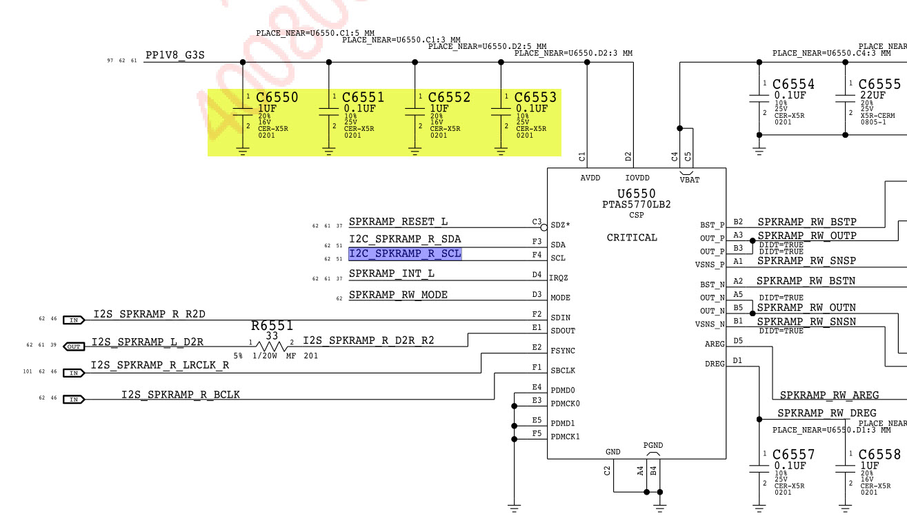

                  • mon2
                    • Dec 2019
                    • 14261
                    Voltage readings look fine and this implies the local pull-up resistors are pulling up the I2C lines to the 1v8 rail.
                    Confirm that the audio amp (U6550) is being powered - check for the 1v8 rail on the linked parts. See attached.
                    Any sign of liquid damage in this area ? The U6550 component is a WLCSP package (tiny BGA) which may need some TLC with flux and reflow -> tweezers to make it dance if you suspect corrosion which may be under the package.
                    • Strolch
                      • Nov 2017
                      • 237
                      • Deutschland
                      Everything looks very good. And 1.79 volts are there

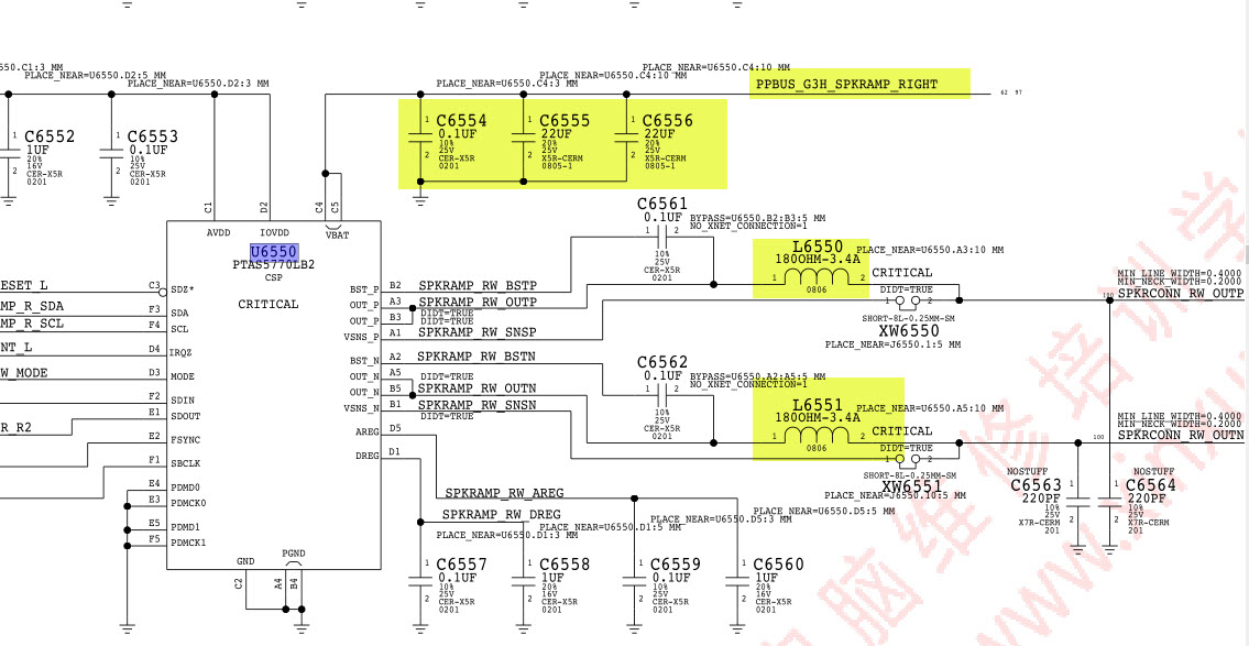

                      • Strolch
                        • Nov 2017
                        • 237
                        • Deutschland
                        you think the U6550 is damage?
                        • mon2
                          • Dec 2019
                          • 14261

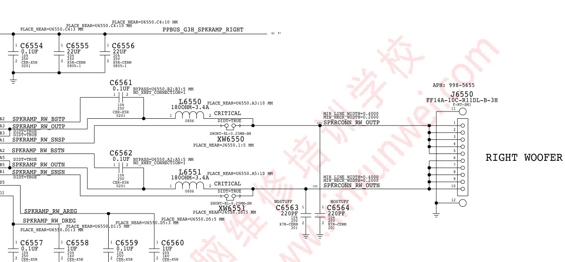

                          Perhaps but confirm the voltage as per attachment for the VBAT pins. You can check this on the caps.
                          Then confirm that L6550 & L6551 are present on the logic board. These are acting like filters but they must mate onto the woofer connector.
                          Remove all power, meter in resistance mode -> check the resistance between:
                          L6550, pin # 1 and # 2 - should be ~0 ohms
                          L6551, pin # 1 and # 2 - should be ~0 ohms
                          then check resistance between pin # 1 -> woofer connector as per attachment.
                          Need to be sure that both P (Positive) and N (Negative) leads of the speaker are reaching the pin # 1 of the respective ferrite beads.
                              i will check L6550, L6551...after a bike ride ;-)
