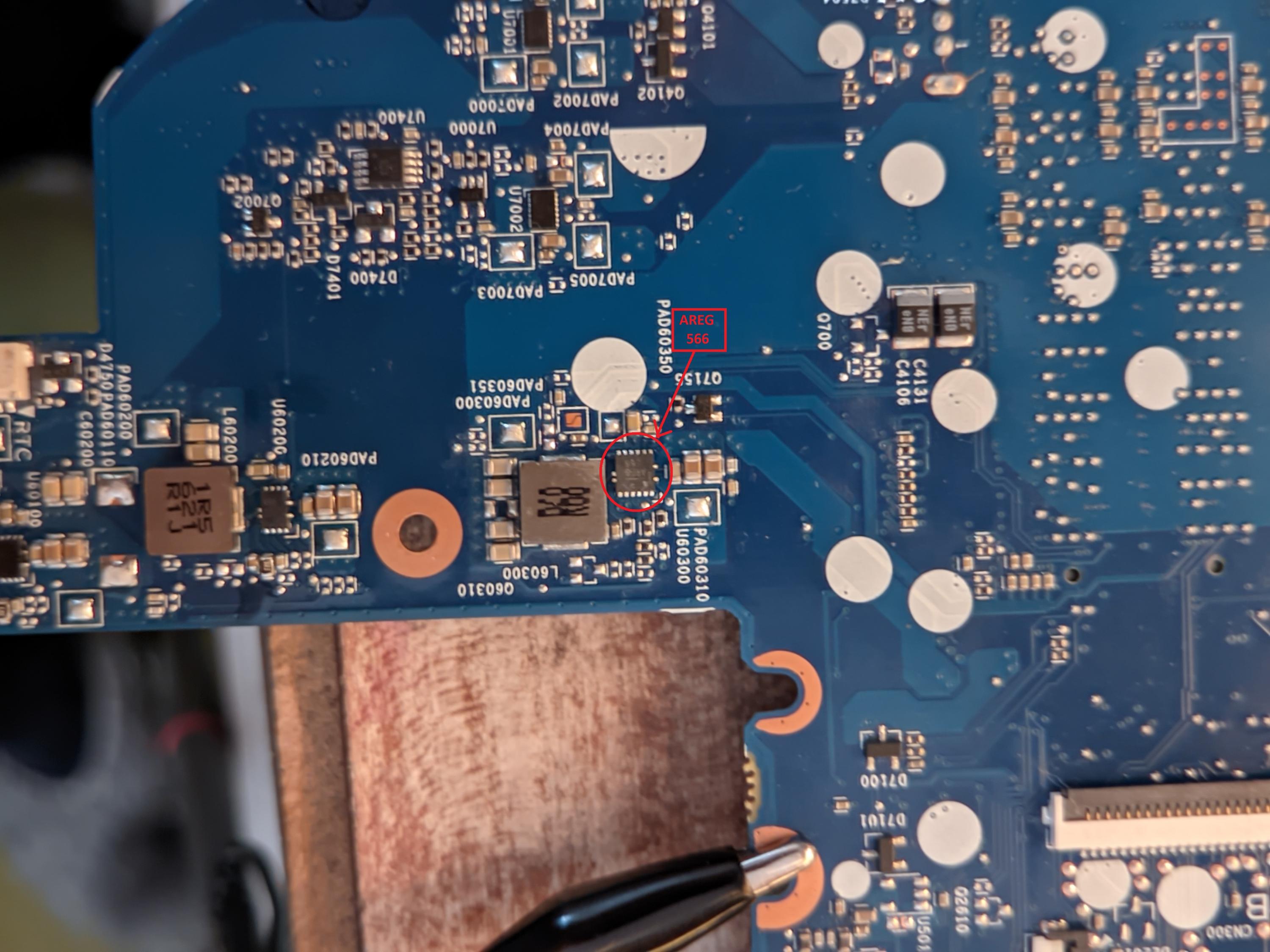

    Can you help me with the name of the integrator "U60300" Main Board "CIRCUS-6050A2723701-MB-A02"
    On the integrated circuit is written the following code "AREG 566"
    Thank you!

    See attached.
    MPS p/n NB685AGQ

      Re: HP 650 G2 Integrated Circuit Name
      Thank you very much!
      I find your answer very helpful :a învârti:
