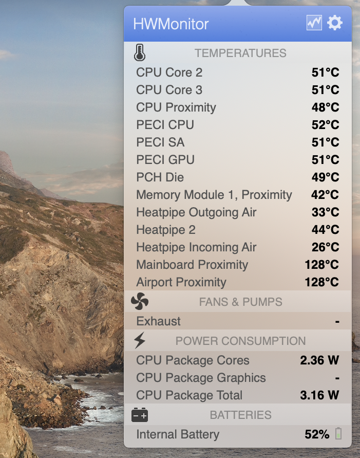

                  I managed to get Catalina MacOS installed on an external USB drive, i plugged it in using the USB Type-A to USB Type-C adapter. Its loaded into the OS and i have just installed HWMonitor. The readings i got are below, see screenshot:
                  The two that stick out is the 'Mainboard Proximity' and the 'Airport Proximity'.

                    The overall temperatures seem that low you'd have to assume the CPU is being throttled. Without ASD for this model, it does become a bit of a crapshoot.
                    I'm not sure HWmonitor is accurate for this model since I don't have a A1708 to hand (only have a couple of A1706 machines). But the Airport reference would have me looking closely at U5800. I've had one of these TMP421 IC's have an issue on a A1706 board, where liquid had corroded pin 8 and it's corresponding pad. I was able to clean up the pin on the IC, but I ordered some replacements off Aliexpress. Bit pricey but they were genuine (since they were obviously removed off an Apple board). Maybe also check U5810 too.

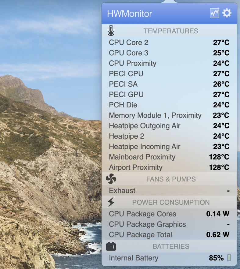

                      Yes i started with the U5800 and U5810 because of the Airport Proximity but those IC's are not on the board. Even better was when i checked the schematics not even a mention of a 'NO STUFF' for either of them! Haha.
                      I then had a thought to try the machine in SMC bypass mode, booted her up and the machine was running normally (no throttling). Ha. Ok, i thought, well then let’s check the 'SMC SMBus "1" S0 Connections', i checked pull up resisters R5360 and R536 (multi meter in voltage mode (20V) black probe to ground and red probe to PIN #1 and #2 at each resister and both were measuring 3.3V.
                      You'll will never guess reformatt and mon2 what it was in the end, i logged back into the machine and started to scope out Console > system.log and started to see all these errors occurring in and around 'mds' and 'mds_stores', i did some searching and found that this was related to 'Spotlight'. I opened Terminal and entered (turns off indexing):
                      sudo mdutil -a -i off
                      And then kernal_panic simmered down and the machine was back to normal, result! Then i ran the following command to remove all Spotlight Directories:
                      sudo rm -Rf /.Spotlight-V100
                      And to re-enable indexing i entered:
                      sudo mdutil -i on -E /
                      Now the Macbook Pro is running and back to normal. The part which i am trying to get my head around in all of this, is if Spotlight is local to the MacOS on the external USB drive only, which is where it is running from at the moment. Which i am sure it is. So if this is as is, would this effect the internal SSD and my attempts to install MacOS previously on it, it is quite strange.
                      Reformatt see the updated screenshot of HWMonitor now all this is done, temps seem much more usual now.
