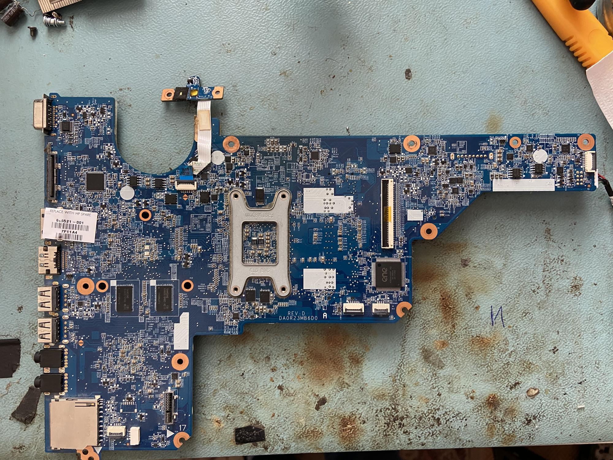

    I have here this laptop water damaged little bit. After cleaning laptop turn on fan is spinning, but only black screen. And caps lock blink continuously. Then I found bad resistor near PU11, PR207 -360K. I replace it with 330K and caps lock stop blinking but still black screen only. 1.2V power rail is present, CPU and GPU heat normally, RAM voltage present. I didn't test flash bios yet, but when there is water damage I mean this is not bios problem.. and on VGA external monitor also black screen only. Any idea? Thanks.

    In the Ram slot Test pin 30 75 199 203 supply any missing voltage on the coils ?
    • Techtiger
      • Oct 2014
      • 1601
      • france
      Re: HP G6-1270EC black screen
      After test pin 13 34 EC supply

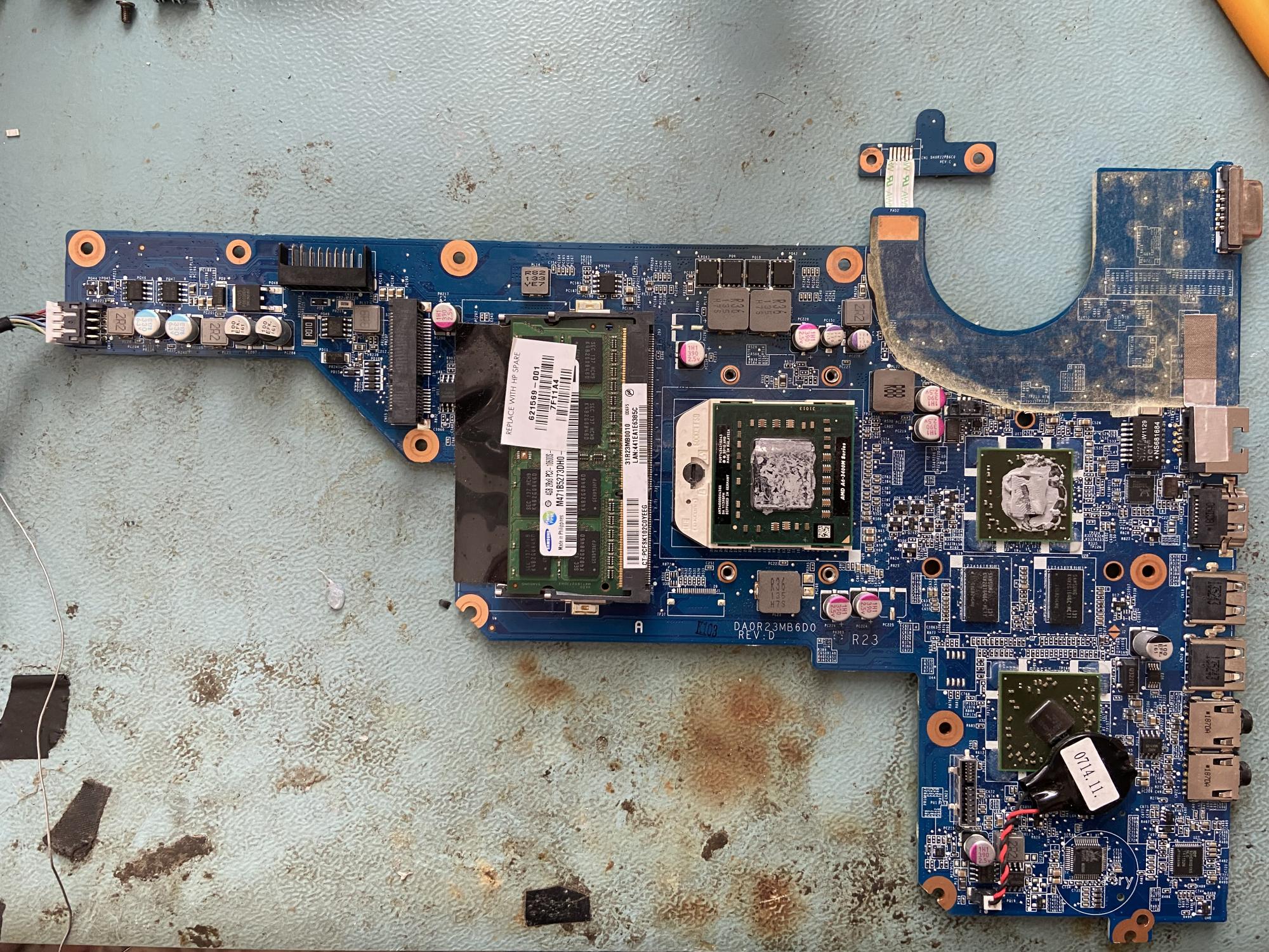

        Thanks for answer.
        30 - 0V
        75 - 1.54V
        199 - 3.3V
        203 - 0.77V
        Where to measure pin 13 34 please?
        And on all coils are voltages only on charging coil is 0.6v

                  My mistake i was looking different Quant R check again Ram slot pin 198 126 1 for
                  pin 30 M_A_RST# comes from AMD MEMORY CHANNEL so if this voltage is missing no image fault
                  • DeniS182
                    • Jun 2014
                    • 328
                    • Slovakia
                    It's ok and I measured pins:
                    1 - 0.77V
                    126 - 0.77V
                    198 - 1.54V
                    30 - 0V
                    So if 30 - 0V my CPU/APU is the problem?

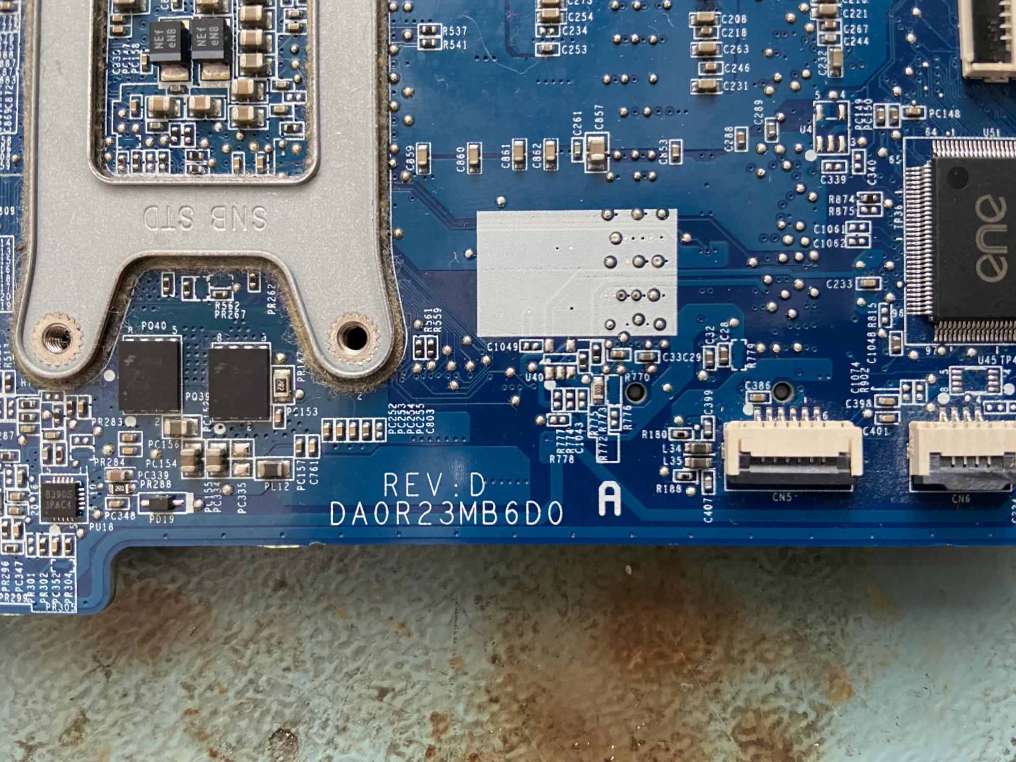

                      Often the failure point on this mb is circled. Check the requirement of these 2 IC and see if it helps.
                        1 - 0.77V
                        126 - 0.77V
                        198 - 1.54V
                        30 - 0V
                        May or maynot be. DRAMRST# signal will not rise if apu/fch requirement are not fulfilled
                        • DeniS182
                          • Jun 2014
                          • 328
                          • Slovakia
                          this 2 IC's looks ok, output voltage is present.. hard to find the fault
