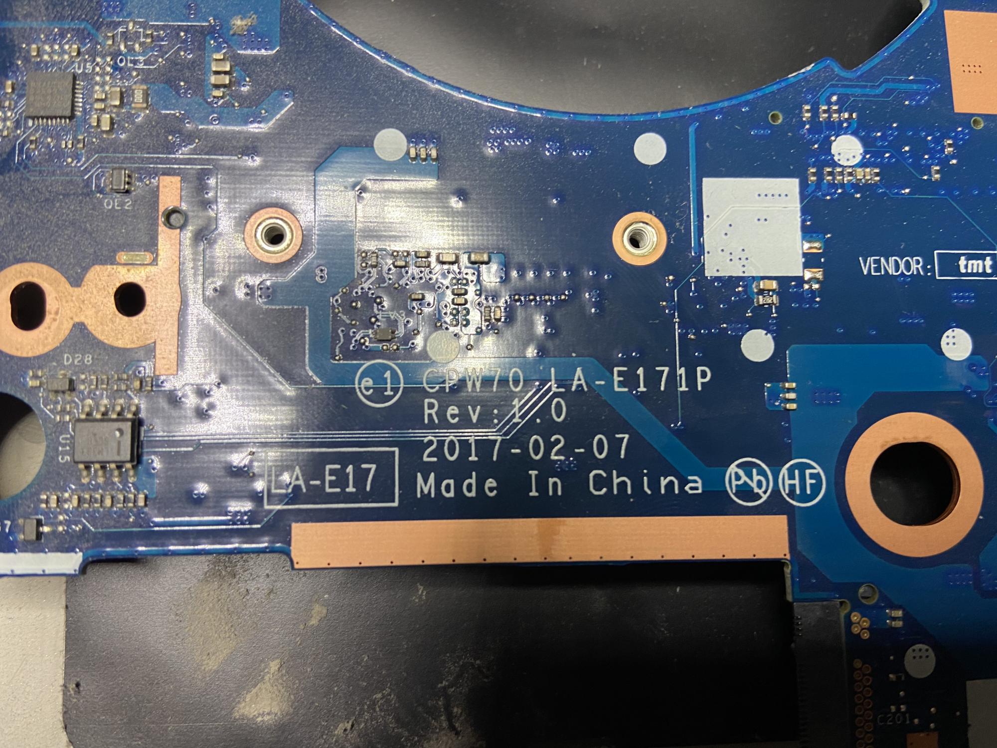

    I have here this laptop. When dc adapter is connected, led near dc port is ON and after power button is pressed nothing happend. 19v is present, 5v is on power button. I found PL39 shorted to ground 0.5ohm. But i don't know what voltage is this rail. I desolder PJP2 jumper and tried inject 1V from my power supply to find something hot but my power supply after repair can supply only 0.7A when voltage is set to 1V. (Of course when I short probes its only 0.7A) and this current is too low to heat bad component and I dont't have thermal camera.
    Please have someone schematic or something what help me?
    Board is CPW70 LA-E171P Rev : 1.0

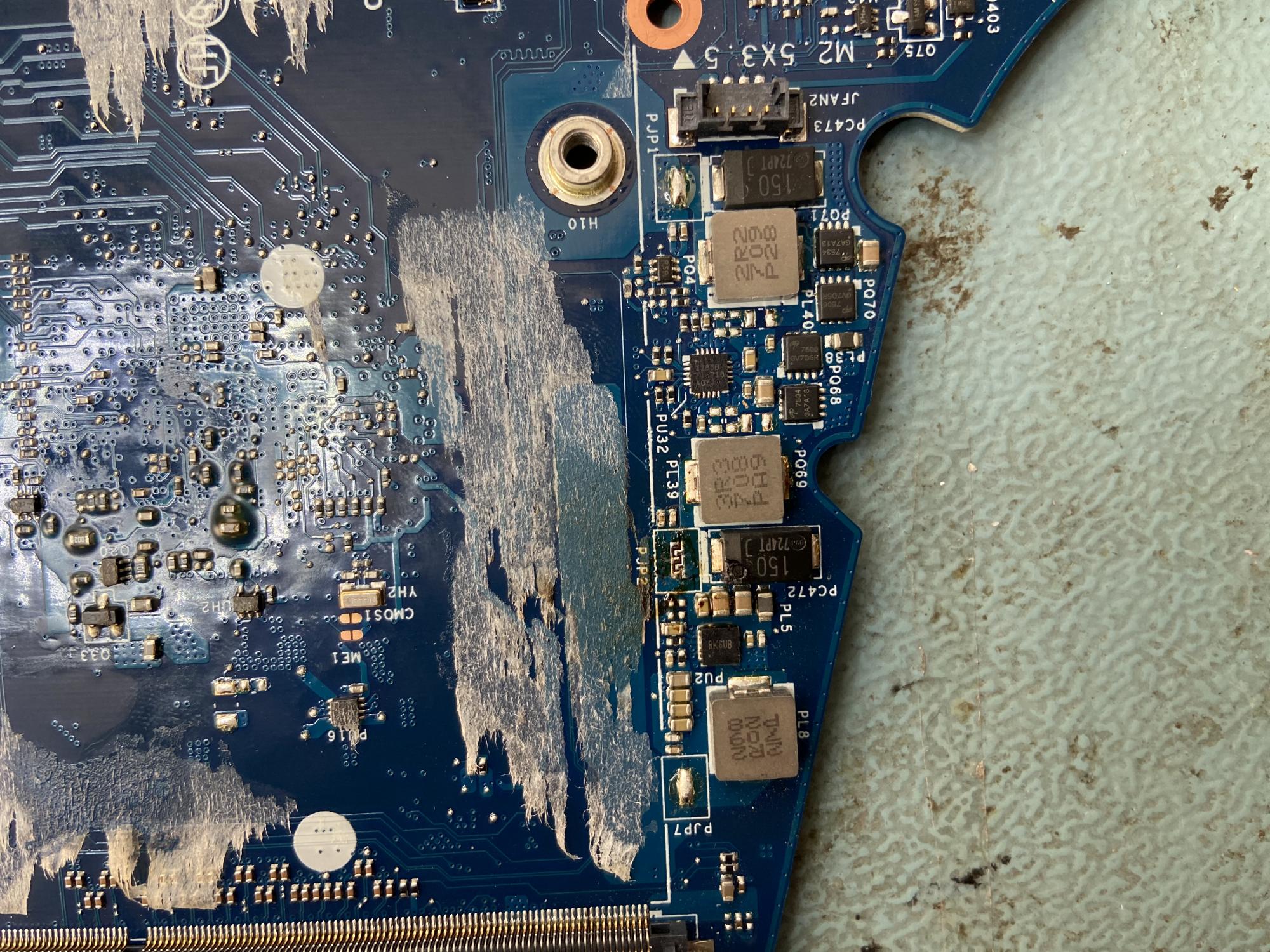

        Re: HP ZenBook 17 G4 not turning on
        Originally posted by DeniS182
        I have here this laptop. When dc adapter is connected, led near dc port is ON and after power button is pressed nothing happend. 19v is present, 5v is on power button. I found PL39 shorted to ground 0.5ohm. But i don’t know what voltage is this rail. I desolder PJP2 jumper and tried inject 1V from my power supply to find something hot but my power supply after repair can supply only 0.7A when voltage is set to 1V. (Of course when I short probes its only 0.7A) and this current is too low to heat bad component and I dont’t have thermal camera.

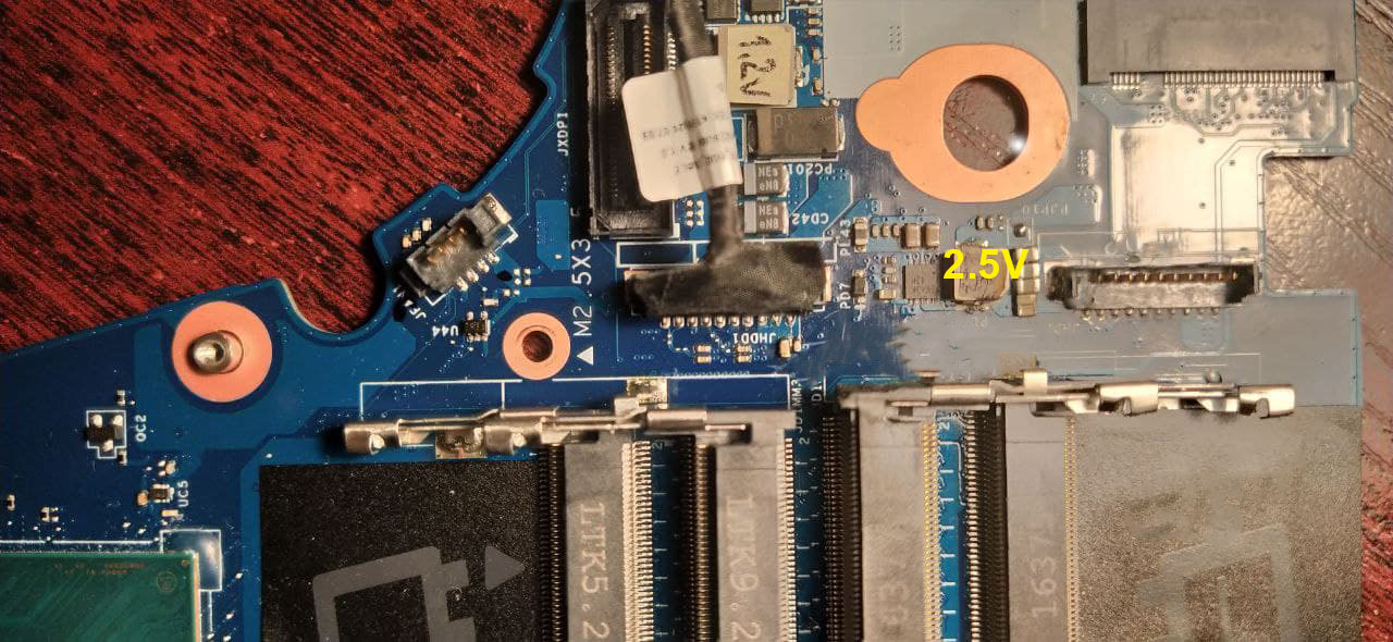

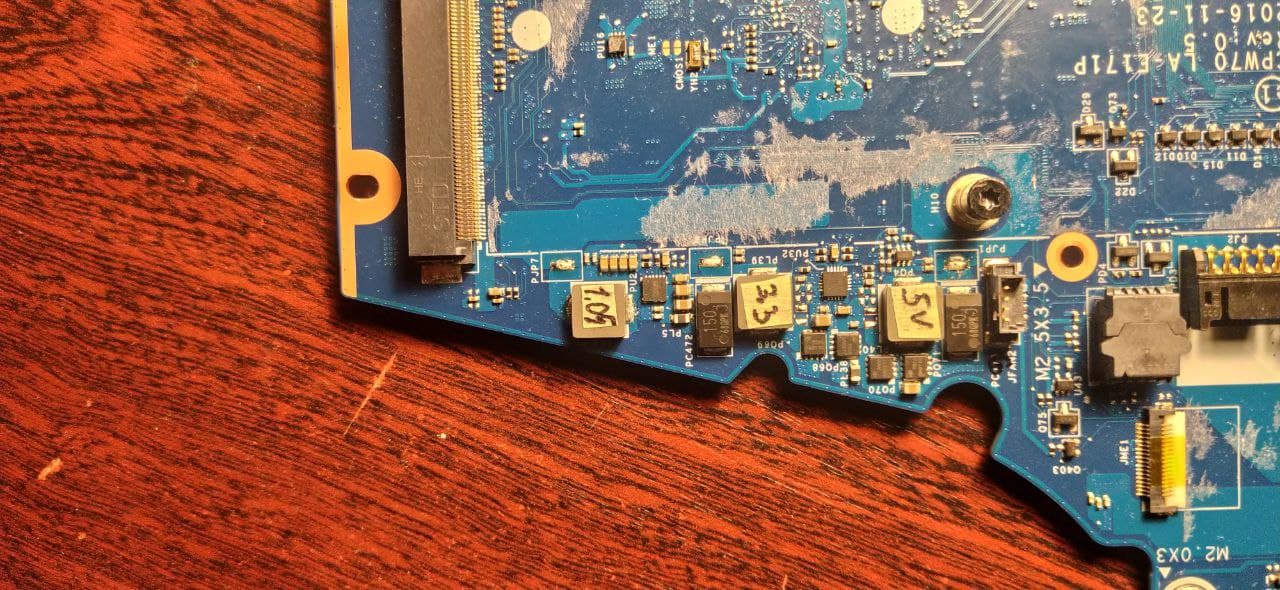

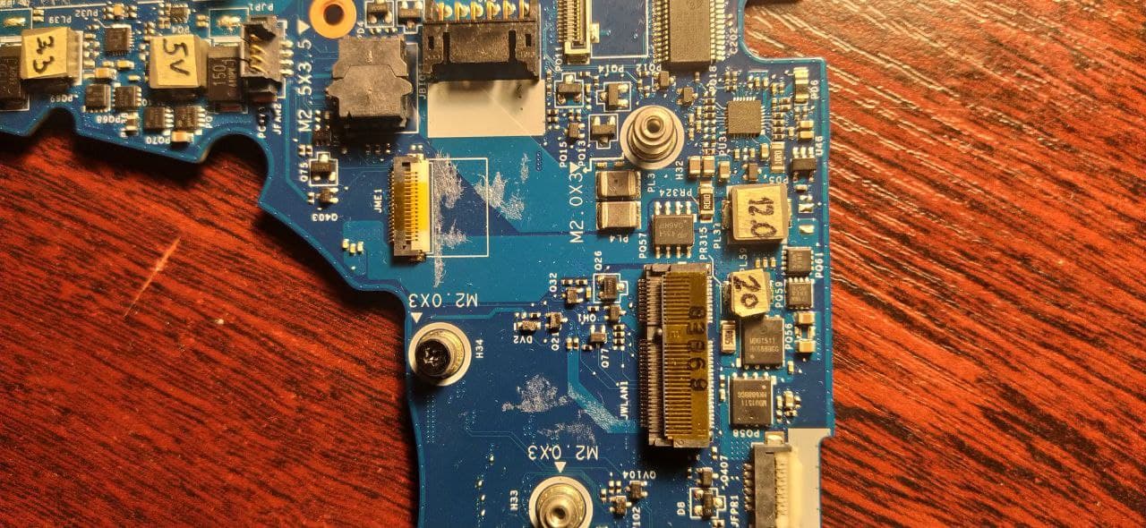

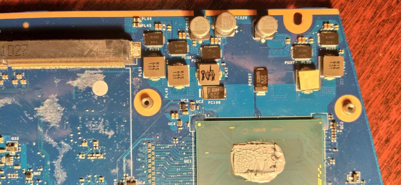

        look at images
        PL39 is 3.3V
        • DeniS182
          • Jun 2014
          • 328
          • Slovakia

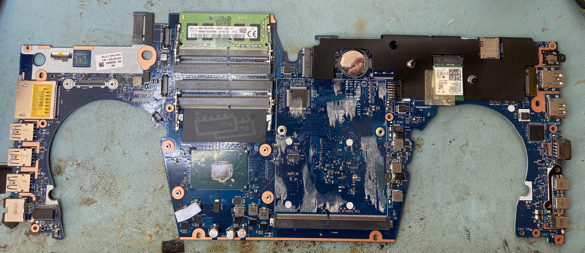

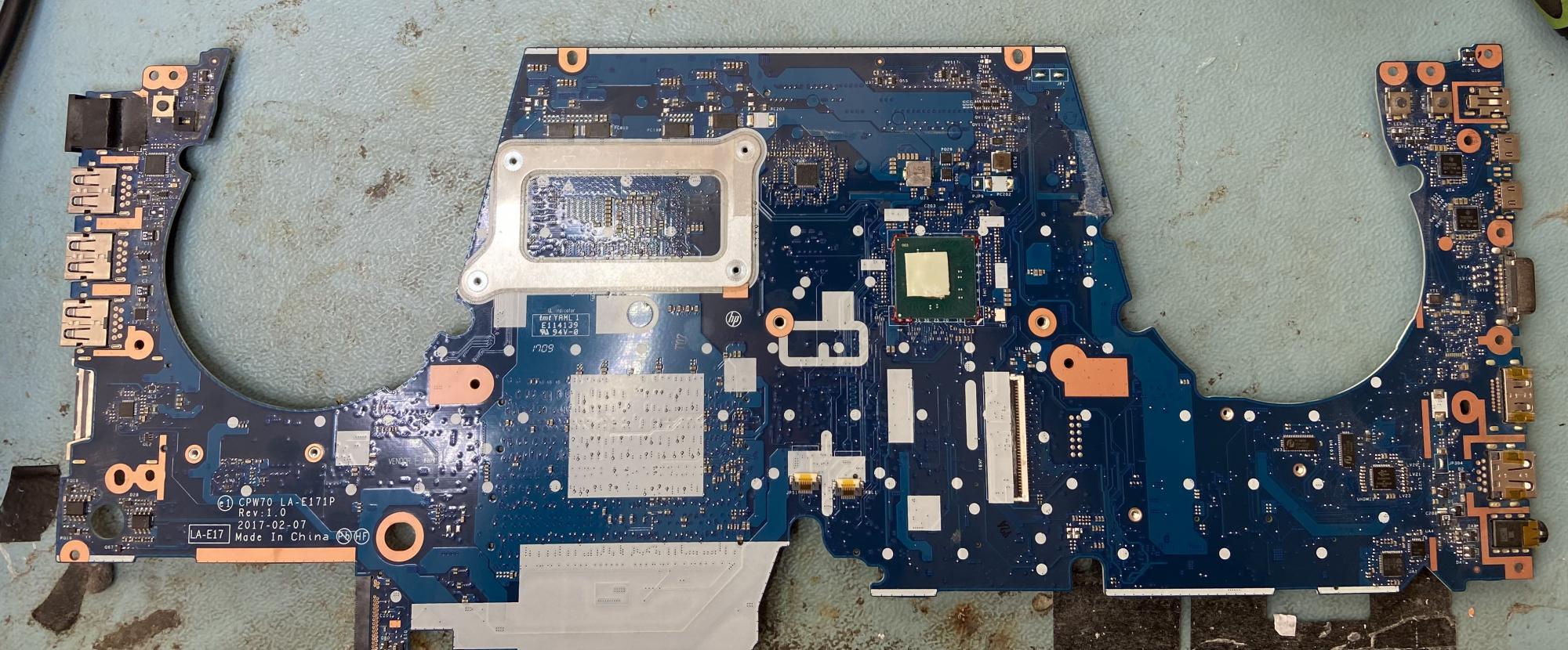

          Thank you for the pictures. Problem is in CHipset. I check the whole board, chipset is hot.
