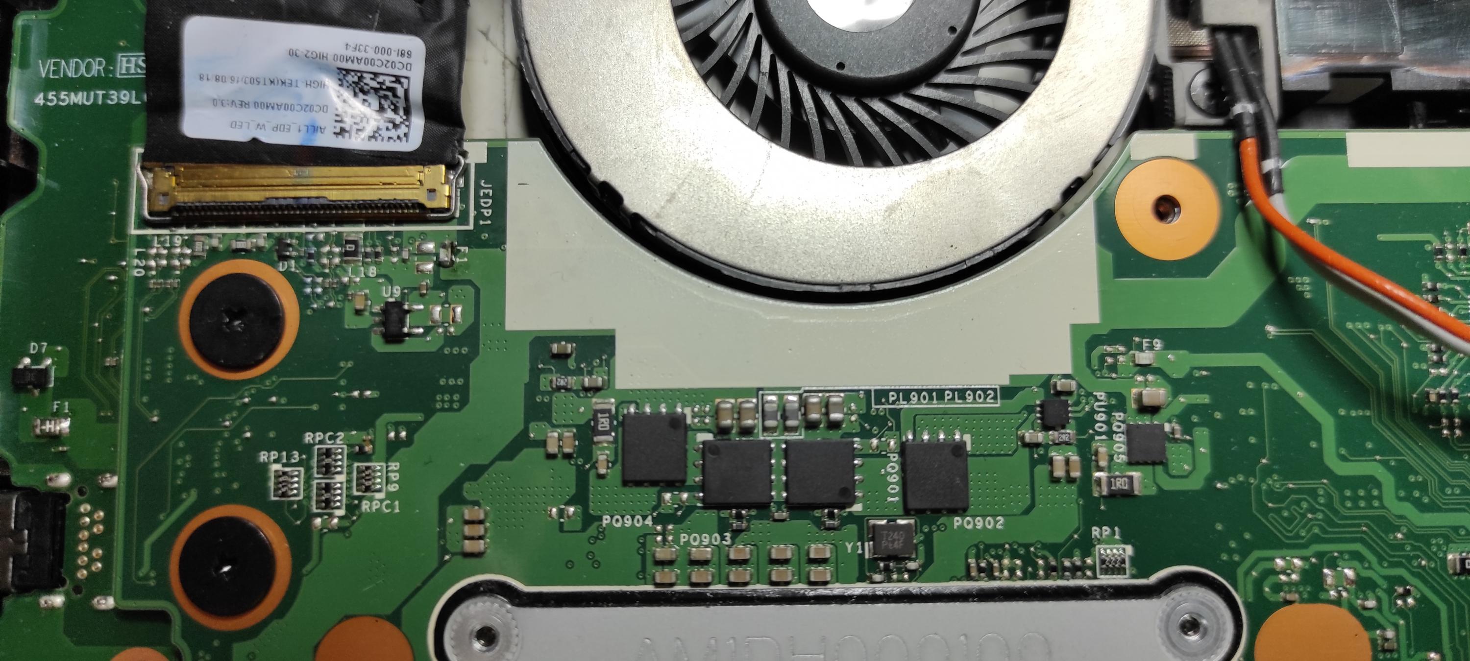

    Hello!
    I have a L560 here without backlight on screen, the usual suspect (F1 3A) was burnt so i replace it, 20v are passing through now and arrive to the led backlight flex but still no backlight on screen.
    I tried other lcd but no backlight on them too so the fault is not on lcd.
    There are no schematics available for this board so i'm blind.
    Any thoughts?

      Have you seen a pinout like this?��
      Also one silly question, how is it possible the 20v to arrive at led flex but this to remain off??

        LA-C422P is quite similar, i see the JEDP1 connector there too and it's identical.
        Any ideas?
        (Page 19 is the lcd connector)

            Unfortunately i don't have cable for this model , that's why i want to eliminate all other possibilities before order one.
            What pin should light up the backlight?

              mesure pin 7 + 8 bkoff# and invpwm and write how much volt it is
              • Andreasbest
                • Aug 2014
                • 1196
                • Hellas ( Greece )
                Re: Lenovo Thinkpad L560 No backlight
                No voltage on pin 7 and 8
                Only pins with voltage are 1, 2 & 3 @20V, pin21 @ 3v and pin18 @ 3.3v

                  So your problem is mb related. Voltage on all pins listed by@mielta along with 19V is must for screen display with backlit.

                        You need to manually trace where those pin7/8 goes. Resistance on both pin7-8?? You can try by cutting the track for pin8 on mb and then applying 3v from dc supply to LVDS connector pin and see if it works.

                          The pin 8 goes to a SMD, i'll see if i can desolder it to cut the trace softly and apply 3v

                            Should i measure directly @ pin 105 of U34 if the 3v are present?
                            Is this correct?

                              Connection between U34 pin 105 and 8pin of JEDP1 is intact.
                              No way to cut the trace as it goes directly on inner layers of MB.
                              Other way?

                                Edit: Start with the basic checks - the fuses on the screen itself, on both lines 3.3V and 20V, check them first.

                                  Yes battery removed right before the disassembling, these faults are happening only once
                                  The fuses i manage to locate and check are:
                                  F1 (The 20v one, was burnt and replaced the thread with 3A, now 20v passes through it)
                                  F3
                                  F4
                                  F5
                                  F7
                                  F8
                                  PF101
                                  PF201
                                  Is any of them the 3.3v one?

                                    Apparently you didn't understand what I meant - I meant that 20V (if the charger is plugged into the laptop) or 12V (or as much as the battery voltage is) is fed/present to the display connector , regardless of whether the machine is running or turned off.

                                    I said "the fuses on the screen itself" (screen pcb) - not motherboard fuses. You didn't read carefully. There are usually two fuses, one for 20V and one for 3.3V line.

                                      The other way is to find out the cable connected to pin8 of LVDS pin and cut it and then apply 3v on the part of cable which goes to screen. Anotherway is to find out continuity between pin8 of LVDS and screen connector.

                                        Hello Vesko.
                                        Yes i understand, maybe i didn't type it well.
                                        1) i know the power from PSU and batery are present even if laptop is off in several parts, recently i destroyed a Precision 7510 this way so i got my aftermath.
                                        2) In the previous posts i mention that i have tried several screens, none of them gave backlight (most are broken and/or with lines but backlight used to work), so i guess the voltage from 7 and 8 pin is missing from mb fault, not screens.
