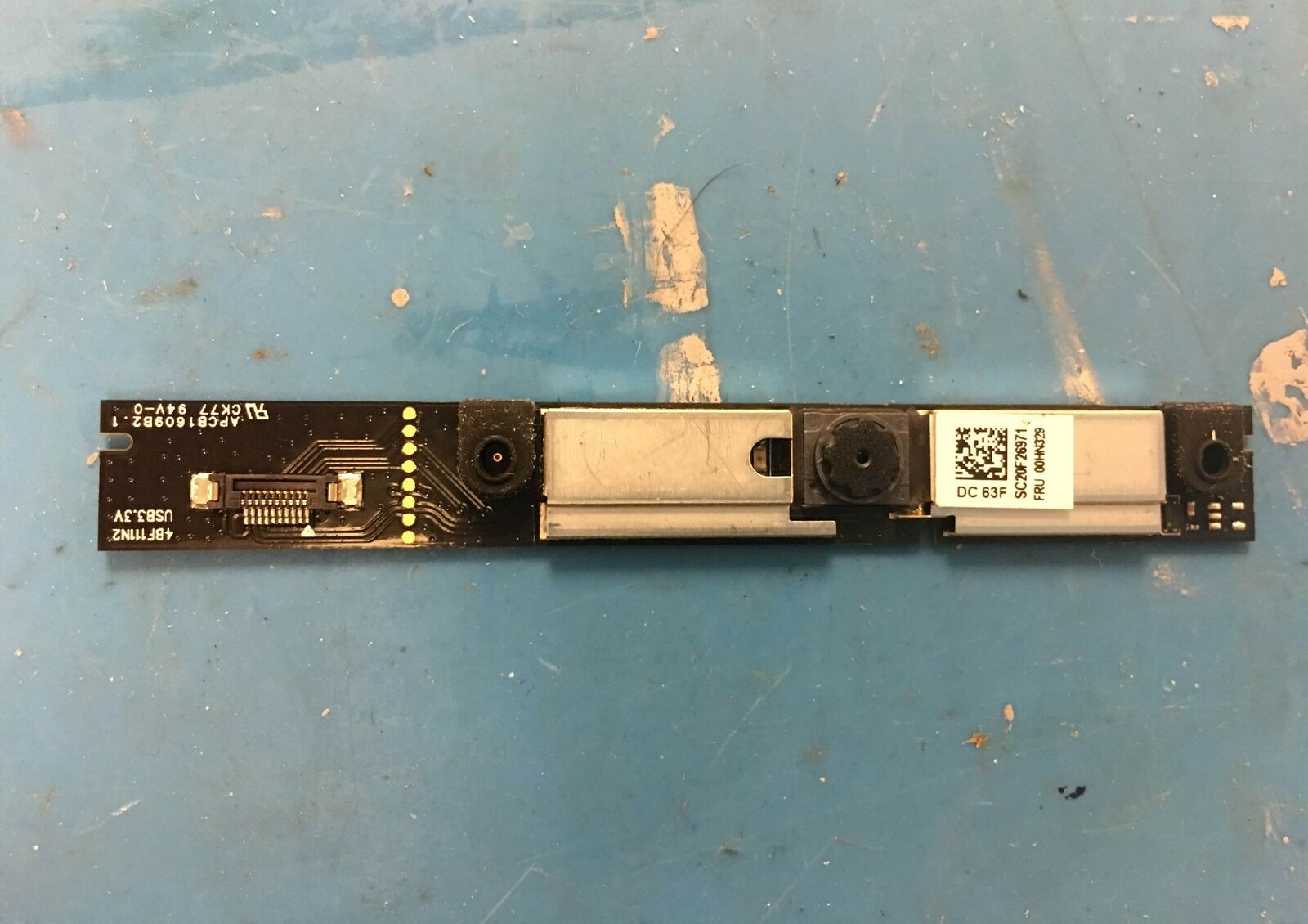

                      #50
                      Re: Lenovo Thinkpad L560 No backlight
                      I guess the sensor is on the camera pcb because it's completely aligned with the magnet on the palmrest.
                      • JaroTech
                        • Mar 2015
                        • 351
                        #51
                        Can you take a picture of the camera circuit board, that might be enough to identify the chip.
                        • Andreasbest
                          • Aug 2014
                          • 1196
                          • Hellas ( Greece )
                          #52
                          Unfortunately the chip is covered behind shielding that is soldered on the pcb.
                          • JaroTech
                            • Mar 2015
                            • 351
                            #53
                            So, with all the tests you've done, pin 26 stayed at zero volts when disconnecting the connector from the camera and when disconnecting the screen from the ribbon. The only time you have 3.3 volts on pin 26 is when you disconnect the display ribbon from the motherboard with nothing connected to it.
