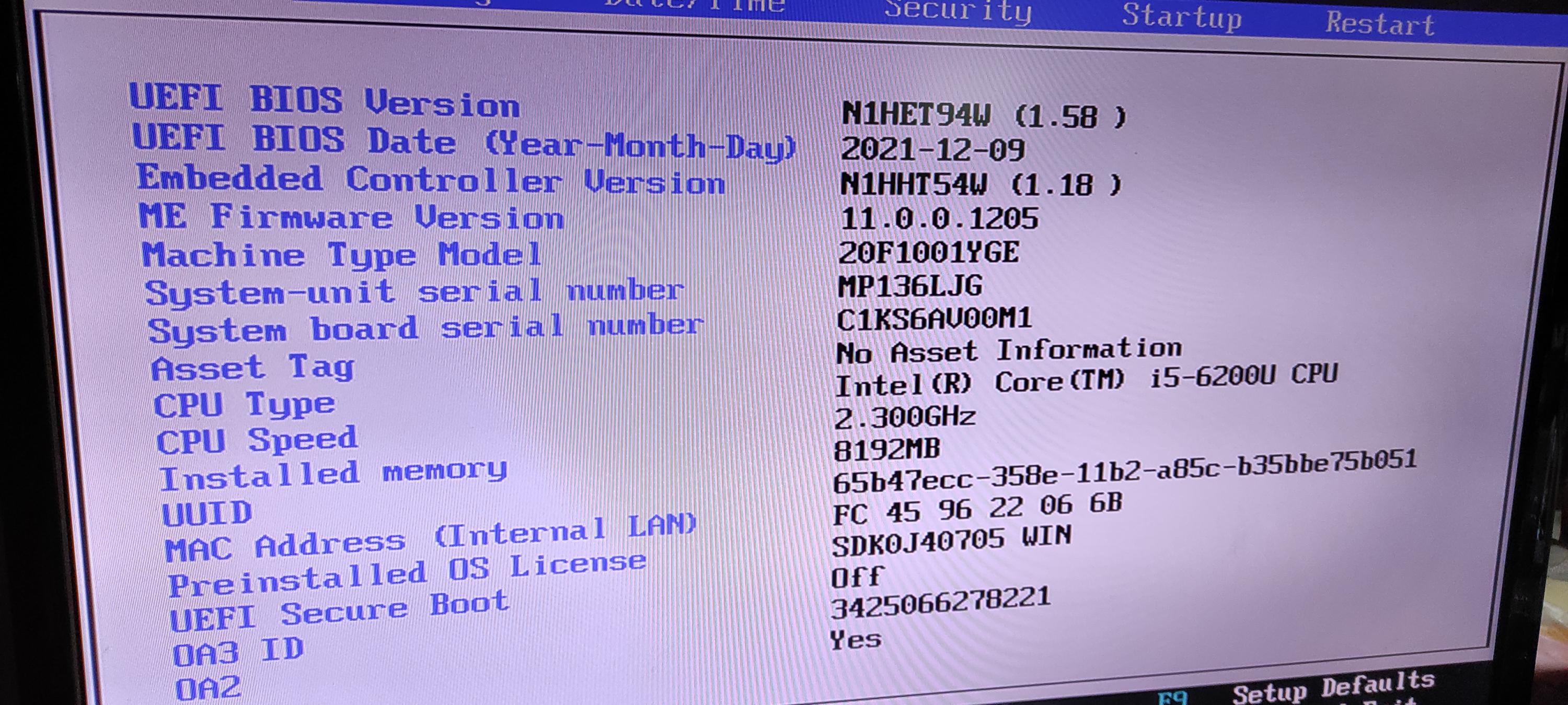

                      #30
                      Re: Lenovo Thinkpad L560 No backlight
                      Here is screenshot from bios too
