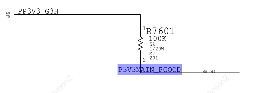

            P1V1_SLPDDR_SOCFET_EN 1.80V should it be 1.1 ?
            No. The logic level for the enable is at 1v8 but output of this power rail is 1v1. No issue here.

              You mean while I tried entering DFU mode? I tried with and without battery it doesn't help, the battery is completely dead 0V in both pins. I have followed the video on logiwiki same board with disconnected battery and he successfully entered DFU, but he say that he use external power supplly. Did it mean that the charger is not enough and need external power supply on 20v? https://youtu.be/e0jevSCQxGE
              what about the question « I DON't understand why i don't get P3V3MAIN_PGOOD on pin 2 since I have the PP3V3_G3H_T on pin1 ?​ » is it due to a bad chip ?
                This signal is the power good signal and is common to such regulators. This output is an open-drain type. This means that ONLY if the voltage being monitored is with specifications then this output signal will be left floating. For this reason, there must be an external resistor that is the pull-up resistor that is required to park this floating line to a logic '1' state to denote to the external logic, the voltage is stable and within proper range.
                See attached for the local pull-up resistor for this line. Measure the voltage to ground of the pull-up voltage. Same note as post # 3 / # 4. This voltage must be stable - not fluctuating. If this pull-up voltage is fluctuating then there is too much current being drawn on this rail.
                After the above check, remove all power -> meter in resistance mode -> measure the resistance to ground of PP3V3_G3H. If the resistance is too low, then there is a shorted part on this rail that needs to be located and removed. Perhaps a bad capacitor.
                Confirm that R7601 is not defective and is ~100k ohms across the pads of this part. No power during resistance checks.
                Click image for larger version  Name:	pull-up_resistor.png Views:	0 Size:	19.3 KB ID:	3498538

                  Thanks for your explanation.
                  I have 3.3V in pin 1 of the resistor and 3mV in pin 2.
                  When I check for short on PP3V3_G3H​ in pin 1 it start 28 ohm then increasing until 16kohm but sometimes it’s in Mohm. In other area it always high resistance

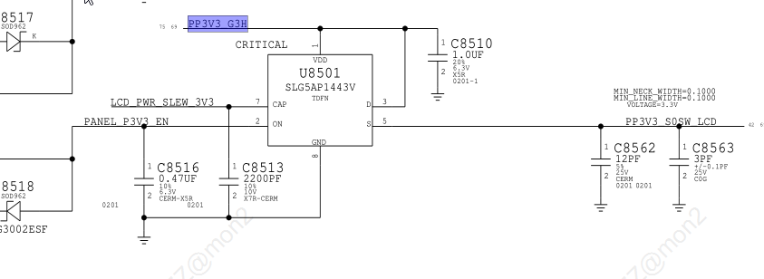

                  I decided to replace the U7650 and the resistance R7690 (in my case) now I have 5.146V and around 160mA in all USB-C. Then I checked the resistance to ground in PP3v3_G3H is 32 Ohm, everywhere I measure is the same 32ohm, which is a clear short that I have to find now.

                    Suggest to review the areas linked to removable devices like the LCD. Locate -> flux and remove U8501 which is the power load switch for the LCD display assembly. Perhaps too much current went through this load switch and is now shorted. Keep track of the pin # 1 orientation of this component which is polarized. After the part is removed off the board, test if the resistance to ground of this rail returns to normal or not. Ideally a thermal camera will help here but IPA (alcohol) can also be used to locate the shorted component(s).
