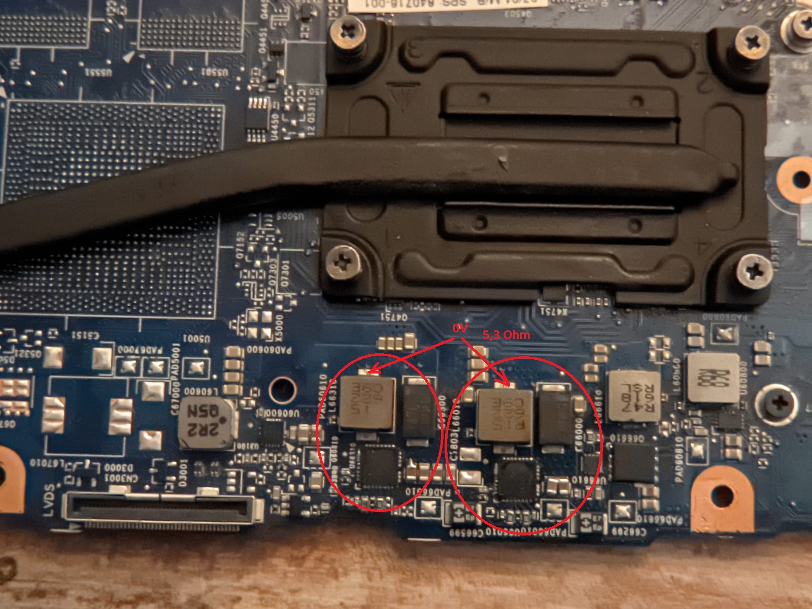

    Hi
    I'm asking for help with the CIRCUS-6050A2723701-MB-A02 motherboard that I can't turn on.
    I have typed into memory all the bios posted on this forum, with all pretty much the same result: Turns on the fingers, POWER, AUDIO on/off, and WRILES LED, and after 10-15 seconds the fan starts up with increasing speed.
    All voltage sources are OK except for two that don't draw any voltage:
    U66010 and U66310 (SIC631) = 0V I measured with ohmmeter against ground the outputs after coil L66010 and L66310 = 5,311Ohm
    I measured the voltages on pins U66010 and U66310:
    Voltages with power OFF button
    Pin 1=0V
    Pin 2=2V
    Pin 3=5.2V
    Pin 5=4.9V
    Pin 7=0V
    Pin 8,.....11=19,7V
    Pin 16,....23=0V
    Pin 29=5,2V
    Voltages with power button ON
    Pin 1=2,58V
    Pin 2=0V
    Pin 3=5,2V
    Pin 5=4,9V
    Pin 7=0V
    Pin 8,.....11=19,7V
    Pin 16,....23=0V
    Pin 29=5,2V
    Translated with www.DeepL.com/Translator (free version)

    Re: HP 650 G2 Troubleshooting Help
    Can anyone tell me what the voltage should be on those two sources?
    What is the value of the output resistance to ground?
        In these cases it is often a communications issue between the VRM Controller and the CPU, which usually means the CPU is bad. Measure Power Inputs, Enables, PGood, VRHOT# and ALERT# to have a basic overview
