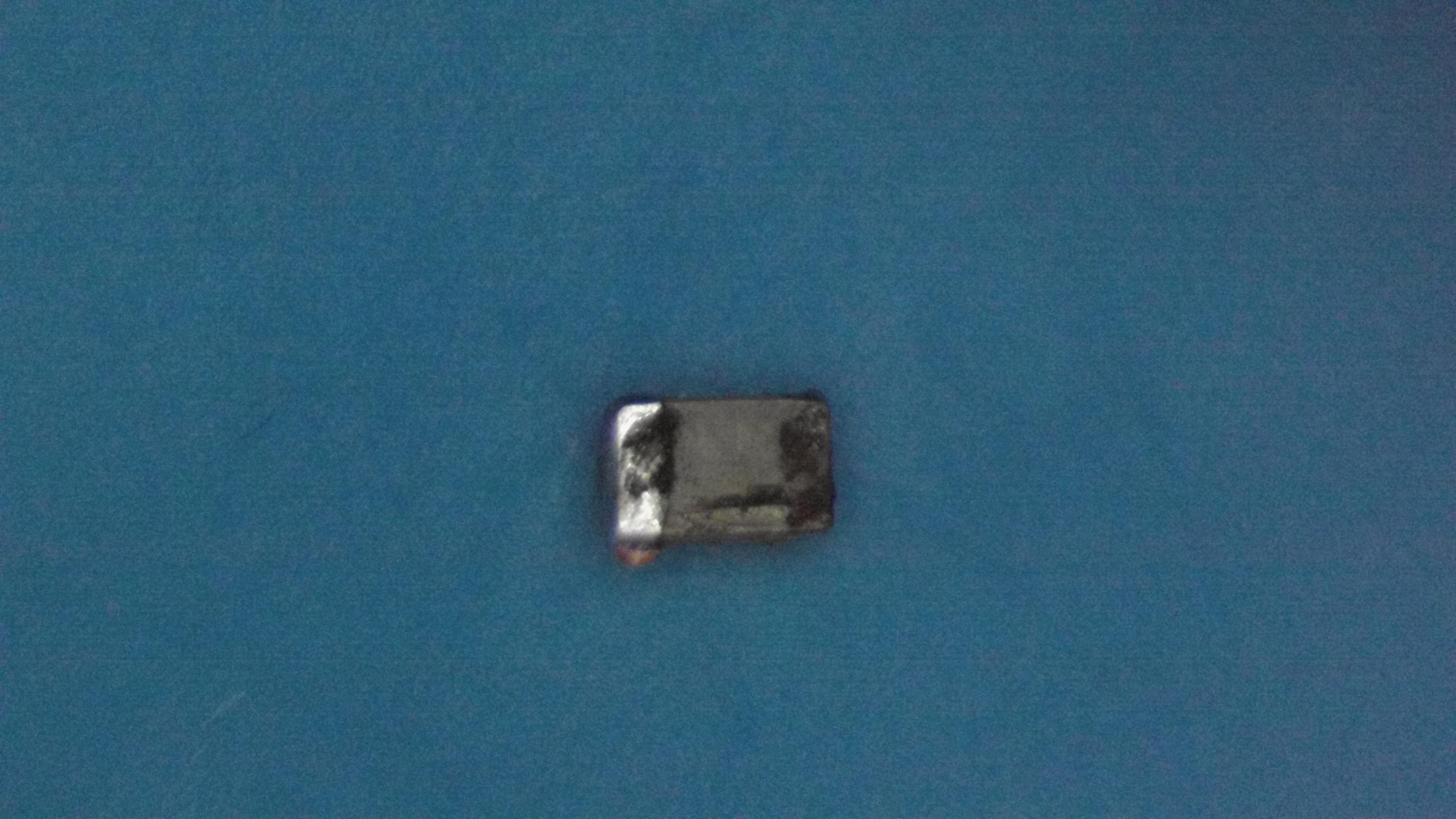

    I would just apply ample flux and use a wide tip on the soldering iron and attempt to nudge it with tweezers, little at a time. With enough heat, the part should start to shift, little at a time. Heat up one side and then the other - heat will also travel through the part but work quickly and you should be able to remove it.
    On my wish list are a good pair of the soldering iron tweezers but there may be better tools out there.
    Do not even use the hot air at all. Try this idea first.
    Alternatively, blow the air in the opposite direction -> towards the edge of the PCB and away from the plastic connector. That should also work out ok.
    A bonus if you can apply an aluminum foil shield over the connector or polymide (kapton) tape over the sensitive areas.

      Hi mon2 I had to retreat back to the tranches again for this one and restrategise, the J6602 connector got me pickled, I think the hot air for this one was a no go because of it. So I restrategised to try this, I applied ample flux as you suggested and took some solder (lead free) and applied a small portion to the soldering iron, whilst on I then started to apply the soldering iron on the side away from the J6602 connector. And voila, after some swiping back and forth on one side the capacitor just popped off! Can you see the issue, see below for the image? HAHA.
      The side shown on the image was the underside of the capacitor so this was not easily visible on the board when testing. Injecting voltage was the revelation.
      Measured again the resistance to ground (black probe to ground point and red point to F7000 PIN #2) and short gone!
      I don't suppose mon2/anyone here has a C6405 spare capacitor laying around for sale? I do not have any donor board so I do not have one immediately available. It is a 22uF/20% tolerance/25V/0805-1 (X5R-CERM).

        Good job! Would not have guessed this region to have the bad cap.

            Hey mon2 i replaced the C6405 capacitor and what da ya know i put it all back together and ITS WORKING! I appreciate all your help mon2 on this one.
