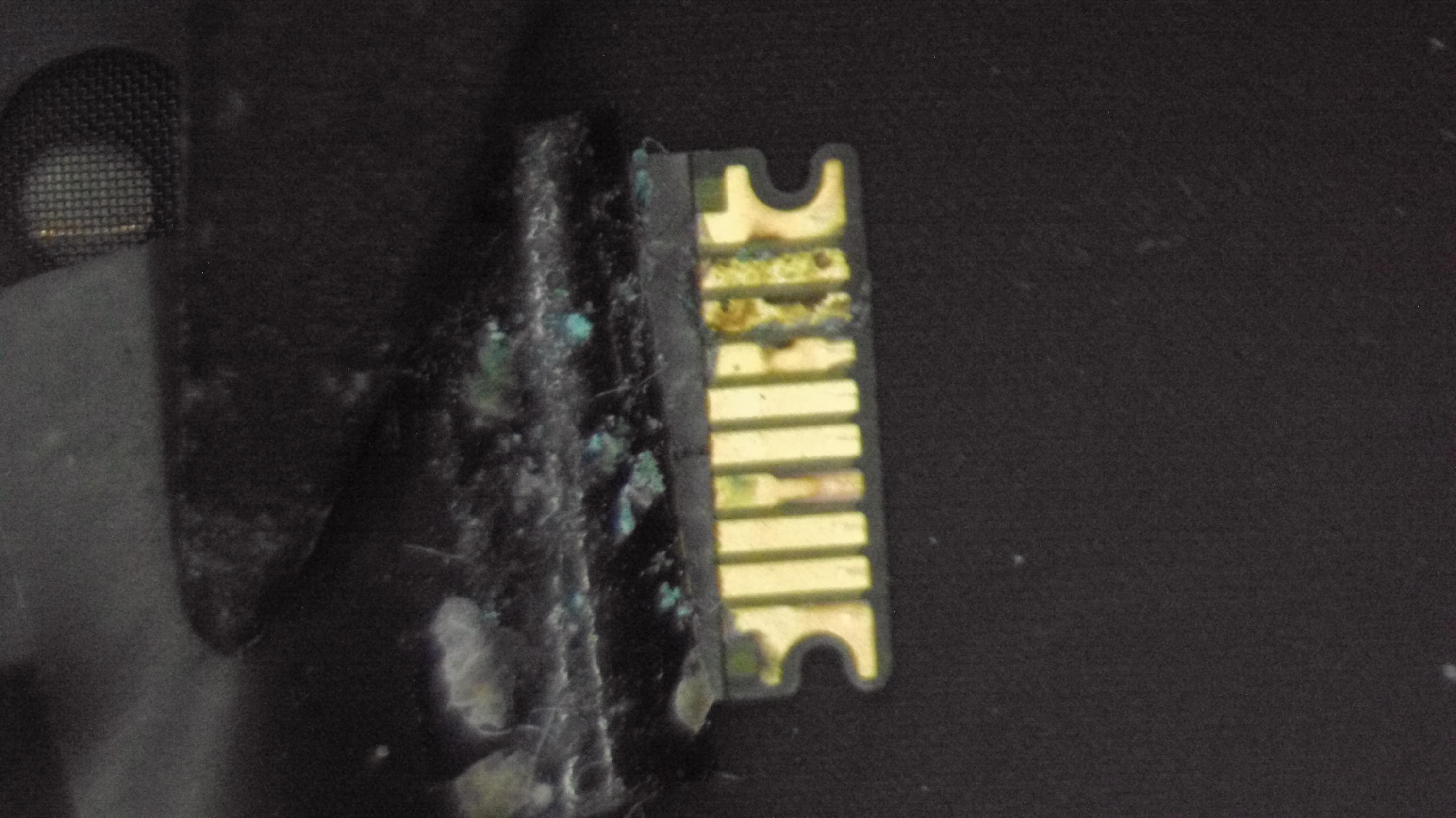

    Hey guys i just got myself a Macbook Pro 820-00840-a 2017, the seller said they had spilt liquid over it and since then it has never turned on.
    I am using a Apple 61W USB-C Power Adapter and USB-C Charge Cable and on my USB tester i can see when i plug into the power i get around 5.23V for about 2 seconds and then it jumps up to 20.43V and stays at 0.00amps. I am currently testing with the board out of the chassis disconnected from the battery and only plugged into the USB-C Charge Cable.

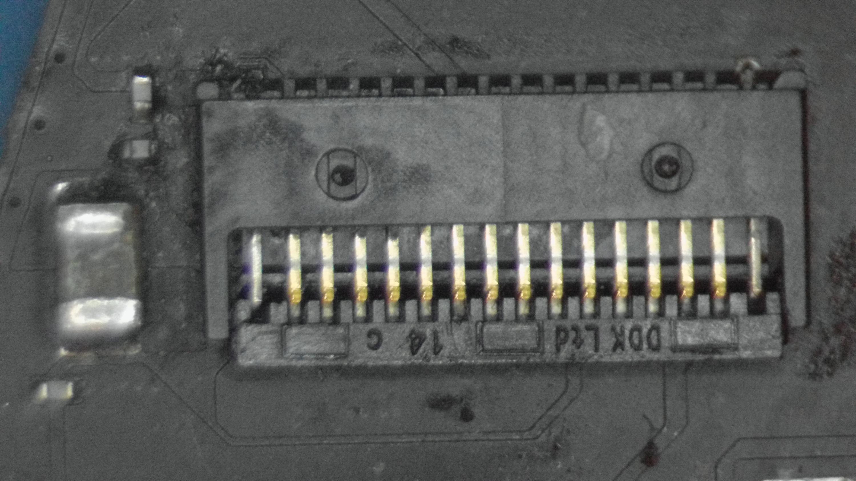

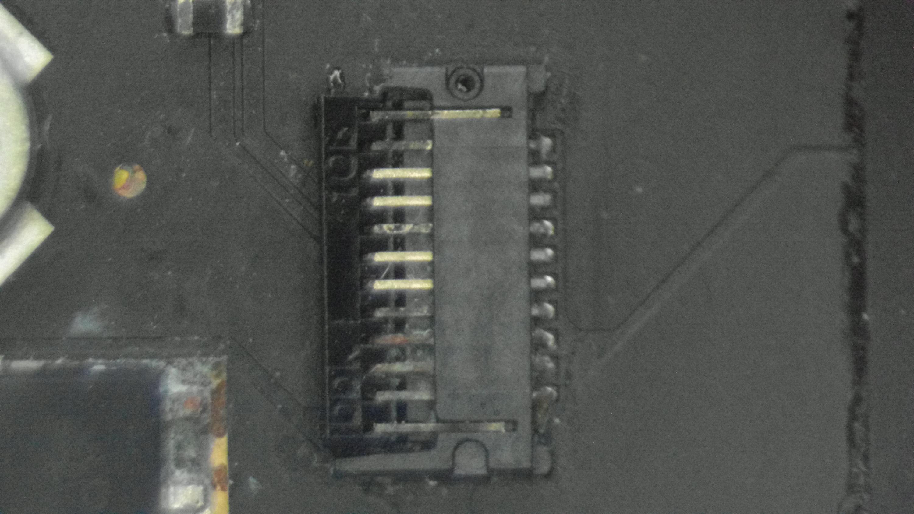

    I was greeted with some corrosion on the bottom of the board, 3 areas in particular that looked concerning to me.

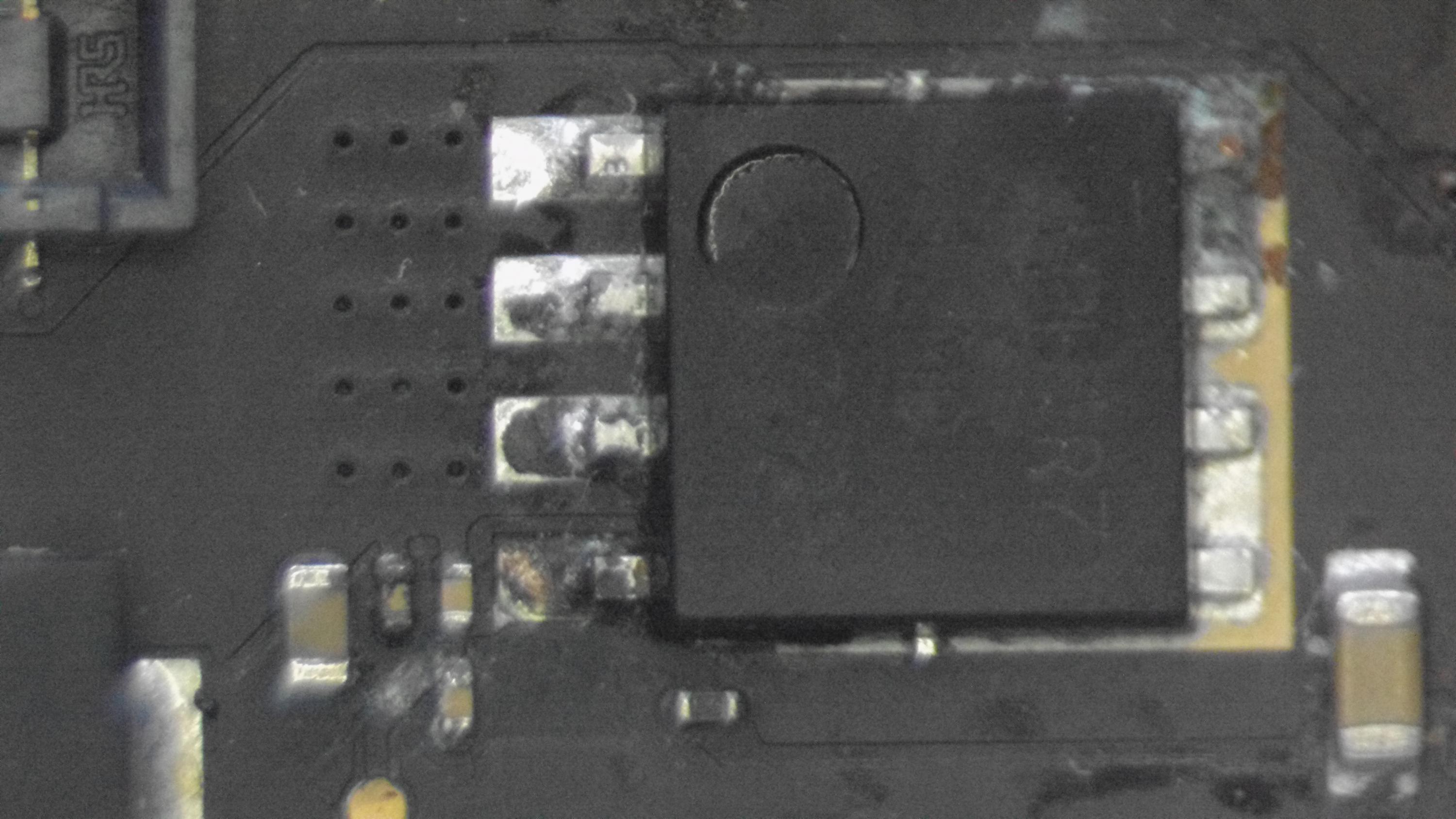

    First this J6951 connector with the cable detached and the Q7065 mosfet looking a bit worse for wear as well. I have cleaned them up they were much worse and this is the best i could get them for now, please see the images below:
    The good news is the top side of the logic board there is no corrosion or any signs of liquid ingress however when I was digging around and investigating why PPBUS_G3H is showing me 0V on U7000 (ISL9239) chip I noticed in the top right hand corner it has slightly blackened in colour and broken off, see the image below at the red arrow:
    I went ahead and measured capacitors C7065, C7066, C7067, C7068 and C7069 (Meter in diode mode, red probe on ground point and black probe to each side of the capacitors) and both sides are beeping (shorted), the capacitors are in circuit with Q7065.

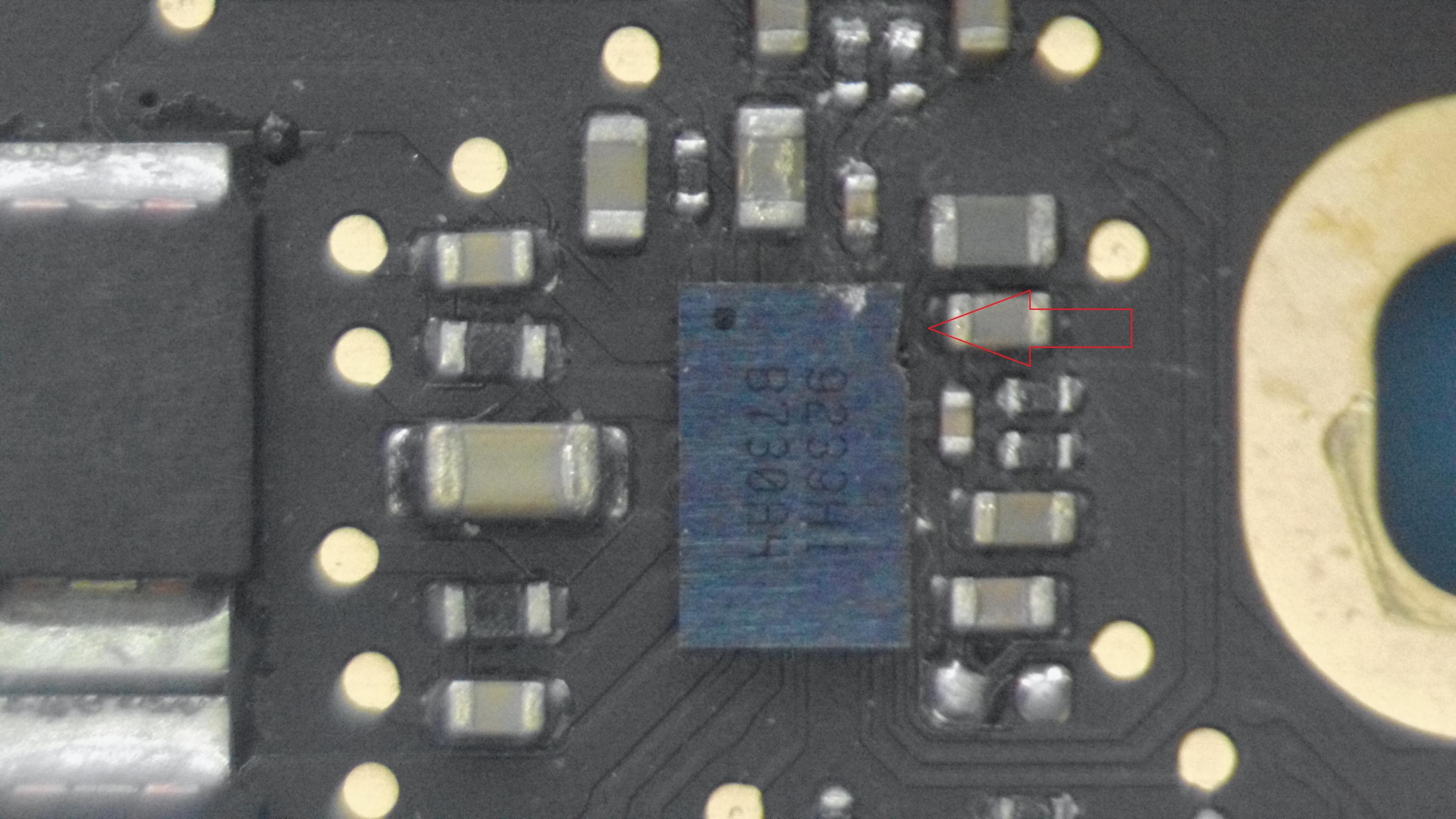

    My thinking on this is it could be the Q7065 or the U7000, i am leaning on the side of the Q7065 for now because PP3V3_G3H is being produced so the U7000 has PM_EN_P3V3_G3H signal. But i realise anything’s possible here (liquid).
    What are your thoughts on this? I am thinking first to reflow/replace the Q7065?

    1) Clean up the FPC cable contacts with alcohol.
    2) The mosfet is sharing pins 5-6-7-8 and looks to be ok but again, use IPA to clean it up as much as possible.
    3) The ISL9239 looks to be chipped and may be damaged but ignore that for now.

        I have cleaned up these about 3 times with cotton buds/ISOPROPYL ALCOHOL 99.9%. This was the best i could get it at the time.
        I will try again one more time for good measure.
        Ok.
