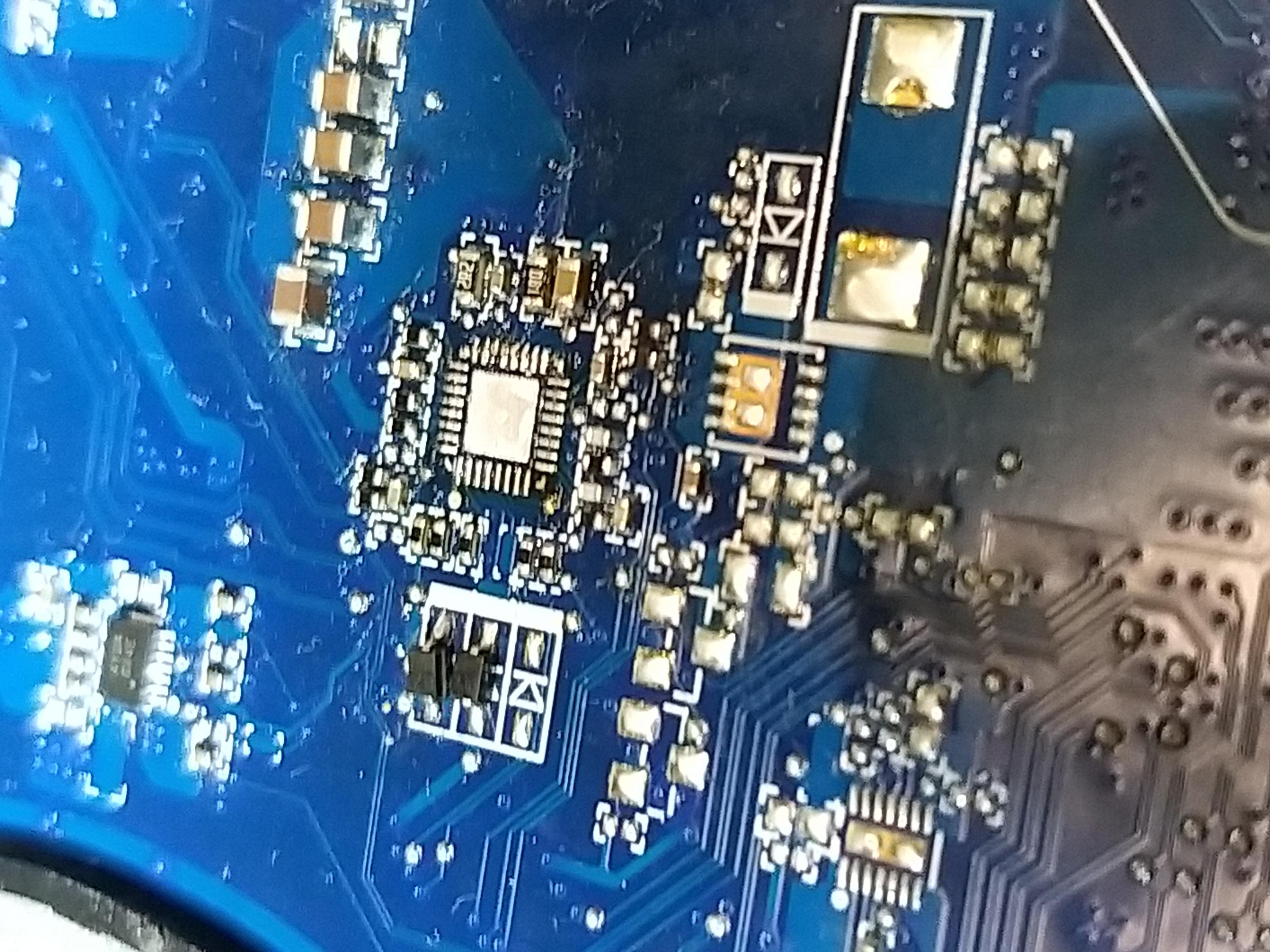

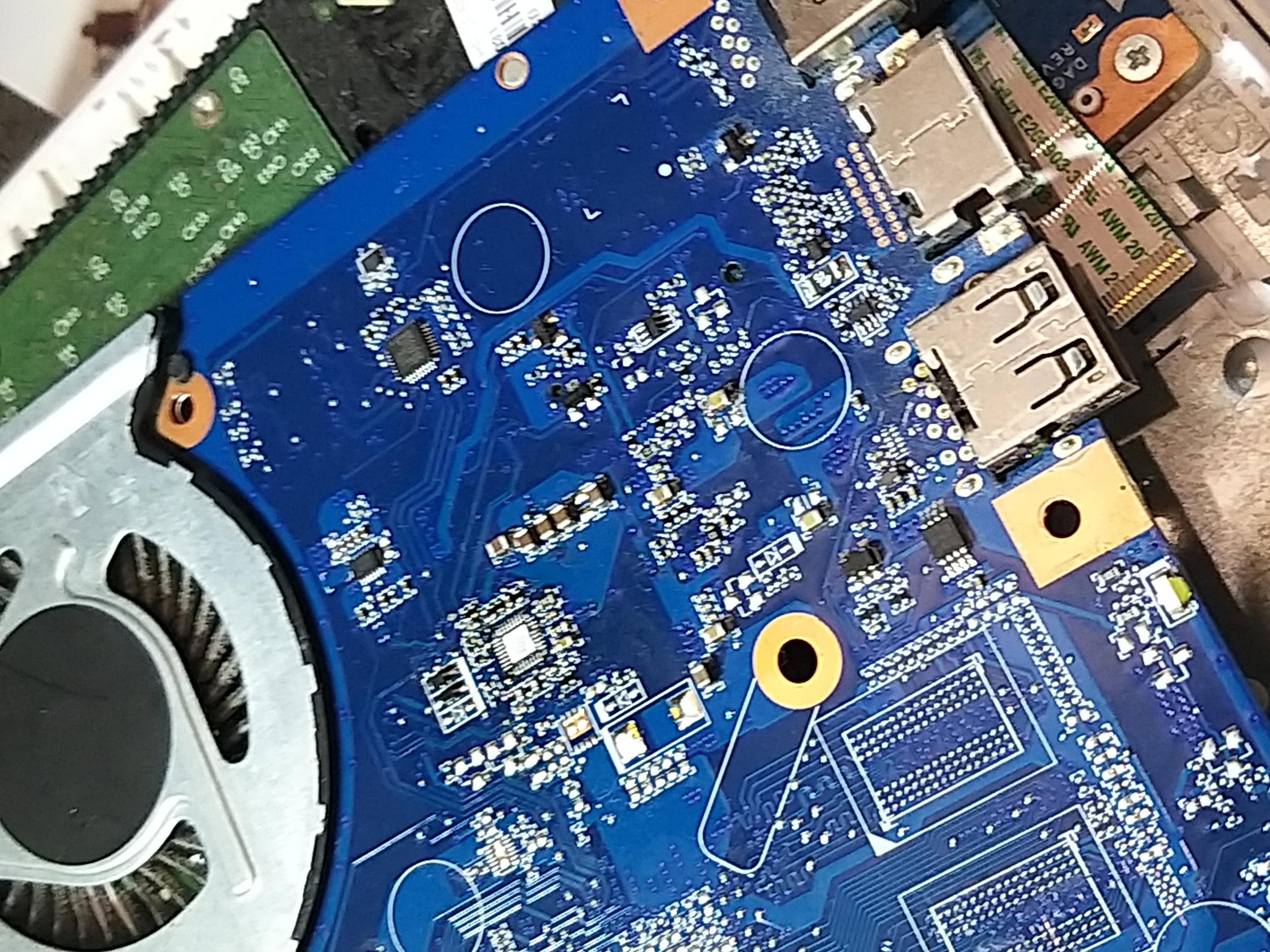

    I have a blown 32pin ic on this board that is marked 750 ..hz from what I can make out Im assuming this is MHZ? The chip is damaged so I can only read it partially.
    It must the battery charger ic maybe?
    Can someone help me identify this chip so I can find a replacement?!
    thnx

    Post a clear picture of this device.
    Any other silk screen markings on the logic board ?

      Yes that is likely to be ISL750HRZ-CHARGING IC.

        hi here are the clearest pics I could get ..Are these ok.?
        the chip has already been removed.

            any suggestions for a suitable substitute for the chip?

              https://www.aliexpress.com/wholesale...psort=1&page=1
