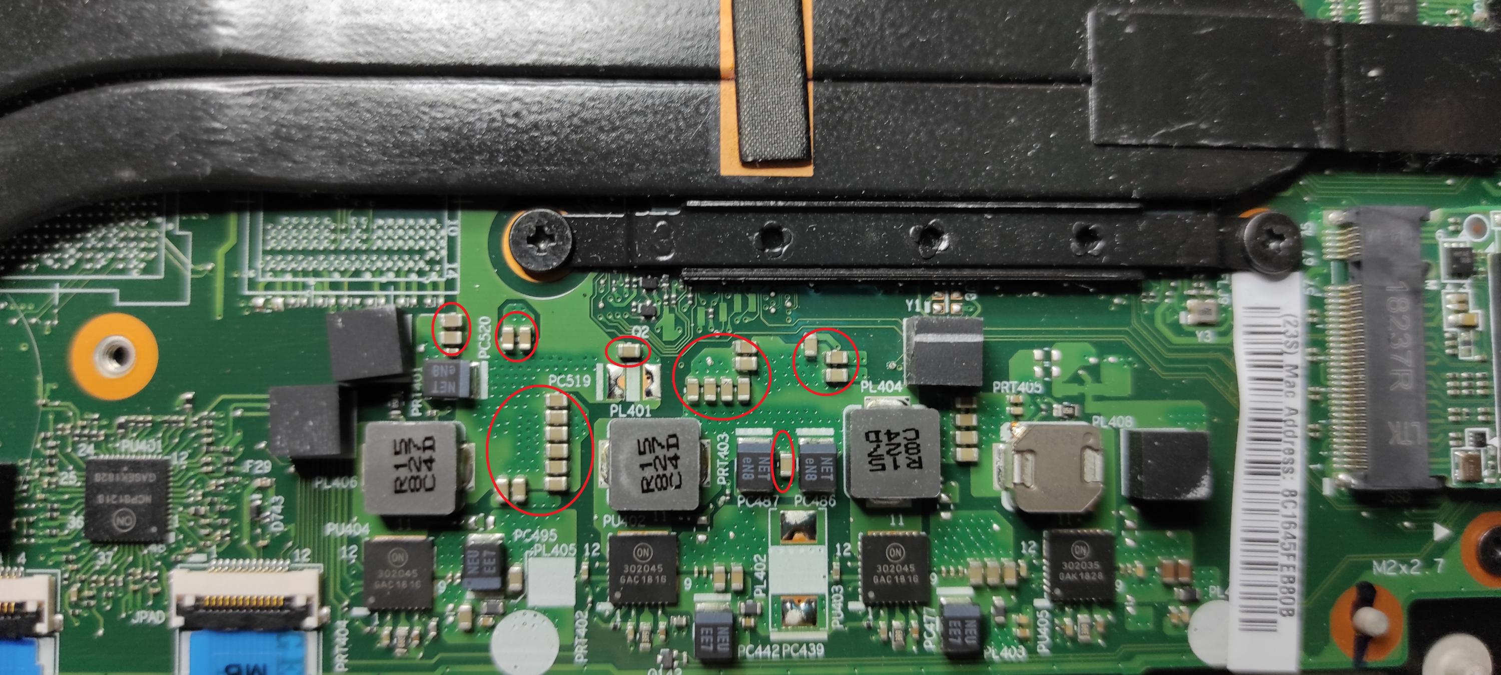

    Hello!
    Today i received a T480s that is completely dead, the MB is quite sophisticated from what i'm used to repair (4th and 5th gen) so i need your help before i touch anything.
    No liquid damage, no visual damage at all.
    All caps in red square are shorted to GND, not sure what and if means something.
    I'm all ears
    Thank you in advance!

    Re: Lenovo T480s completely dead
    How do you define a short? (In ohms)
    Do you have a USB-C tester?
      I set the ohmeter in beep and it's beeping in both sides, when i set it on Ω i get 0.4Ω in one pin and 8Ω on the other.
      So propably no short.
      If you suspect the charger i have tried multiple but no luck.
        This model has a known thunderbolt controller issue, the firmware of it gets corrupted. So USB-C tester might give an idea if the USB-C controller is communicating with charger and receiving full 20V. You can measure it with multimeter, but you have to find a spot where to take measurement.
                        Start with basics as usual, PU201 - VREG3/5, how much current is drawn...
                        But i suggest to purchase USB-C tester anyways, it is cheap and gives useful info about power consumption.
                            PU201 has no voltages at all, all 20 pins are 0v

                              Check the fuses and mosfets, on page 70 .
                                PF1 and PF2 are fine.
                                  PF2 fuse reads 5v on both pins, however PF1 shows only 0.4mv.
                                  Perhaps a problem with upper mosfet?
                                    PF2 is most likely fuse for USB-C port input and PF1 is fuse for docking port. So it is normal that PF1 is 0.
                                    As PF2 has only 5V you have a problem with USB-C controller and charger not communicating. They should bring it up to 20V. You can try the docking port, does it give higher voltage (on PF1 then). This may be a port problem (visual check?), comm lines to PD controller, PD controller, anything else sitting between them.
                                      I asked a friend to brink a dock the next days, meanwhile how can we proceed?
                                      Visually everything is perfect, like new.
                                      Charge port is in excellent condition too, i measure 5v in some of it's pins, nowhere 20v.
