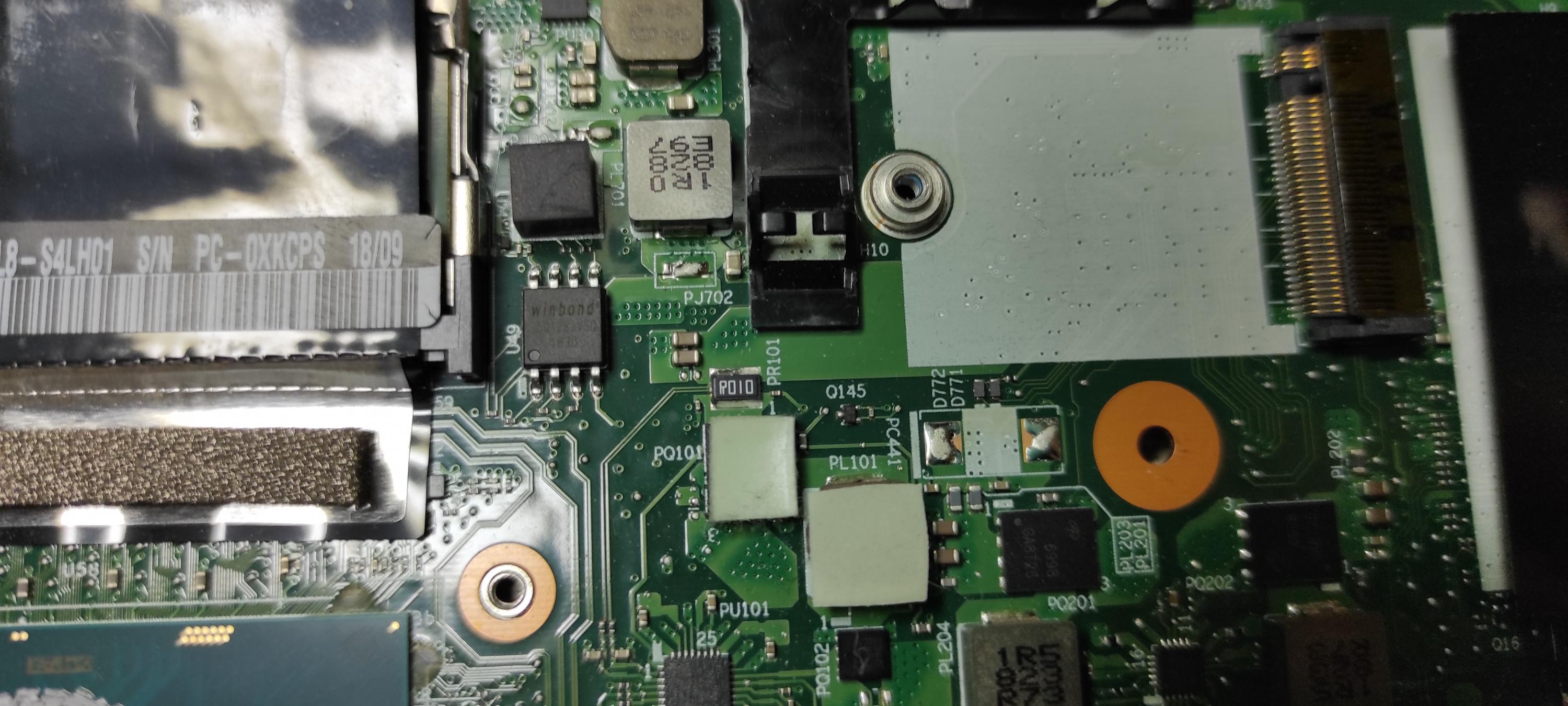

        Re: Lenovo T480s completely dead
        Which one of these two is the PR101?
        I suspect is the large black SMD labelled as R010?
        • khaahk
          • Dec 2013
          • 756
          • Estonia
          #44
          This is it.
          • Andreasbest
            • Aug 2014
            • 1152
            • Hellas ( Greece )
            #45
            Ok, desolder the PR101 and the resistance on side of PQ101 is high, the other side remained on 7Ω.
            • khaahk
              • Dec 2013
              • 756
              • Estonia
              #46
              Which side remained low resistance? Inject 1V and 500mA into the low ohm side and look for heat, increase voltage slowly, also current until you find the heat source.

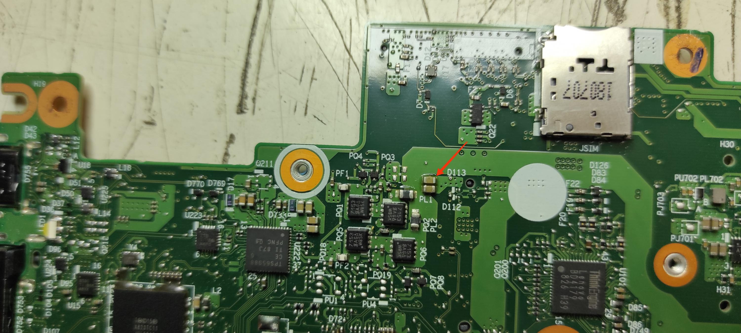

                      • Andreasbest
                        • Aug 2014
                        • 1152
                        • Hellas ( Greece )
                        #51
                        Ok i found the guilty, the capacitor on the picture is shorted.
                        Desolder it and the resistance on rail returned to several MΩ
                        Now should i replace it or not?
                        • khaahk
                          • Dec 2013
                          • 756
                          • Estonia
                          #52
                          You can test without it, but should be replaced to be sure.
