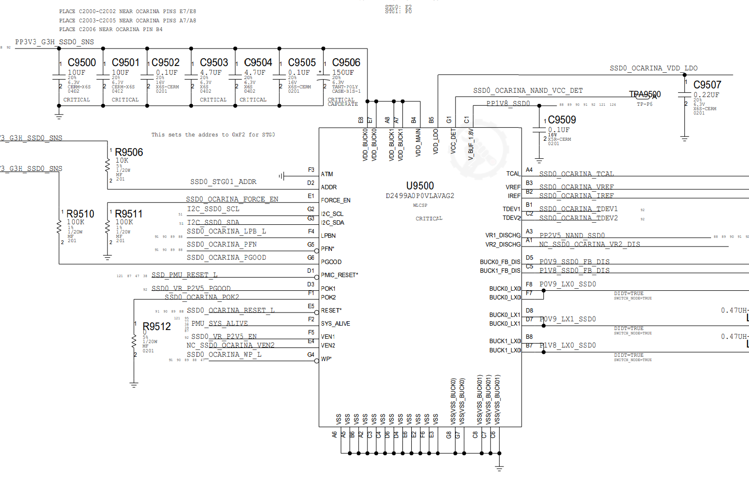

        Thanks, after giving that a read my 0V9_SSD is 0.00v, and has a 0.342 diode reading. It goes into DFU mode without having to press any keys, it happens when the board is outside the case disconnected completely. Is there something on the board that can do that?
        My AWAKE and SLPS all look fine I think:

          After more researching it appears U9500 controls U9580 via the SSD0_VR_P2V5_EN which on this board is always 0v, would this mean the U9500 is having issues?

            Yes, it may be. Confirm the presence and voltage of PP3V3_G3H_SSD0_SNS.
            • powerblackout
              • Feb 2018
              • 109
              Re: Macbook 820-01700 Stuck at 5V
              PP3V3_G3H_SSD0_SNS is present, 3.38v.
              I didn't realize there was another set of these for SSD1, I checked these two
              SSD1_VR_P2V5_EN - 0.0v
              PP3V3_G3H_SSD1_SNS - 3.38v
              What are the chances that both U9500 and U9000 are broken? Or maybe I need to look further upstream for something that controls both of these?

                      Do you know what controls the creation of the 0.9, 1.8, 2.5v from this chip? I checked SSD_PMU_RESET_L (1.8v), is it controlled via the SCL/SDA communication?

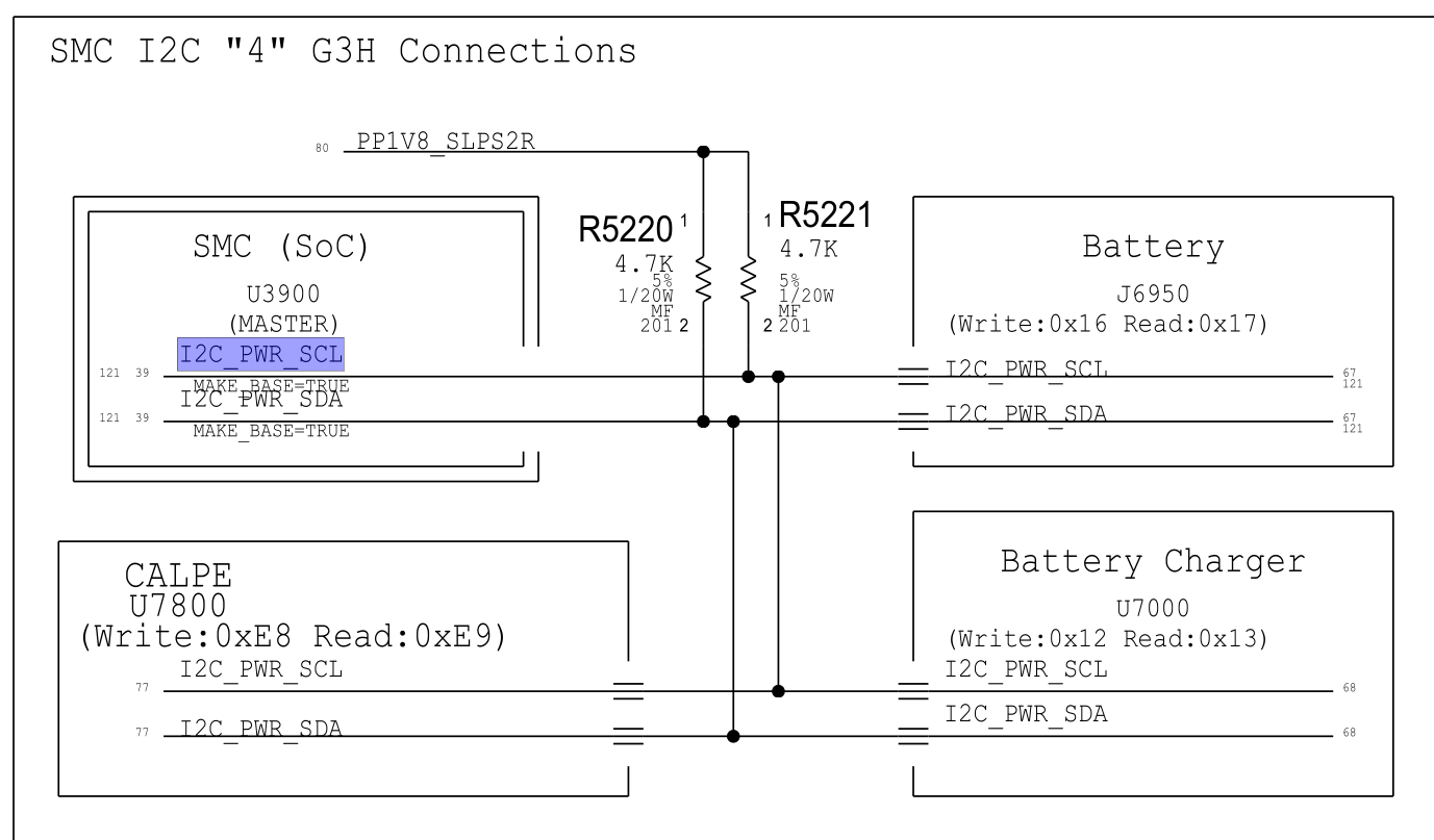

                        Another discovery. I hooked my oscilloscope up to I2C_PWR_SDA and I2C_PWR_SCL lines going to the charger, i see them go up to 1.785v but they do not have any traffic on them. I see i2c is controlled by T2 chip, this would suggest why battery isn't charging and why U9500 isn't turning SSD on? because T2 is messed up and not communicating over i2c?
                        Another discovery! I put the ammeter between the two machines, when the revive process starts the ammeter reads 4.93v 0.2a, and the T2 chip gets to about 80 F while the rest of the board is at 70 F. While it is doing this the PP2V5_NAND_SSD0 etc are still 0

                            U3900 (SMC) is the I2C bus master and the voltage readings for I2C_PWR_SCL and I2C_PWR_SDA look good.

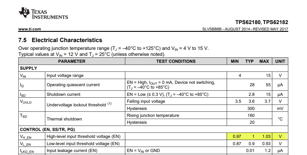

                                    Technically, these are enable pins for the local 2v5 regulators. If the resistance on this rail is not low, then you could in theory, remove the series resistor (R9098 for SSD1; R9598 for SSD0) bridging the driver & this local TI regulator -> then hard strap the enable pin to be logic high to force it always ON. This in turn should turn on the regulator to power on the SSD (of your choice).
                                    The enable pin will consider a voltage > 1V to enable. You can strap the ENABLE pin to 3v3 on the board.
                                    If you decide to do this, ping back so we can agree on a proper location for this rail.

                                      SSD1_VR_P2V5_EN - 3.2 megaohms
                                      SSD0_VR_P2V5_EN - 3.1 megaohms
                                      Yes I could force enabling the pins to see if the SSD even works. Would this be a permanent solution?

                                        First, I would test it but gathering that with the power rail always enabled, the battery will drain faster.
                                        However, this could be a case of the chicken and the egg - you need to manually enable the SSD so that you can restore the T2 firmware and after this is resolved, apply the series resistor back onto the logic board and test again.
                                        In theory, this may be the resolution. Very curious and wanting to hear of your success.
