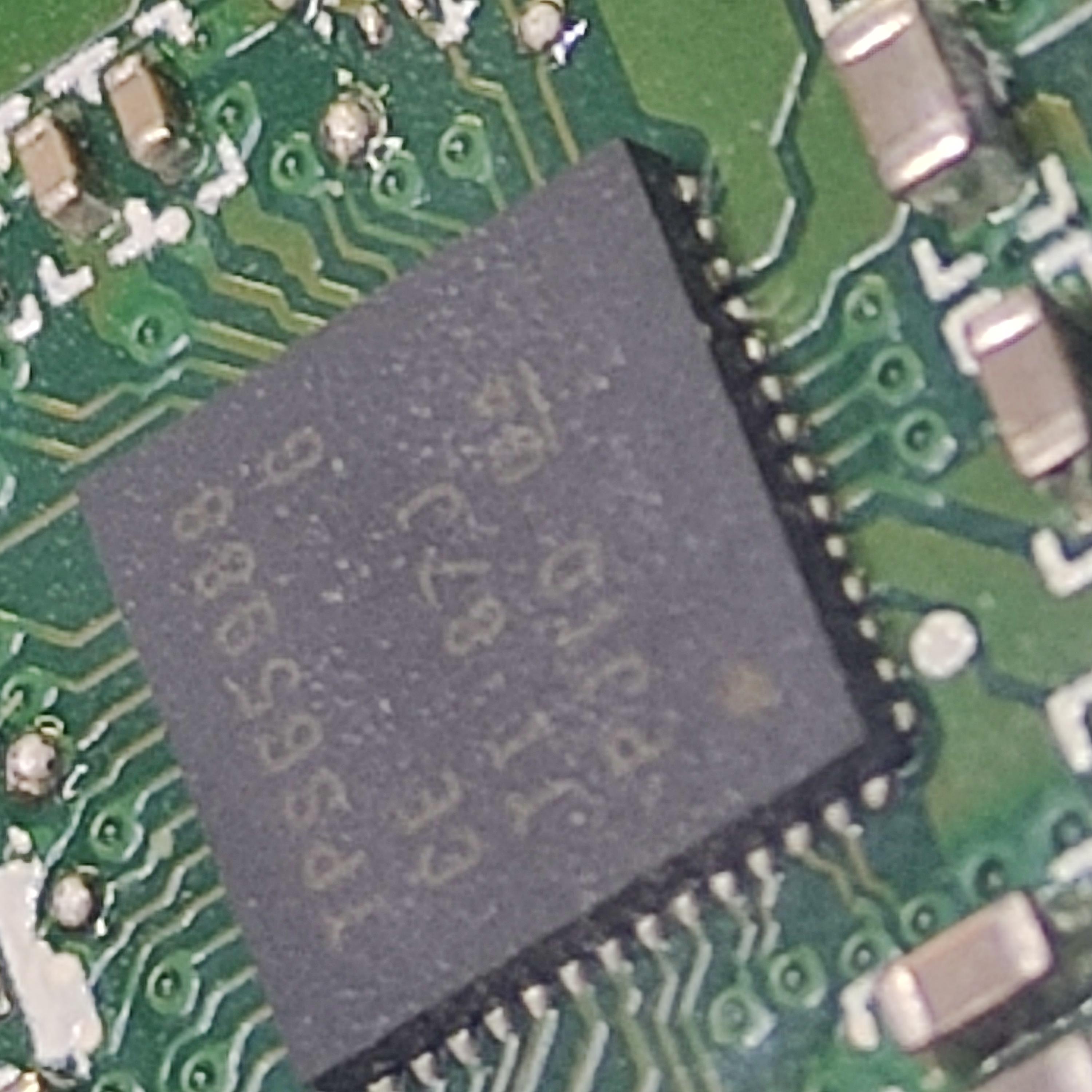

      Yes iv got the tps65988ce which is marked on the ic as ptps65988ce G TI 78J P4L2
      The original says tps65988ce TI 94J P0Y8 G4
      This is the closest version I can find anywhere, so presume it works?.
      I have a usb amp meter, it reads 0.07mah every few seconds.
      Is there a specific supplier you suggest for the ic that works ?.

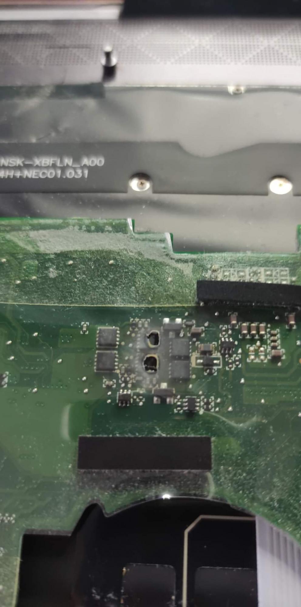

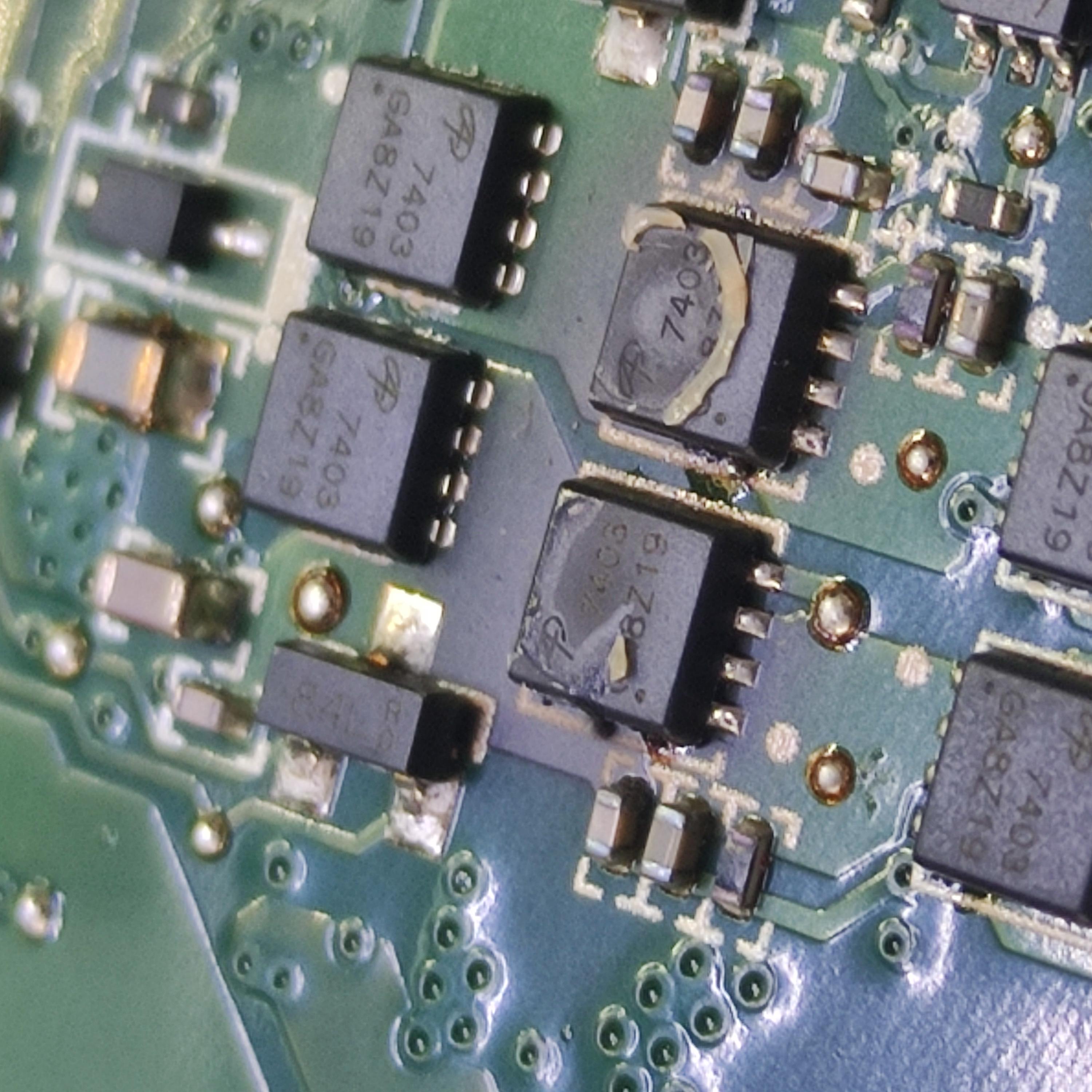

                      Just had a 13-AP0000tu come in with a DA0X36MBAE0 motherboard. Fault presentation was not charging. The rear USB-C port on the corner, only +5V negotiated when cable plugged in both ways. The other side mounted one, dead in one orientation, 20V negotiated on the other but cutting out if cable was disturbed. It did charge, but I noted current would go up to 3A, then back down to 200ma in a cycle.
                      Removed the board, there are two AON7403 FETs shorted, visible since they had melted the plastic PCB cover. They were fused to the board and couldn't be removed. Board had begun to carbonise so likely I'd end up with a short between layers if I went any further.
                      The one working USB-C port was flakey, and probably needed a replacement TPS65988CE IC. There's another controller in there that appears to connect to the USB ports as well, but cannot locate what that is. Deemed a no fix as multiple faults. Images attached as reference as no schematics.

                        Applying a lot of bga flux and solder on mosfet and holding 2 knife edged tip solder iron on both sides will perhaps remove them. Or you can break the top part of mosfets with surgical knife and then hold the knife edge solder iron on them. They will come out easily.
                        • reformatt
                          • Feb 2020
                          • 1496
                          Re: Hp spectre x350 DA0X36MBAE0 no power
                          Yes true, however have no boardviews or schematics if things go awry. Would also have to replace at least one USB-C port and run jumpers for ripped pads too. Effort vs cost customer is willing to pay is a factor so decided not to go ahead with it.
