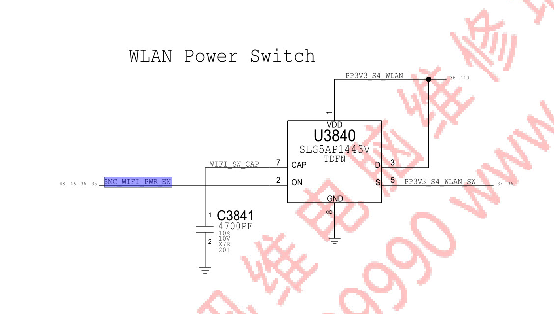

                Re: Help! Macbook A1707 turn on without image..
                You may have flexgate issues but cannot be sure since you have the display visible with a flashlight.
                For sure, your backlight is not ON.
                Check and post the voltage readings for:
                1) F8400, pin # 1. This should be PPBUS_G3H. Value ?
                2) F8400, pin # 2. PPVIN_S0SW_LCDBKLT_FET. Value ?
                3) PPVOUT_S0_LCDBKLT.
                On the WIFI not working:
                4) PP3V3_S4_WLAN_SW
                5) PP3V3_S4_WLAN
                6) SMC_WIFI_PWR_EN
                  HI DEAR MON2
                  video works now, it was flex problem
                  now i don't have wifi disabled, but ok bluetooth
                  here the values :
                  4) PP3V3_S4_WLAN_SW : 3.0VOLT
                  5) PP3V3_S4_WLAN : 3.2VOLT
                  6) SMC_WIFI_PWR_EN : 3.2VOLT
                  thanks

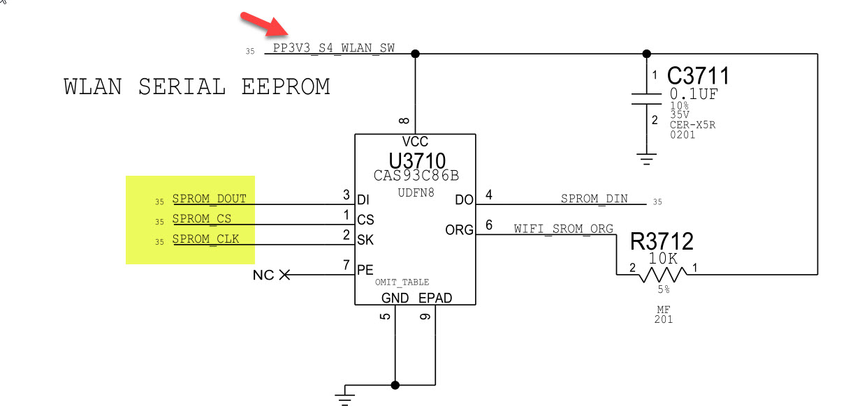

                        hi.
                        1) voltage of PP3V3_S4_WLAN_SW ?
                        2) check and post the voltages on the WIFI rom (see attached).
                        3) from the schematic, it appears that the bluetooth (BT) and WIFI functions are supported by the single module. That is, if BT is working then WIFI should be possible as well. Just that the BT and WIFI functions appear to have different and independent power rails.

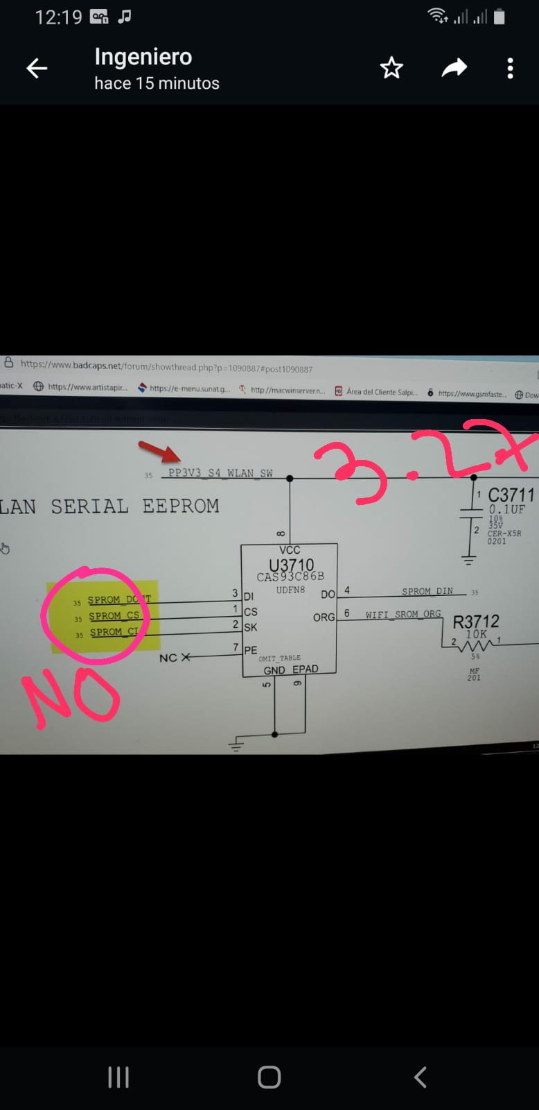

                          hi dear MON2
                          happy year 2022 first
                          1) voltage of PP3V3_S4_WLAN_SW : 3.27VOLT
                          2) check and post the voltages on the WIFI rom (picture add) not have volt.
                          3). BLUETHOOTH WORKING. BUT NO WIFI
                          THANKS
                          • mon2
                            • Dec 2019
                            • 14673
                            Hi. Happy New Year to you as well.
                            The Vcc is a good voltage to power the WIFI flash memory device.
                            However, no voltage on the SPI interface pins is odd. Perhaps others can comment on this area. Perhaps the SPI flash rom is only used during first power on and then no activity after the boot cycle?
                            If possible, try to measure or check for activity upon first power on.
                            Here a low cost logic analyzer could be helpful.

                                  HI DEAR will this?
                                  https://logi.wiki/index.php/T1_MacBo...IC_Replacement
                                  NEED REMPLACE IC U3710
                                  • mon2
                                    • Dec 2019
                                    • 14673
                                    Interesting link on WiFi details.
                                    What does the WIFI screen show for your logic board?
                                    Can you post the screen pic to compare with the linked page?
                                    The reference page implies 3 devices must be replaced as they are paired.
                                    The eeprom (flash) that has no voltage on the SPI pins is rather low density. It must be to store scanned access points, mac address, etc. Nevertheless, it is important.

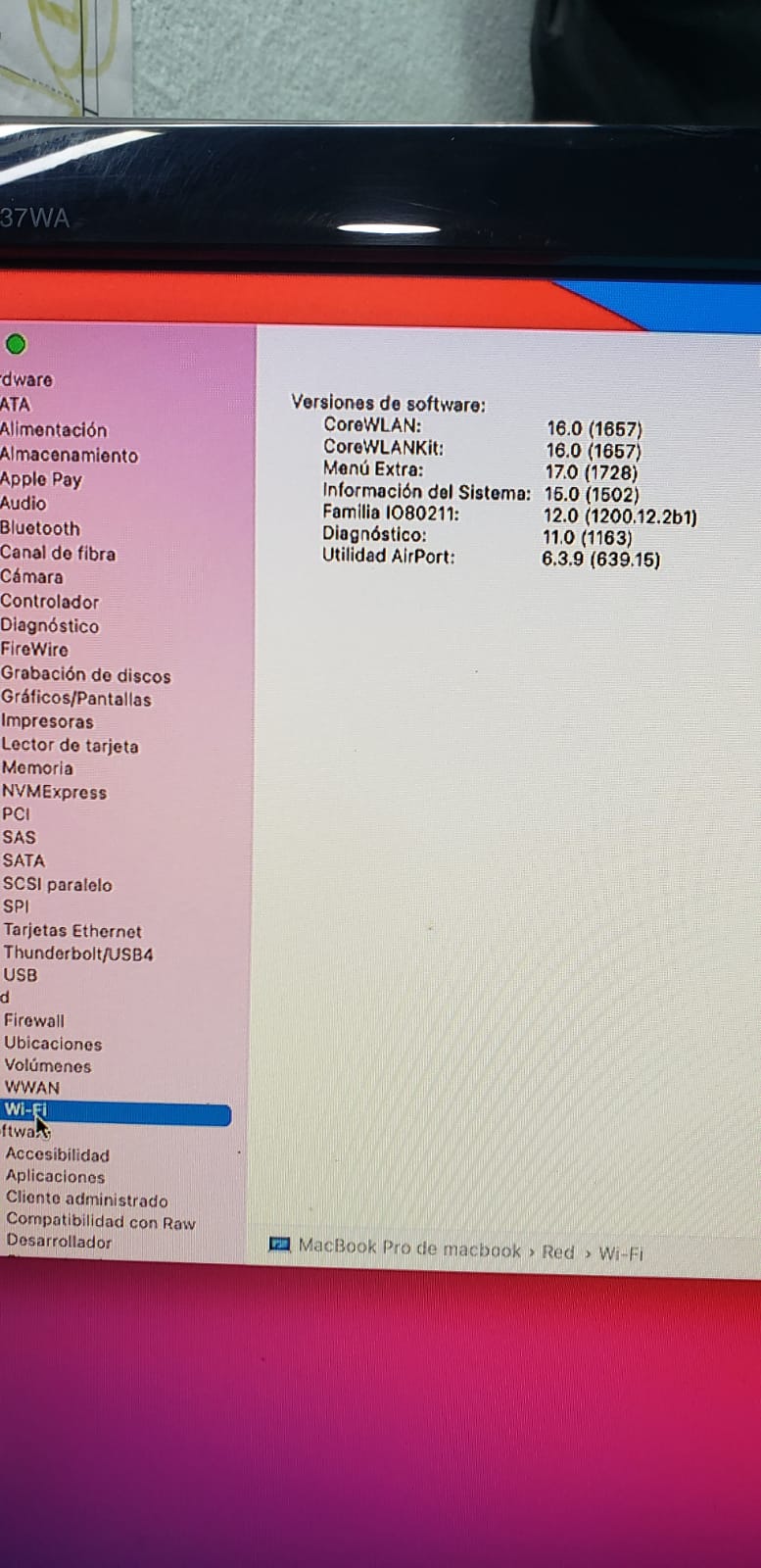

                                      Hi dear.
                                      Add picture. Wifi working. But no search red
