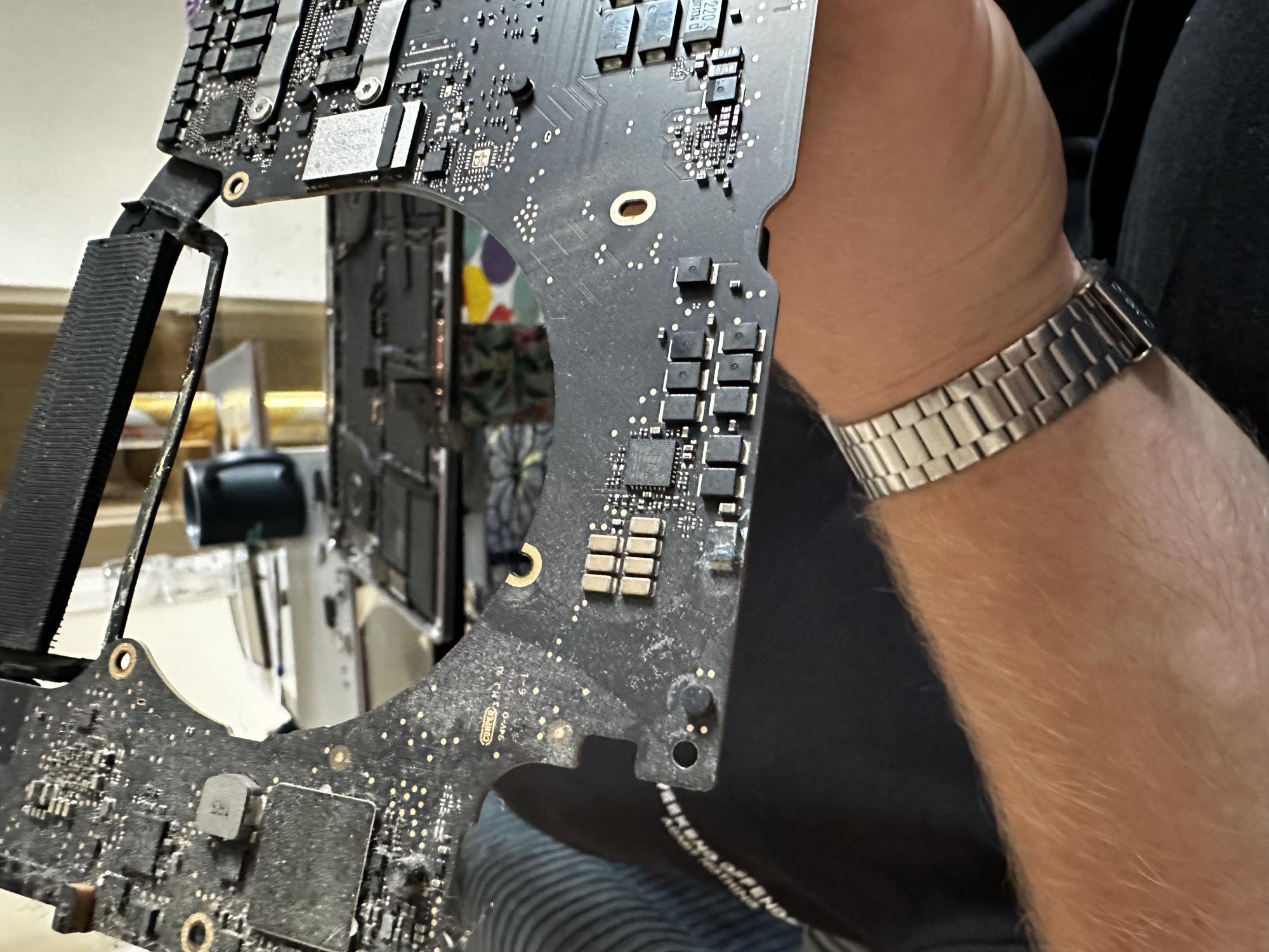

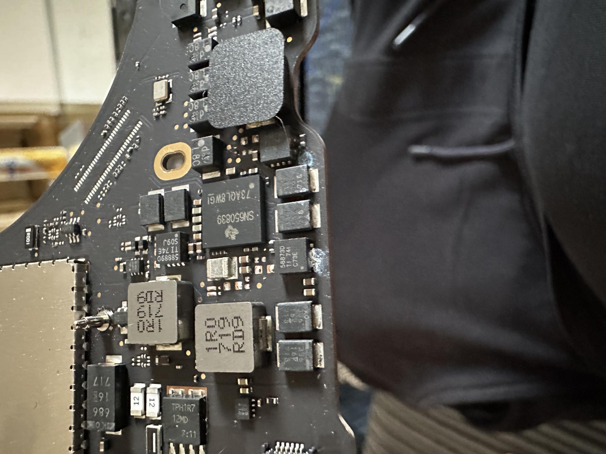

    It had a water damage on couple components, green staff corrosion,
    C7680 ppbus _hs_oth3v3, tested for short I believe its okey red prob on ground, getting 2.512kilo om
    C7251 ppbus_hs_cpu done the same and getting about the same, 2.506kilo om
    U5400 some corrosion, I clear all this places as much as I could with an isopropyl alcohol and tried to power on to see what is going on.

    Hi did ypu reflow the area where was corrosio do you have pictúres from the area with corrosion it can be thatpads from area where corrosion was not making good contact anymore.

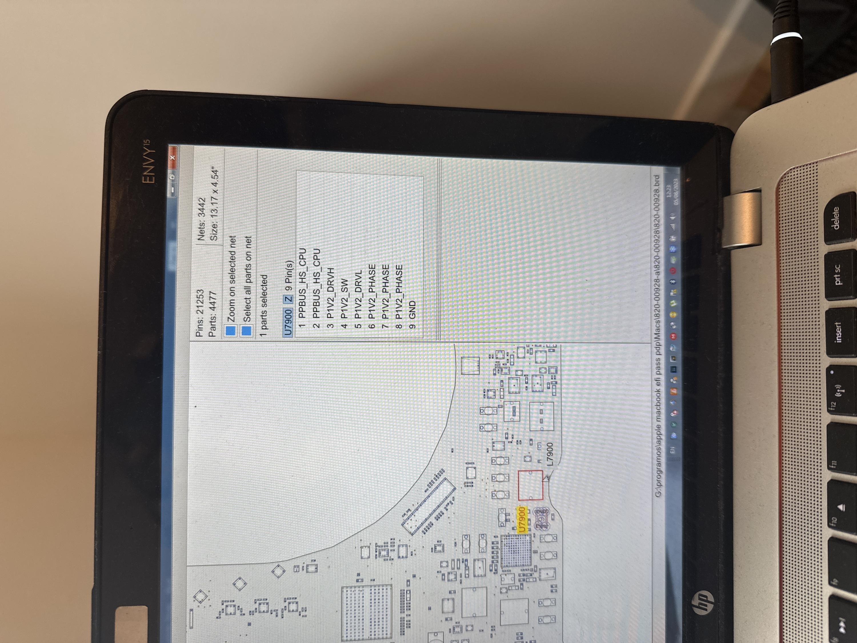

      sorry made a mistake it wasnt u5400 it was u7900 my bad sorry for misleading information i uploaded a picture before and will add what is looks like now
      i reflow the u7900 so on the pin 1 i am getting 12,56v on a pin 8 1.2v looks okey . to me

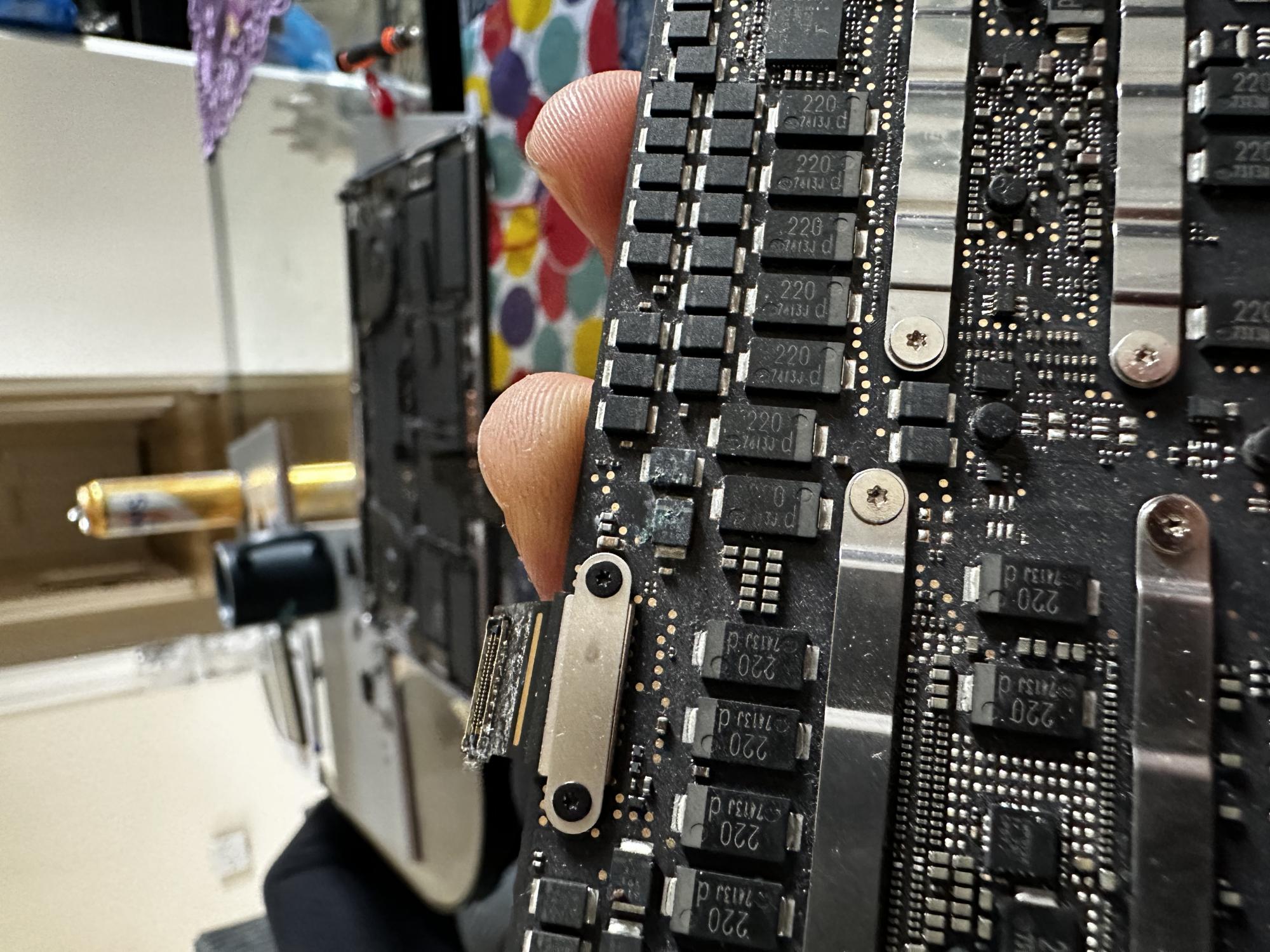

                          • spidertnt
                            • Jul 2016
                            • 34
                            Re: Macbook Pro 15" A1707 820-00928-04 no chime,no boot,no image 19.92v 0.900a
                            Originally posted by gugutm
                            no i did not reflow it i might need to do it
                            second picture looks like possible burnt pins on the flex display connector ?...when this happens the screen side connector also needs replacement.
                            The burning usually damages the GMUX chip and it will also need replacement .
