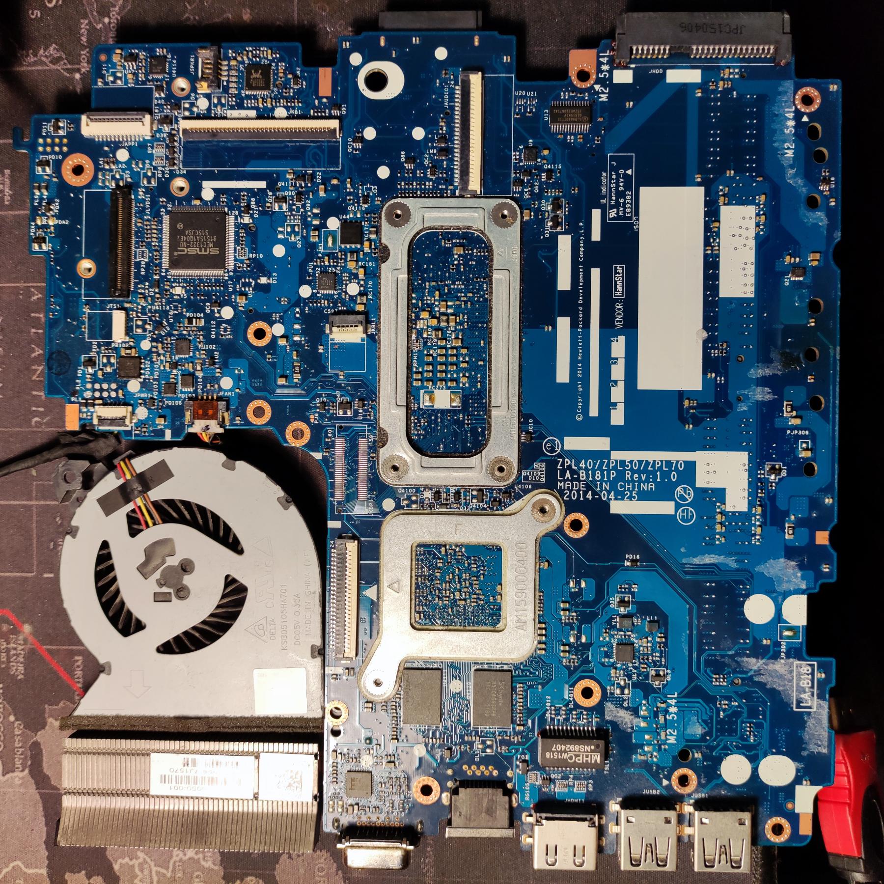

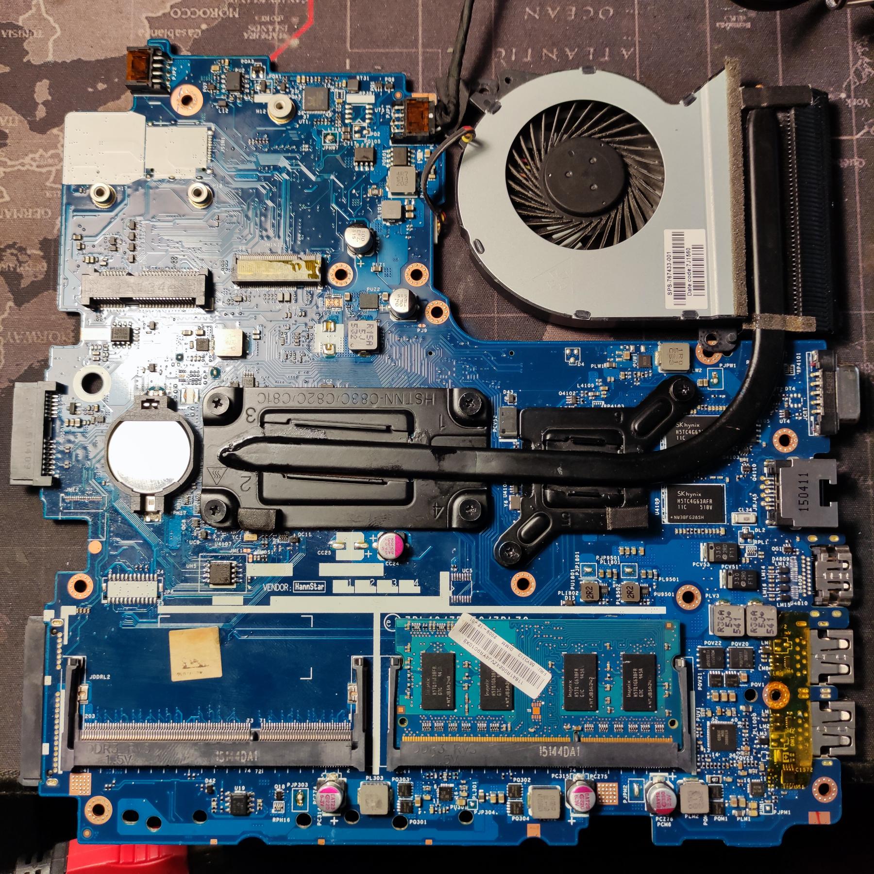

    Hello!
    Today i got a laptop that prior work has been done it the BIOS chip was removed, and 1 capacitor wasn't connected .
    So i re-purpose those .
    Now, when you plug in the charger, the "light" on the board itself (as you may now its a white blink led) , it will sudden rapid turns off turns off, like flickr , not the general code ,as we now (with beeps or indication lights).
    Just flickrs for a split second and cuts off.
    No power on ,no fan spin , nothing i suspect something from mosfet , with somewhere to be problem with ground.
    But my main furstration is that as soon as you plug in the charger, i cannnot measure not even with ground the charger it self, i mean you have 8 points that the DC Jack goes to on the board, i plug the multimeter (negative) to a hole/ ground and the red wire to , establish a connectionwith dc-jack and see how much volts are coming in .
    But nothing is coming in ...
    (The charger is 100% working without problem etc. tried 2-3 different chargers).
    So i suspect the protection goes on ?
    I don't know where to begin.

          When i press the power button i have to squize it a little more than general , and you can see the white light comes on , but keeps blinking...
          Tried good RAM (DDR3L + DDR3) both working 100% , just in case this was the problem.
          But again nothing.....

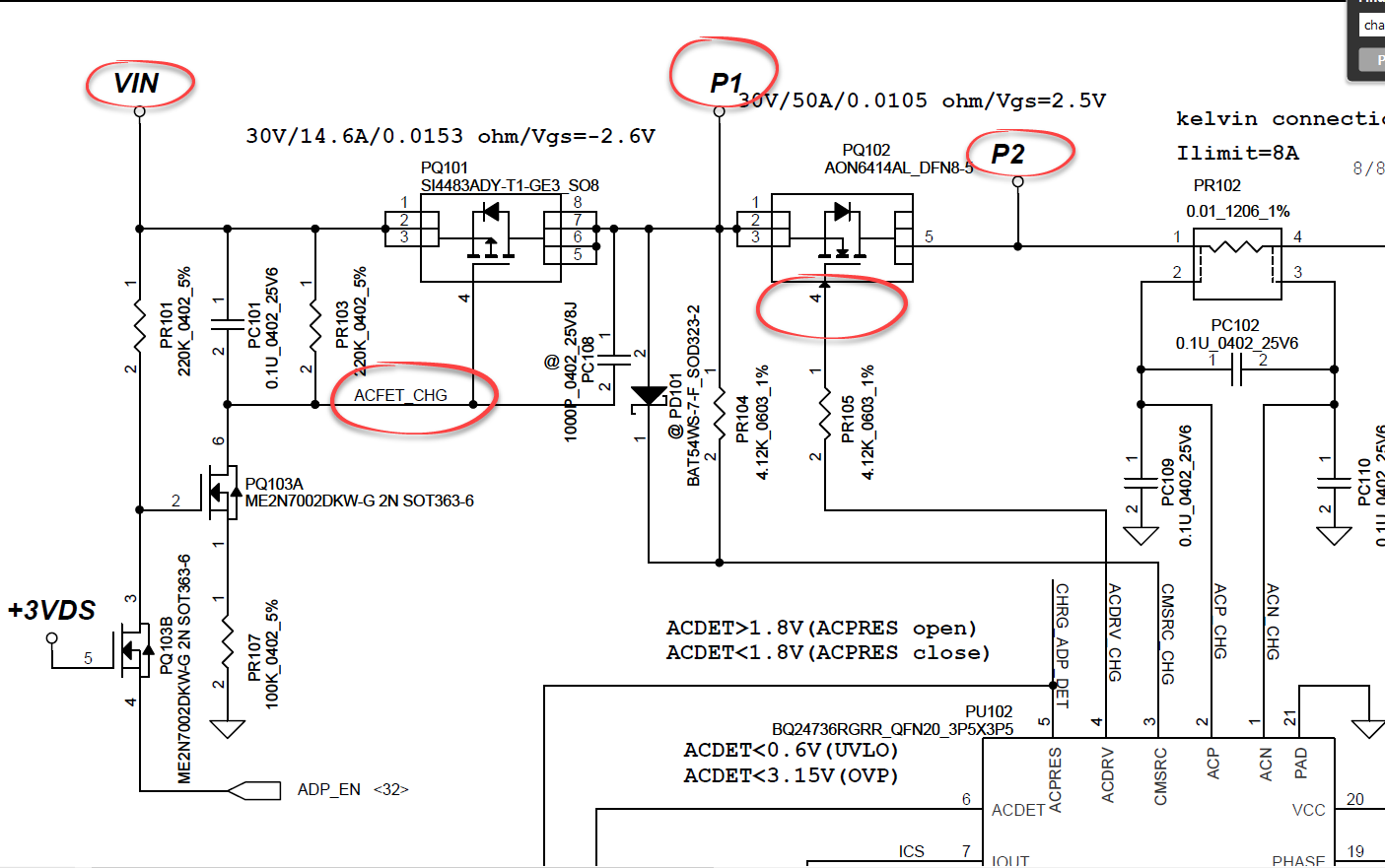

            Re: Hp 470 g2 - la-b181p
            From the internet, white blinking light means low battery detected. For now, remove the battery.
            Does the vin rail from adapter remain stable when connected to the logic board? This is the first interconnect to the board.
            When logic board is on, can you measure the voltages at each coil to ground?

                          If i am getting it straight ( as you understand still learning ) .
                          You want me to measure the points : PQ102 ,PQ101, PR102.
                          Correct?
                          • Acnologia
                            • Dec 2016
                            • 421
                            • Poland
                            PQ 105
                            Entire one side has 2,53volt
                            The other side 19,65 volt
                            all stable measurments
                            PQ101
                            Entire one side 19,65
                            Entire other side 19,65 except last pin 6,12
                            PU102 and PQ102. I draw them here
