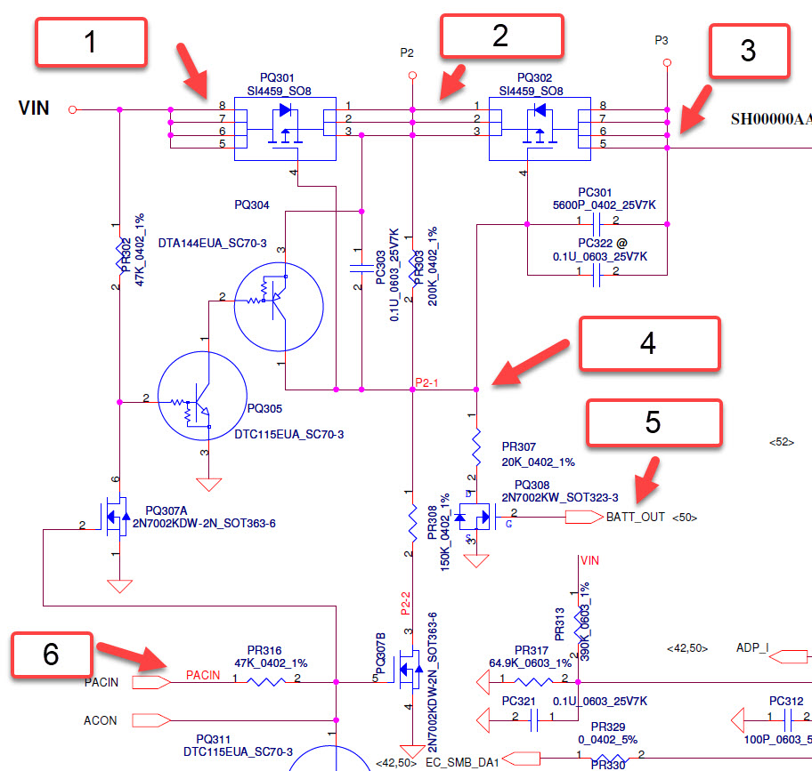

    I have a Lenovo Y580 board which works fine on battery power, and the battery charges normally with a charger. The issue is when the input is from the charging port. The charger used is perfect and is in use in another Y580 laptop
    the 19v comes into the + of the charging port and enters the first mosfet PQ301. Voltage on the other side drops slightly (by .5v), and enters the 2nd mosfet PQ302. The voltage on the other side, and thus at the main power rail current resistor at PR301, is 0.9V. However, the main power rail is NOT short at this point (as also evidenced by the fact the board works fine off a charged battery).
    Thinking this was an easy fix (the 2 mosfets mentioned above must be bad right?), I changed them over with 2 other p-channel mosfets (AO4435) off an old board, fully expecting the problem to be fixed, but NO CHANGE. Still 0.9v on PR301.
    I then changed the battery charging chip PU301, which made no difference either.
    I do have access to a good board, but couldn't work it out by comparing the 2.
    What is clear is that on the good board, the voltage that comes through on the + of the charging point is identical to the voltage on the current resistor at PU301, so on the bad board, something is already wrong as the voltage drops .5v after the 1st mosfet
    Another difference between the 2. On the good board, with the charger plugged in and the board off, 3 of the battery terminal pins have 3.3v as is common with many laptops and to be expected. On the bad board, these 3 pins have 0v. However, once the bad board is on using a charged battery, they then have 3.3v.
    Could it be that I have been unlucky in my choice of spare parts (they too are faulty???). The board has the exact same symptoms and voltages before and after both sets of changes. (ie the mosfets and the charging chip)
    Can anybody help me work out where the 19v voltage is disappearing to??

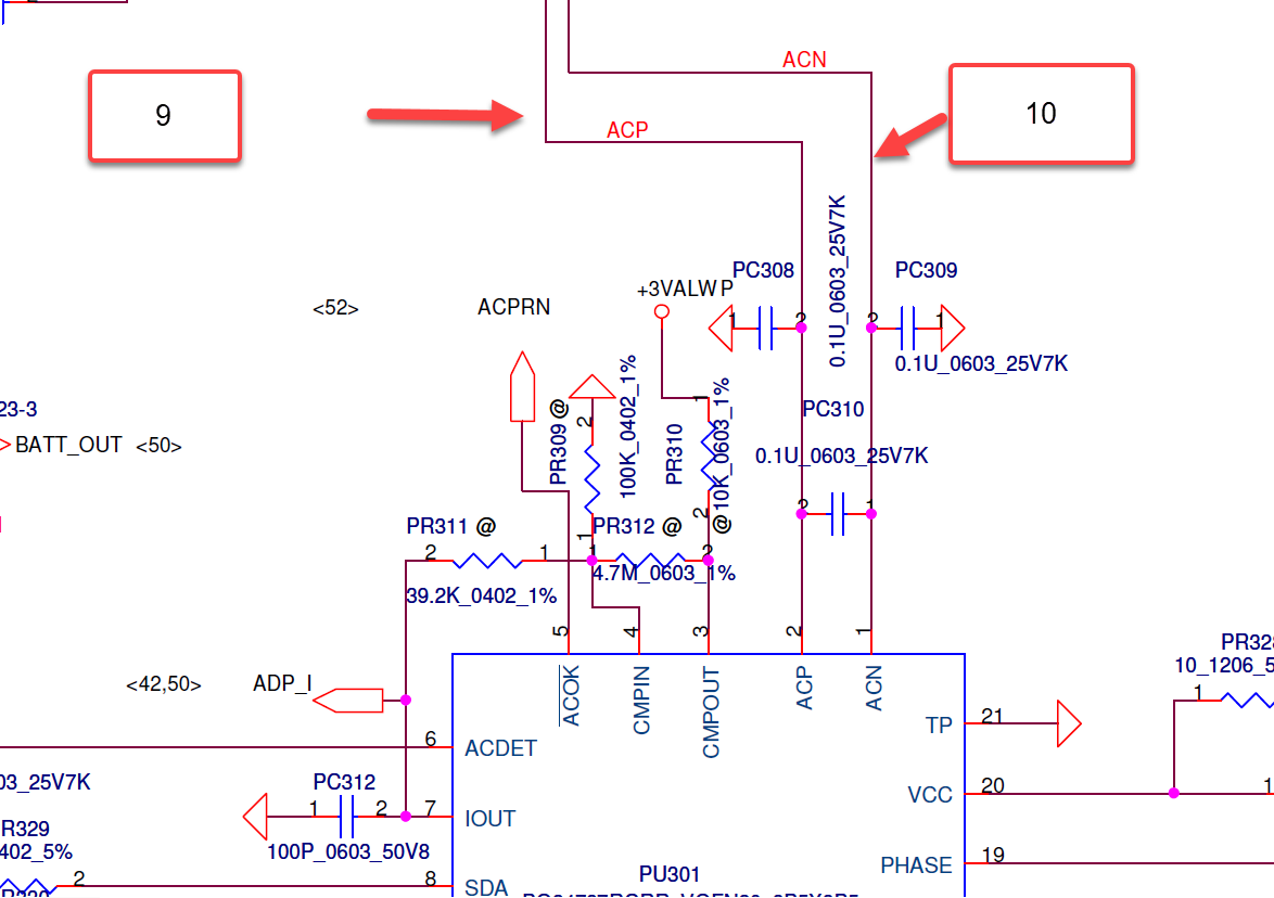

    Schematic attached.

    Re: Y580 works on battery, but not with charger
    Hi.
    Measure and post the voltages (to ground) for the attached with the adapter only. Remove the battery.
        Hi, and thanks for your assistance here - much appreciated.
        Here are values as requested:
        Val 1 19.45v
        Val 2 18.87v
        Val 3 0.93v
        Val 4 18.52v (gate)
        Val 5 18.54v (gate)
        Val 6 0v (ACDET)
        Val 7 0v (SDA)
        Val 8 0.93v (SCL)
        Val 9 0.93v (ILIM)

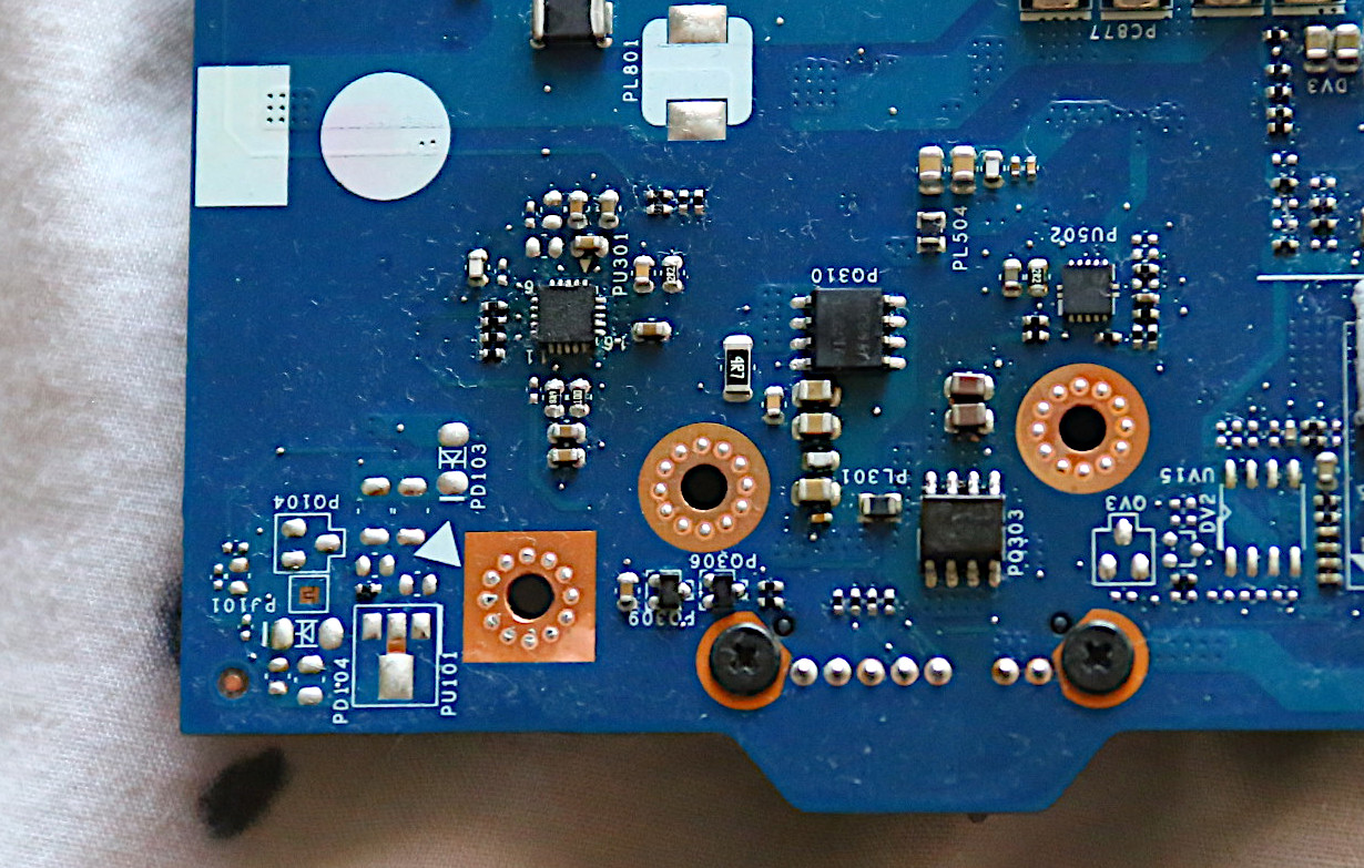

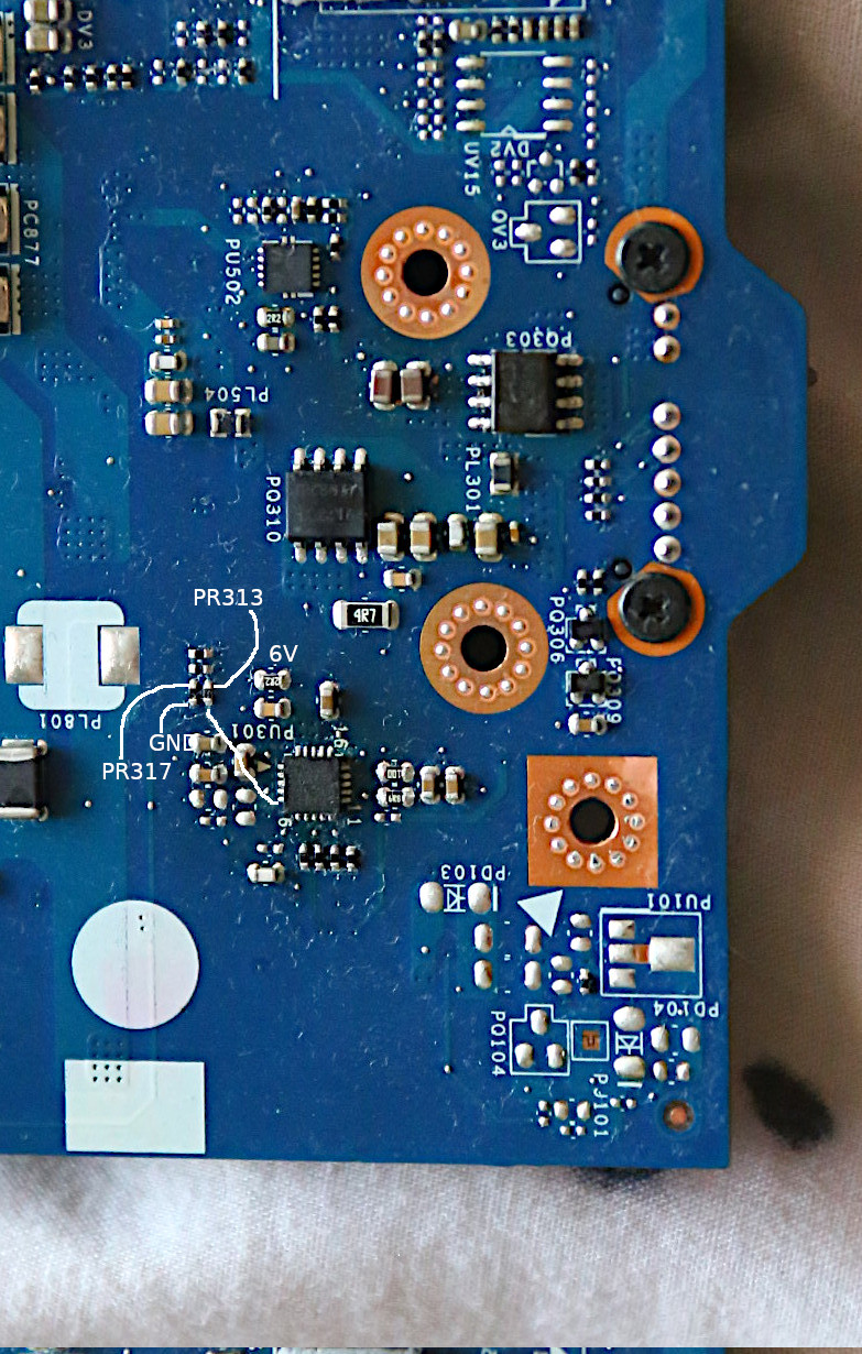

        Val 10 and Val 11 - see attached photo - I don't have a boardview, so I don't know which PC308 and PC309 are. They connect directly to PR301, the current resistor, but the schematic shows 4 pins but PR301 has just 2 ends?? The voltages on pins 1 and 2 of the chip both have 0V

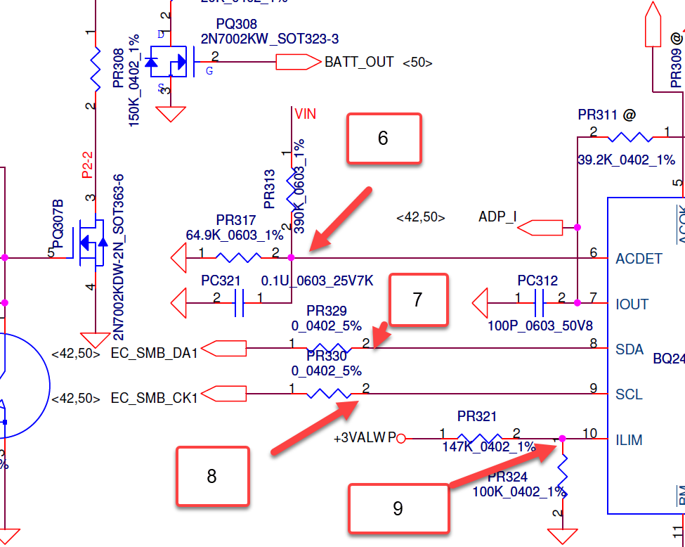

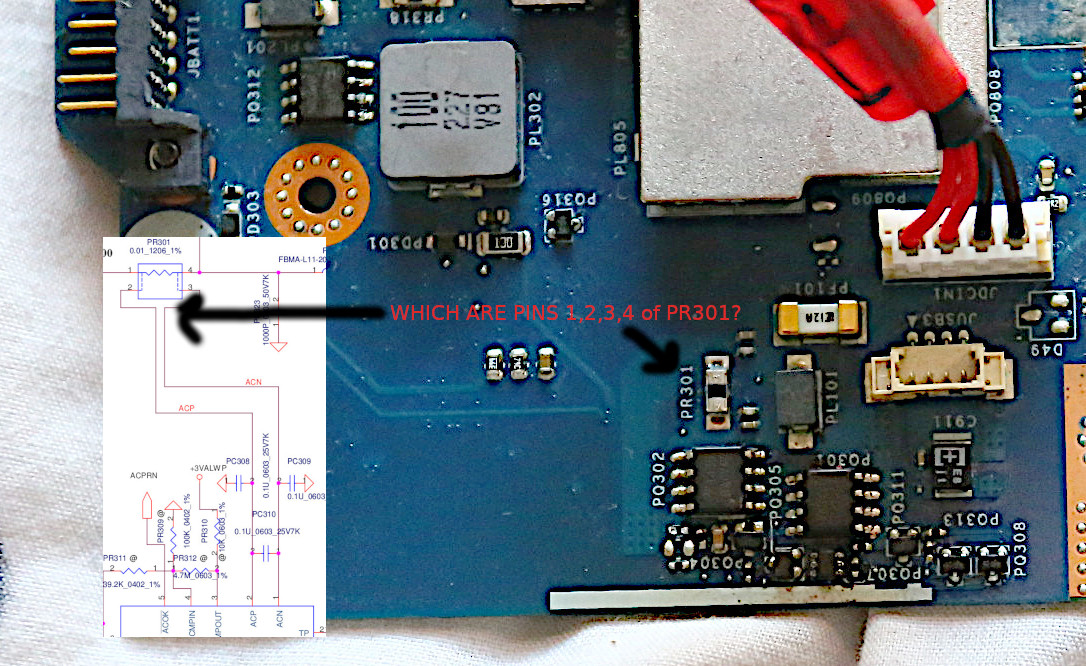

          PR301 appears to be barely touching the bottom side pad.
          Can you confirm that it indeed is soldered properly onto this pad? Without PR301, the switching regulator will believe that the rail is being pulled down to zero volts = too much current to support so shut it down.
          Val 6 0v (ACDET)
          Val 7 0v (SDA)
          Val 8 0.93v (SCL)
          These are not valid and should be much higher.
          ACDET should be > 2V
          SDA & SCL should be about 3v ~ 3v3 due to pull-up resistors that are common to I2C (SMBUS) interfaces.
          See attached. Try to locate these 2 resistors that create the ACDET voltage.
          They are a resistor based voltage divider to accept the adapter (high voltage of 19v) and then lowering to a safe value for the charger IC. It should not be 0V for this junction. When this pin is 2V or higher, then the charger IC knows the adapter is connected.
          The mosfet resistance values look ok.
            Val 3 0.93v-This is also not correct. Should be 19V. This ppin is CMSRC and without proper 19V here, ACDRV will not work.

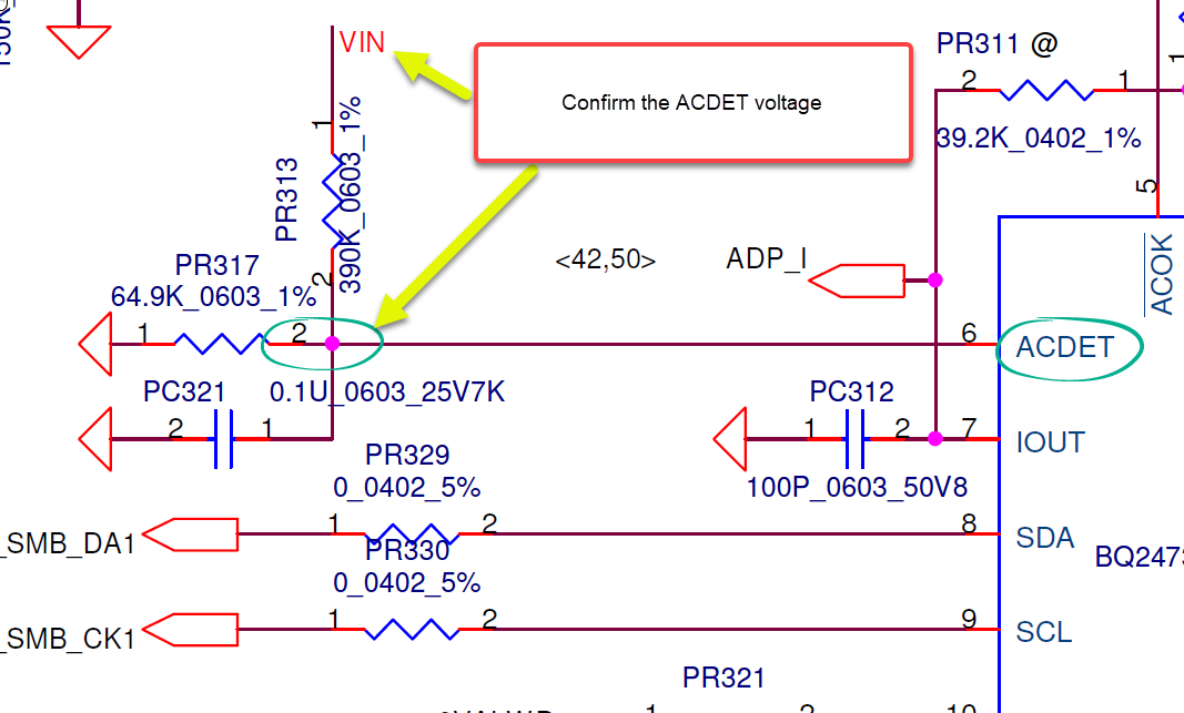

                ACDET is based on a simple resistor voltage divider and makes use of VIN which is the raw DCIN from the adapter (no mosfets are involved).
                Can you confirm the value of ACDET? If this is not working then the resistors involved @ PR313 and PR317 need to be reviewed or replaced. If necessary, remove PC321 and check the value of ACDET again.
                    Hi, with the 19v now on the main rail ACDET is still 0.
                    I think I've found the voltage divider for ACDET (see photo).
                    Measuring resistances shows PR313 as 11K and PR317 as 47K when they should be 65K and 390K respectively. So it looks like your theory may be good here. The voltage of the input to the input side of PR313 (which should presumably be VIN, or 19 right?) is only 6V, presumably because this resistor is faulty.
                    Will try to find a 350K resistor and see what happens..
                        Try to flux and reflow the 2 resistors if they are the proper sites.
                        Given that you have 0 volts on ACDET, something is pulling that line down to ground OR not allowing the high 19V to pass through to the ACDET junction.
                        Try the following:
                        Remove all power.
                        Meter in resistance mode.
                        Check the resistance to ground of ACDET. What is the reading ?
                        While you are ordering the replacement mosfets, consider to order a bunch of these resistors for replacement (they are quite small and easy to lose). Order 1% if possible.

                          Hi, ok, PROGRESS.
                          Acdet voltage was actually fine. Like a chump, I made the schoolboy error of reading the pin direction incorrectly, so my voltage readings were using pin 10 as pin 1 clockwise, so
                          I was looking at pin 5 for acdet instead of the actual pin 6 which registers 2.7v - the expected voltage.

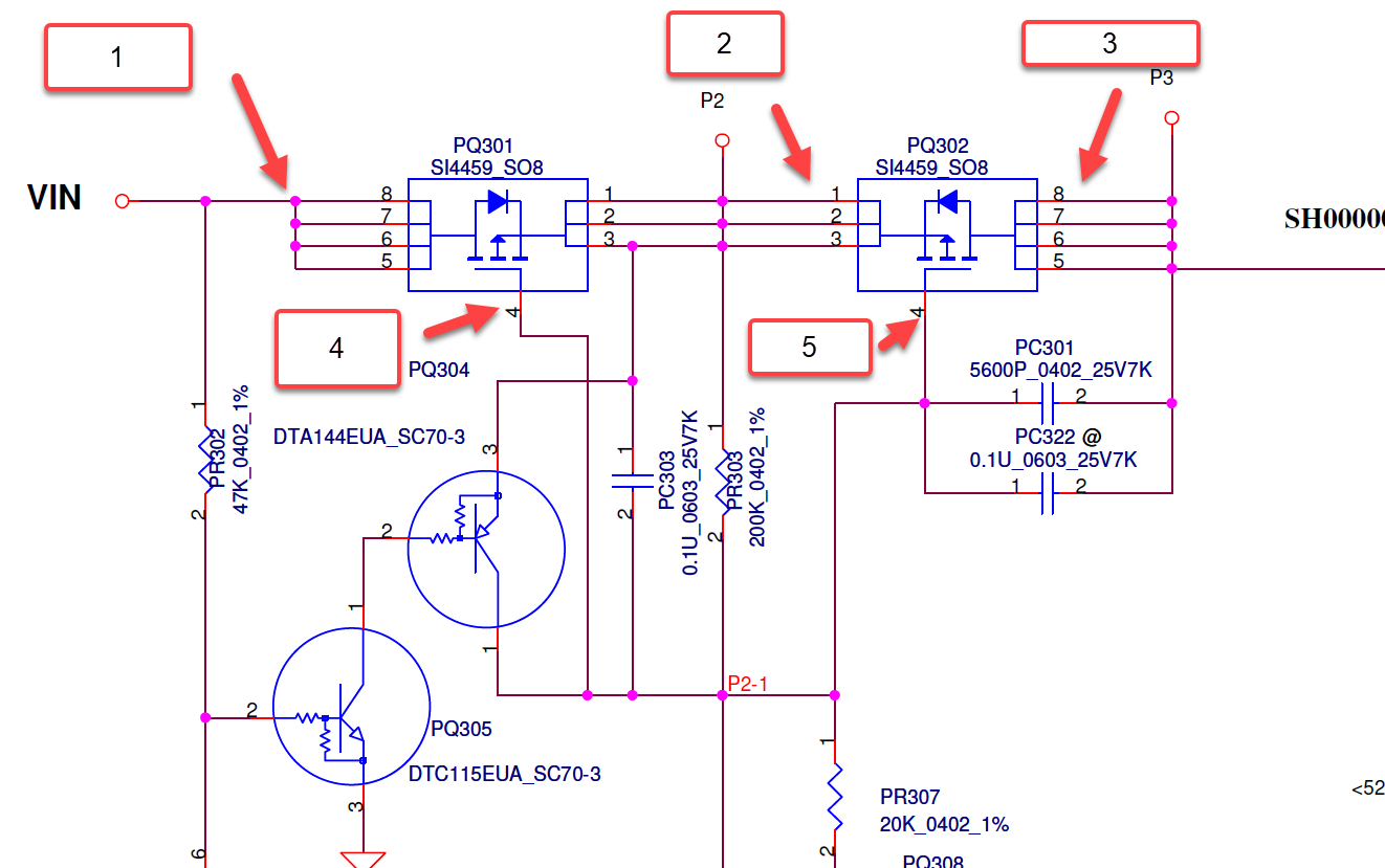

                                      See attached.
                                      Attach the power adapter (no battery).
                                      Measure and post the requested values.
                                      The Si4459 are p-channel mosfets. Therefore the GATE must be NEGATIVE voltage with respect to the SOURCE / DRAIN voltages to turn ON the mosfet.
                                      From your post # 4, the GATE = ~source / drain values so we have a fault as the mosfet is not being requested to turn on.
                                      The issue may be linked to the mosfet @ PQ308 which when turned ON, applies the pull-down resistor @ PR307 (confirm this resistor is onboard).
                                      When PR307 is enabled, the gate will be pulled down to turn on the mosfets.
                                        Hi, I traced the unmarked resistors so have a much clearer idea of what is what underneath PQ301 and PQ302. Best to disregard earlier readings, as a dodgy charger and possibly bad mosfet were still in place. The board does now work normally albeit for a brief period whereas before it didn't reach that stage.
                                        Voltages with no battery attached:
                                        Good Board, Bad Board
                                        1: 19.5, 19.5
                                        2: 19.5, 19.5
                                        3: 19.5, 19.5
                                        4: 1.58, 8.3v (ie gate voltage much higher on bad board)
                                        5: 3.28, 0v (!)
                                        6: 3.26, 3.28
                                        How is the pin 4 gate voltage generated at this stage and why would it be so much higher on the bad board? Is PC303 responsible for dropping voltage? I don't understand the role of a capacitor like this which has neither end connected to ground. (my limited knowledge)
                                        I checked resistances of all the components in this part of the circuit and they match the schematic on both boards.
                                        PR307 is indeed present, but the area you specifically mentioned (PR307/PQ308) have different voltages to the good board, so promising!
                                        Many thanks.
