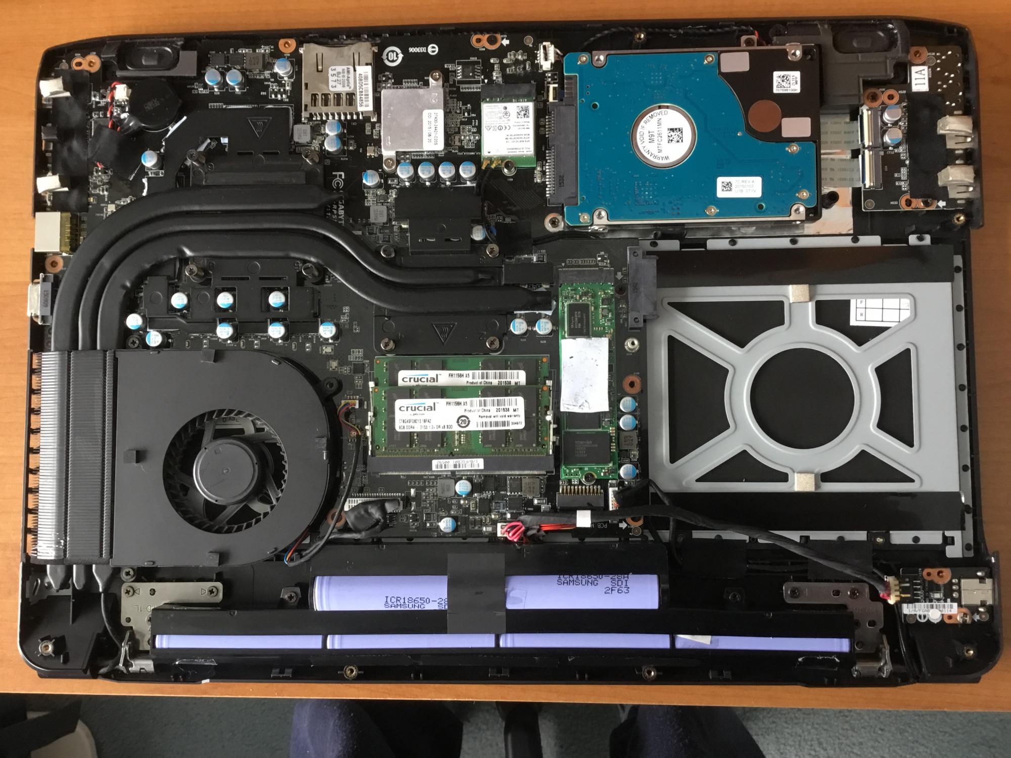

    My first post. I have a Gigabyte gaming laptop. Its a P55Wv5. Over the past few years its developed a problem with what i believe is a power issue. The motherboard model is GA-RP55W5 Rev 1.1
    When using the laptop on mains power, every few seconds it cuts off from mains and runs on battery then switches back to mains.
    Ive tested the AC adapter and im getting 19.9v which is constant. Ive tested the 8 pin cable which connects from the DC jack board to the motherboard. Both the AC adapter and the cable seem to be fine.

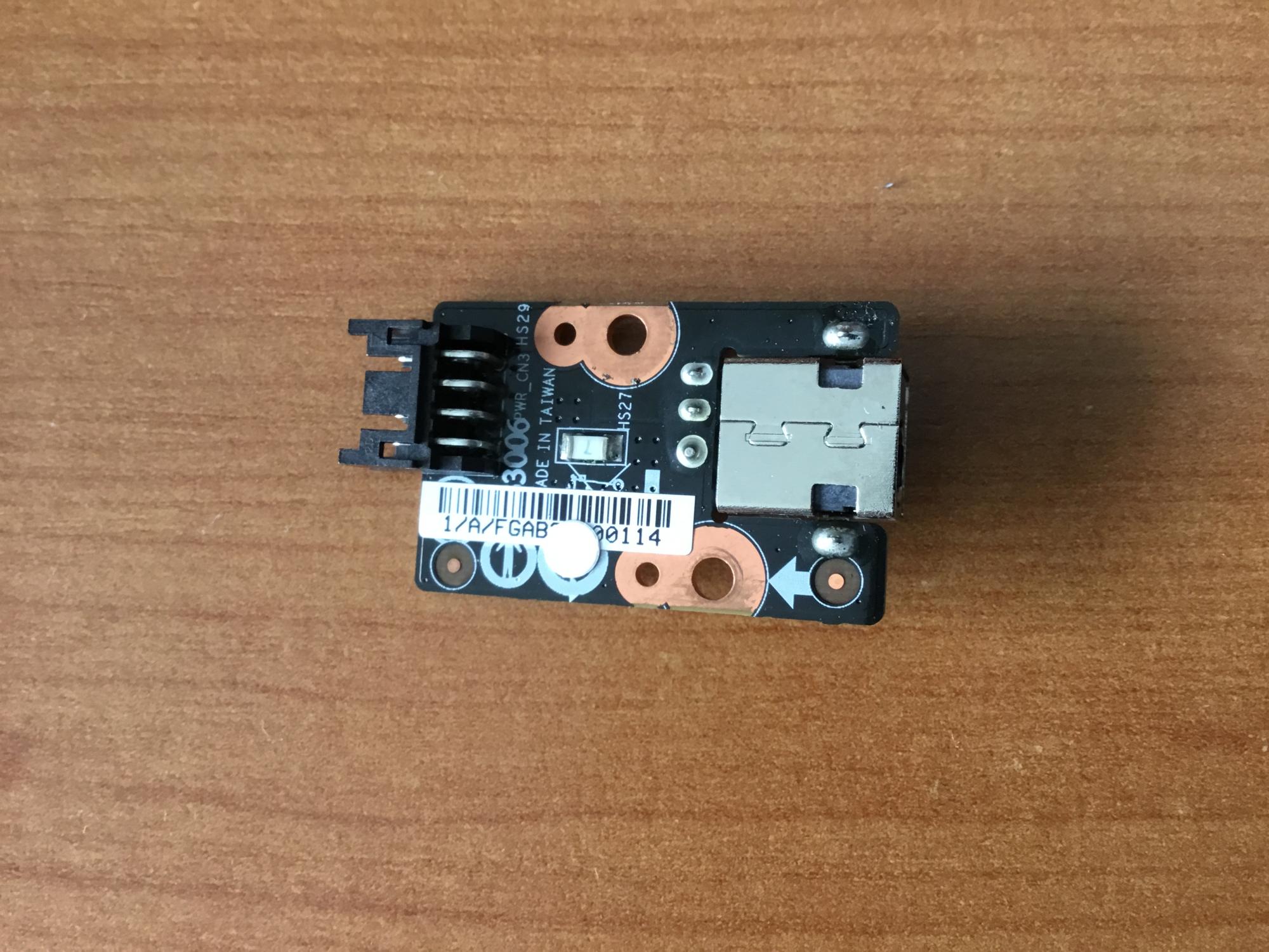

    The next easiest part to check is the DC jack board. From what i can see, the are three components on it. The DC jack at one end, the 8 pin connector at the other end and a shiny thingamajig in the middle. I assume it shouldn't be too hard to diagnose.
    I have no experience in diagnosing motherboard components so im looking for guidance. How do i test these components? If the DC board passes then the next step is to start diagnosing the motherboard.

    Hi. Well, the first thing you should do is make sure both the charger and battery are ok bu themselves.
    Run the laptop with the battery disconnected, if it works fine from the charger alone you know for sure it's not the charger. Then connect the battery and run from battery.
    If both are fine you can look to internals but the above should be your first move if you haven't done that yet. I say this because a charger giving voltage doesn't mean it's good. It likely is but a power supply can easily give voltage and then fail at a certain amp/current threshold.
    If both test fine, there are still software options to look at first. Windows 10 has battery and charging diagnostics you should run and some laptops even have battery drivers now (insane, I know). Make sure all that is fine first, too.
    Only then look at hardware. That said, if it is hardware it sure sounds like a bad charge port (unstable connection in it) or a failing part that can range from mosfet to coil. Again, do the above first and even if you get to looking at hardware you'll need to figure out how to post photos here. People can't help what we can't see.

      Thanks WayofTheRoad for your response. Ive tried all those suggestions recently. If I disconnect the battery then when the AC cuts out the laptop dies because theres no battery connected. The laptop will work with only the battery connected. I have also tried uninstalling the battery driver and also running Troubleshooting on power, it didnt find anything.
      Another thing which i tried the other day was to run the laptop using a Linux Live USB. the plan was to run a program called Stress to push the CPU and to try to get the AC to cutout. For some reason, I wasn’t able to install Stress. Maybe tomorrow if i have time ill run Linux on it again and play a movie on it to see if it does it. If it doesnt do then it has to be Windows 10 if it does do it using Linux then it’s definitely hardware. It may have been easier to just check some likely components on the motherboard or on the DC jack board.
      Ill let you know what happens.

          I assume you have a multimeter based on your initial post (tested the charger for 19v). The next step should be to see if you can power the laptop with the charger plugged in as you measure the voltage coming into the laptop dial DC jack/jack board.
          It should show 19v but if you see it fall as the laptop turns off (or switches to battery if it has to be installed to give time to test) charger. If it stays solid as it turns off/switches to battery the issue is deeper in the board. You'll then test a point around/"after" the red wires that connect the jack board to the motherboard. Again, 19v and look for a drop on voltage when the laptop shuts off.
          To test with the multimeter:
          Stay in DC voltage mode for now, always have your black probe attached to ground and never touch two points of metal with the red probe at a time. One point/place at a time. If you do this you can't mess anything up.
          So, black always on ground (the big copper circles or the casing to a port of any kind) and then you'll put the red probe on each of those pins until you see 19v. That is your voltage in. Keep it there with the laptop turned on and see what the multimeter shows when the laptop turns off. If it stays a steady 19v, it's a bigger problem. If it drops to anything below, it's the charger/jack.
          Your placement of the red probe can also be on any single point near the red wiring that plugs the jack into the motherboard where you see 19v (like the big white part, a fuse). Up to you.
          Good luck and I'll reply back soon. I see your photos now so share anything you think may help.

            A few years ago when this issue started, the workaround was to unplug the 8 pin cable then reconnect it and the laptop would work fine for a few weeks. After a few months of doing that, the workaround didnt work anymore. A few days ago i removed the cable to test with the multimeter so maybe thats why its now working. I really believe that the fault has something to do with either the cable or the connectors which it connects to. I think it would great to be able to troubleshoot those components. But how? I think you may be able to see in the pic that one of the pins on the is burnt. Thats the reason why I disconnected it the first time.
            When i tested each pin of the 8 pin cable i tested it for continuity, is that the right way to test it?

                                      Ill give it a go tomorrow morning, when you say the big copper circles. Do they look like where the screws go? Also will the DC jack housing be ok for grounding? One last question, in the pic of the DC jack board there three solders points is there anyway to tell which is the pos and which is the neg? I could ground on the solder point.
                                      • WayOfTheRoad
                                        • Aug 2021
                                        • 59
                                        Re: Help with Gigabyte GA-RP55W5 Rev 1.1 motherboard troubleshooting
                                        Yes, those large copper circles that look like screw holes (usually are screw holes!) will be ground but the metal housing is also ground so that would be ok, too. Whatever is easier for you while testing.
                                        My guess from the photo alone is that the pins will be in pairs. You'll likely find that the middle two are one (power or ground) and the outside two are the other. The quickest way to know without any power inserted is to test for continuity.
                                        Same idea as when you'll test for voltage, put the meter in continuity mode (beep mode), place black on ground and see which pins cause a beep. Those that Beep will be ground and those that don't will be power in (19v in).
                                        If your meter doesn't have continuity mode, just use resistance mode (it should have the Ohms symbol that looks like an upside down horseshoe). In this mode, it works the same as other modes and those pins that show close to 0 will be ground while the power pins will show much higher numbers.
