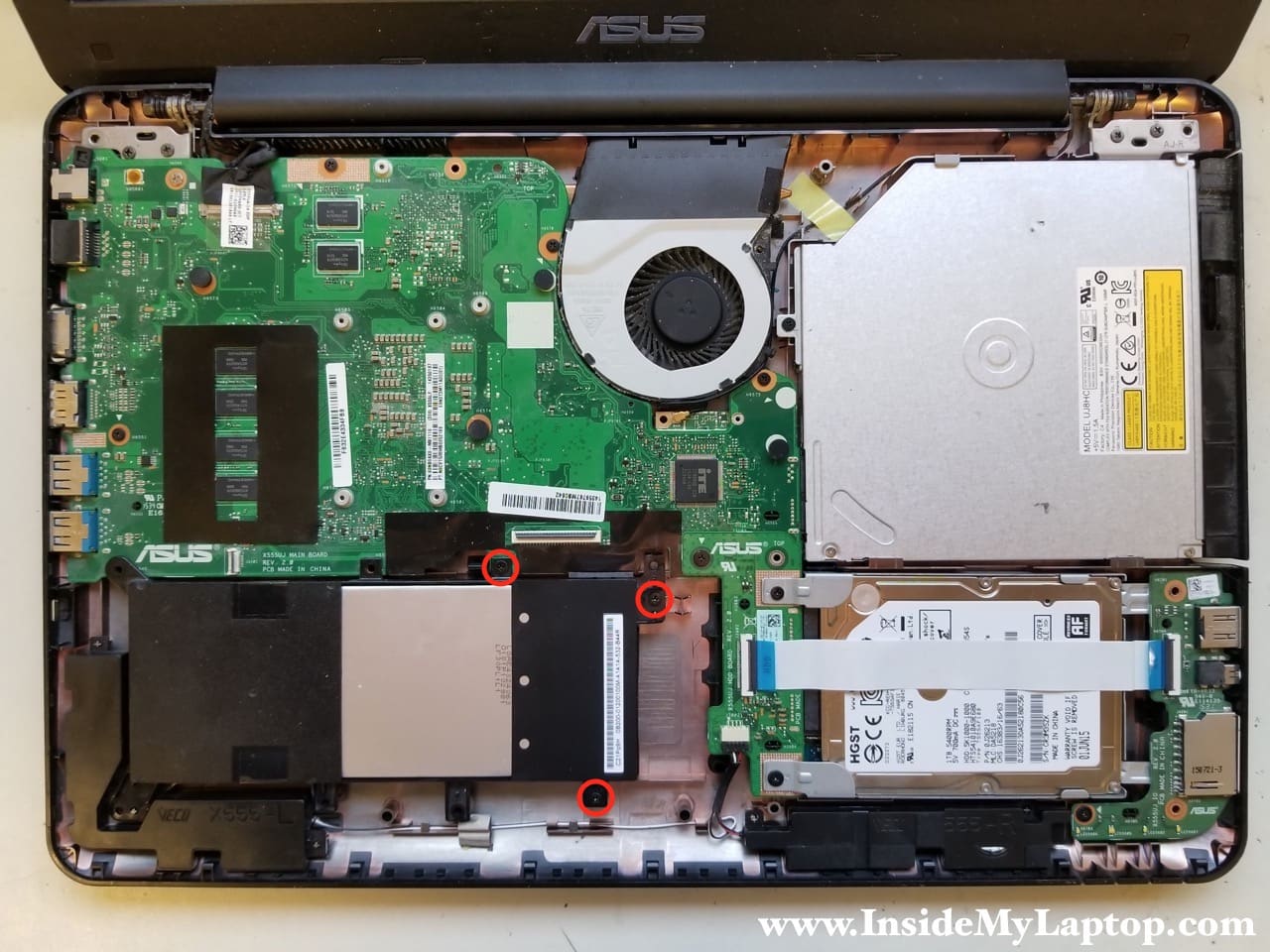

    Hello everyone, I've got one F555UB for a repair, where no disk is going to be detected, even within the BIOS. DVD-RW / ODD is detected correctly. What I tried so far:
    - tried different HDDs (160 GB, 250 GB, 1 TB, SSD), only the oldest 160 GB spin-up, probably didn't wait for some SATA start command
    - tried the same with ODD disconnected - no difference
    - did a multimeter continuity test to check if there is connection between SATA connector and DC blocking caps (4x 10 nF) and other side of caps to a connector of the small board, all OK
    - measured all 4 blocking caps, all ~9.7 nF
    I failed to downgrade/reapply BIOS package, most probably due to WIN2GO OS running from USB device, but can try from a DOS/EFI prompt as well. I've checked the boardview and the connector of a HDD board (motherboard side) is connected directly to a CPU/SoC. The only part which could eventually be related is a pull-up resistor on a SATA0_DEVSLP, but no idea if this is really used in general.
    To check: BIOS downgrade/reapply, and maybe check for a short between SATA data lines and ground (SoC SATA PHY port dead).
    Any suggestions what else to check? Any idea what could lead to a such strange malfunction?

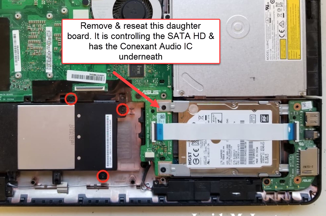

    Hi. OMG - working on the same Asus logic board (X555YA) that came in for a no sound card problem this afternoon.
    After some driver / software upgrades still no luck. Audio through HDMI worked fine.
    In the end - tore apart the unit and it looks the same as your posted pix.

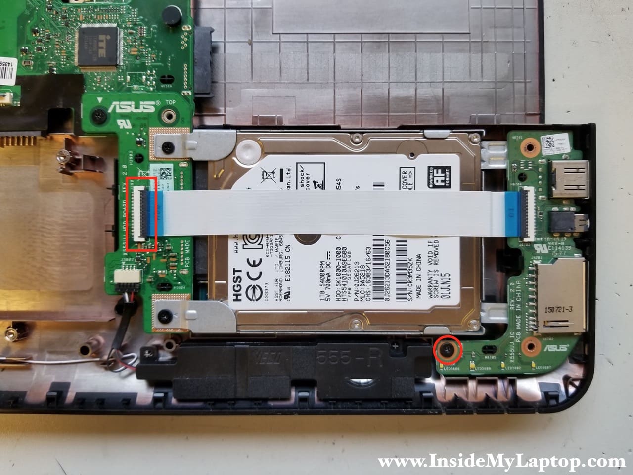

    Review the rear daughter board to the LEFT of the hard drive. Be sure it is seated properly and there are no bent pins. The very delicate blade connector is linking the SATA HD and the audio / headphone connectors.
    For our case, we fluxed and reflowed the CX20752-21Z Audio IC. This fixed the problem. We have a speaker and all is well. Client is about to pick this up in a few minutes.
    Be sure to inspect the mating connector to the SATA drive & also to the main Asus logic board. NO BENT PINS ?

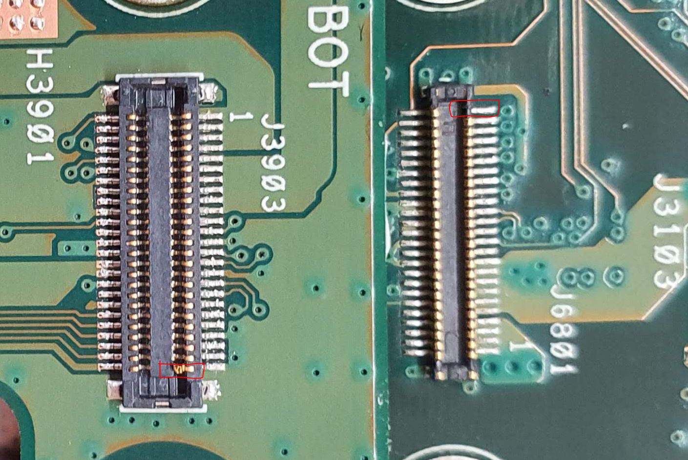

      mon2: thanks, so I did a better check and there was one broken contact - luckily it's a GND, but no contact to neighbor pin (exactly the SATA one!). Question is how long is broken, and if this could make a short between SATA data lane and GND - and if this could lead to a broken functionality of SATA port. After contact removal, still not working.
      Anyhow, I can do a workaround, using the caddy adapter for SSD in a DVD slot, because who needs optical drive these days. But fixing the dedicated one is a preferred way.

        You are getting closer to a fix.
        Count the number of pins on each side.
        Share your pix with this vendor found on AliExpress. There may be other vendors as well. Suggest to order a few pairs of the same.

                    In our case, client from out of town brought in the unit with missing audio. We updated the bios and attempted numerous software fixes. None would restore the laptop speaker and audio features. The audio codec was not being detected.
                    We then opened up the unit to locate the audio IC. This IC resides on a daughter card that mates with the main board using fine pitch connectors. In addition, the same board has flex cables travelling over the mechanical HDD.
                    We removed the audio / sata controller board. Reseated the flex cables, reflowed the audio controller with flux and heat, firmly reseated the interconnect to the main logic board.
                    After the above, audio was restored to normal.

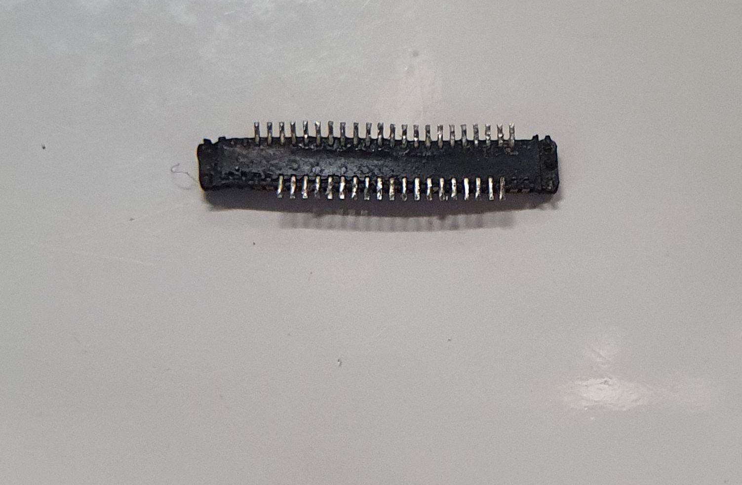

                            Hi all, see the de-soldered connector from a motherboard side, please ignore melted plastic body, it's going to be replaced, though. This is really a weak connector...

                              Re: Asus F555UB i5-6200U - HDD not detected
                              Yes, they are wimpy. Check out the videos on youtube from Alex (NorthRidge Fix) and others on how they desolder / solder similar blade connectors.
                              Personally did the same for a defective iMAC LVDS connector from a DIY client who butchered the pins during a hard drive upgrade. Short story, we made it worse with the hot air tool on the plastic body. Looked like a Chucky Doll after we were done with it.
                              Then we brought in the IPEX brand replacement. What a night and day difference on the construction. So much more rigid than the one on the Apple logic board. I think in hindsight, suggest to use lots of flux with a blade soldering iron tip and gently lift the connector as you go. The pads must be liquid before you lift. The hot air just melts the wrong parts of the connector.

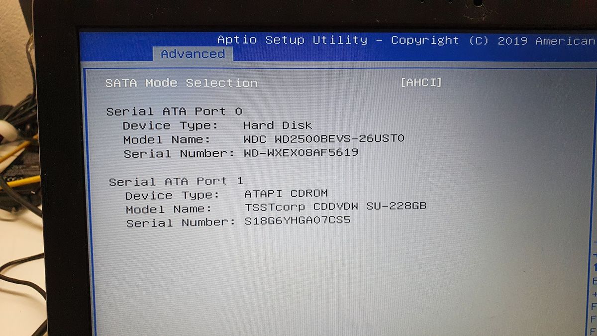

                                So, after long waiting, connectors have arrived, so I've replaced one on a motherboard. Voila, HDD detected, audio detected and working. Thanks for suggestions.
                                Hot air from bottom side + micro soldering tip from top side to finish it.
