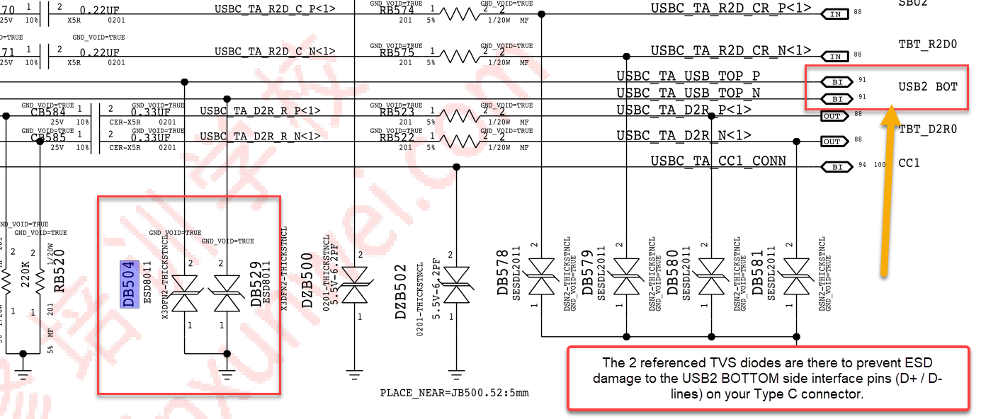

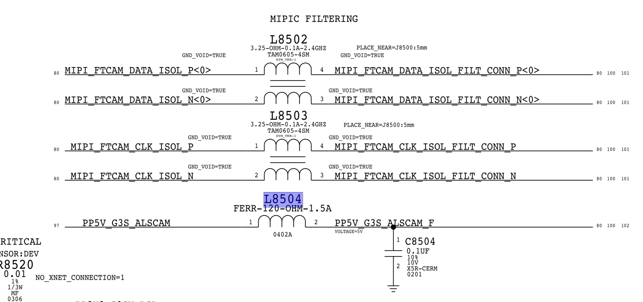

    I found 3 parts defective, or rather 1 defective and 2 missing! The L8504 has burned out. And the two DB529 and DB504 are missing.
    I get L8504 from a dispenser board and the other 2. Can someone tell me what the DB504 and DB529 are for?

      2) L8504 is an inductor and intended to filter noise on the voltage rail. In a pinch, not required for operation. You can simply bridge pin # 1 and # 2 of the L8504 pads to complete the flow of the voltage from one side to the other to power your webcam logic board inside the display panel.
      3) DB504 and DB529 are TVS diodes and they are quite small. They are intended to suppress any sudden voltage spike so that the controller IC that is interfaced to the USB connector does not get zapped. ESD diodes is the name for these parts and should you touch the connector with your fingers after walking across the carpet - that will make you look like Electroman and this zap is dangerous to low voltage logic onboard the macbook.
      Again, in a pinch and if you are well grounded, these parts are not required for operation. However, I would suggest you source a bunch of them to replace the missing parts. They are too easy to lose during the operation so order some spares.

          I will take the L4004 from the A1706 820-00239 I think its the same
          • mon2
            • Dec 2019
            • 14662
            Re: MacBook A1989 820-00850 no WebCam
            It will work fine. Very common part and not critical to the operation.

              the camera is running again! But do the pins for DB504 and DB529 have to be bridged if I don't solder them in or not? Thx
              • mon2
                • Dec 2019
                • 14662
                Good job!
                On the TVS ESD diodes - NO!
                If the parts are not there, you must leave the pin pads open (floating). Without these parts, you do not have ESD (static discharge) protection for these lines. It is not a major issue since the USB signals are inside and on the logic board.
                If you indeed source the replacement parts, solder them back in like normal.
                If you were to short them, then the USB signals will be shorted and the camera will no longer function and may lead to other damage
                The TVS ESD diodes are very common to source from Arrow.com or offshore (Aliexpress). If you are interested in the part # - post back and will locate some links for you.
