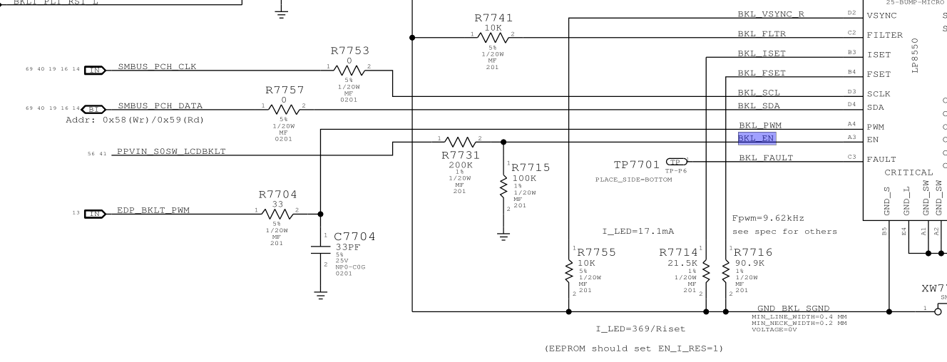

    I've been working on an 820-00165, currently with no backlight. There is a picture on the screen. At an earlier date, the backlight was working but it would drop out regularly, and sometimes not come on at all. I replaced U7701 thinking it might be a corrosion issue, but it wasn't. I haven't been able to get the backlight to come on since even though the screen does activate and I can see a flashing folder when lit from the back.
    I have confirmed after the U7701 replacement that I have the following:
    PPVOUT_SW_LCDBKLT_FB 8.5v (at U7701 pin A5)
    BKL_EN 2.73v
    BKL_PWM 1.07v
    The LCD connector was replaced earlier due to corrosion but the backlight was working (unstable) after that had been completed.
    Very strange. I have no boost but it's not clear to me why. I would appreciate anyone's insight.

            I did a clean of the LCD cable and socket connectors and they they look very good. I checked a couple more test points...
            BKL_FAULT = 0V
            BKL_SEL = 3.33V
            I did a quick inspection and found that the IC I installed for U7701 is a 52e4 rather than an LP8550. Some sites show that it is compatible but it was not what I ordered. The writing on this IC is so small that I can barely see the pin-1 indicator. I hope that isn't what's causing the problem. This should be simple and straight forward... I don't understand.

                What is the voltage @ BKL_EN ? (or is that the label you meant with BKL_SEL ?) If yes, then the voltage is ok.
                Also, the FAULT pin @ 0v does not necessarily mean it is an issue as this pin is OD (open drain). It appears that this FAULT pin is going to a test point (TP7701) and do not see a local pull-up to define the 'soft high level'.
                It is possible that the pin is tri-stated and only if you apply a pull-up resistor like 10k or could be higher to +3v3 - then you can measure this logic level to know if it is indicating a fault or not.
                With a pull-up resistor to +3v3 on TP7701 - does the FAULT line remain LOW (0v) ? Then there indeed is a FAULT. Otherwise this line will float to the HIGH (+3v3) = no fault.

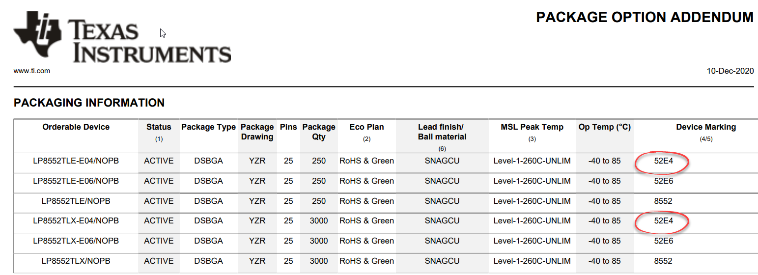

                    See attached.
                    The '52e4' markings are from Texas Instruments for their p/n LP8552.
                    Need to study the LP8552 to see if it is a valid cross for the LP8550 but the short answer is to use the LP8550 since it was deployed in the original design.
                    Update - see attached.

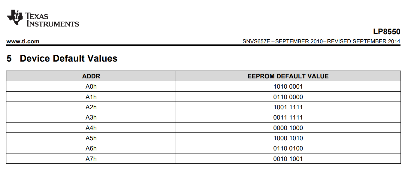

                    1) the LP8552 appears to be able to support a lower Vin value than the LP8550 to boost the LED backlight output voltage. That is nice but not required for this logic board.
                    2) the pinout of both devices appears to be the same
                    3) the EEprom defaults are not the same between the 2 devices (LP8550 & LP8552). Not sure if these different eeprom values will halt the use of the LP8552 but you can always test and report your results.
                    I would suggest to use flux and try to resolder the LP8552 you currently have onboard. 'Make it dance' and see if that improves your results.
