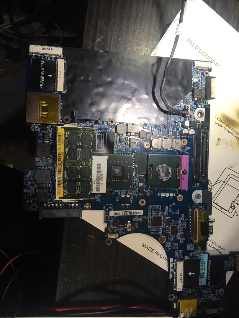

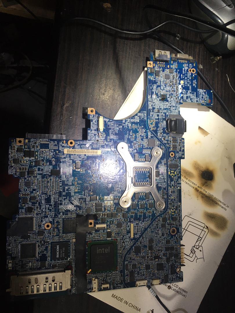

    Hallo team i have a Dell lattitude E6400 LA3803P which display an unknown charger message when starting up and when I check in windows it shows plugged not charging,
    i downloaded a schematic, im trying to follow PSID, the schematic indicates that it comes from pin no 2 of the DC jack to PL3 and so on but the problem is i cannot find PL3 and other components that follow on the actual motherboard,
    Please help me attached is the schematic and a capture of the motherboard. Thanks

    Hi. Unable to find where the external adapter enters the board from the posted pics.
    Suggest for you to attach the adapter and then post zoomed up pics of that area only. Do not power up the adapter but only want to see the mating connector.
    PL3 will be a surface mount inductor (coil) that 0603 in size so it is not too large. As per my post earlier this week on a similar case, the ID pin must mate with the logic board's EC to permit the 1-wire communication between the 2 parties. Logic board will send out 1-wire commands on pin 2 of the adapter, then the adapter will reply back with details to identify the adapter.
    Need closer but clear pics to hunt down the PL3 and related parts.
