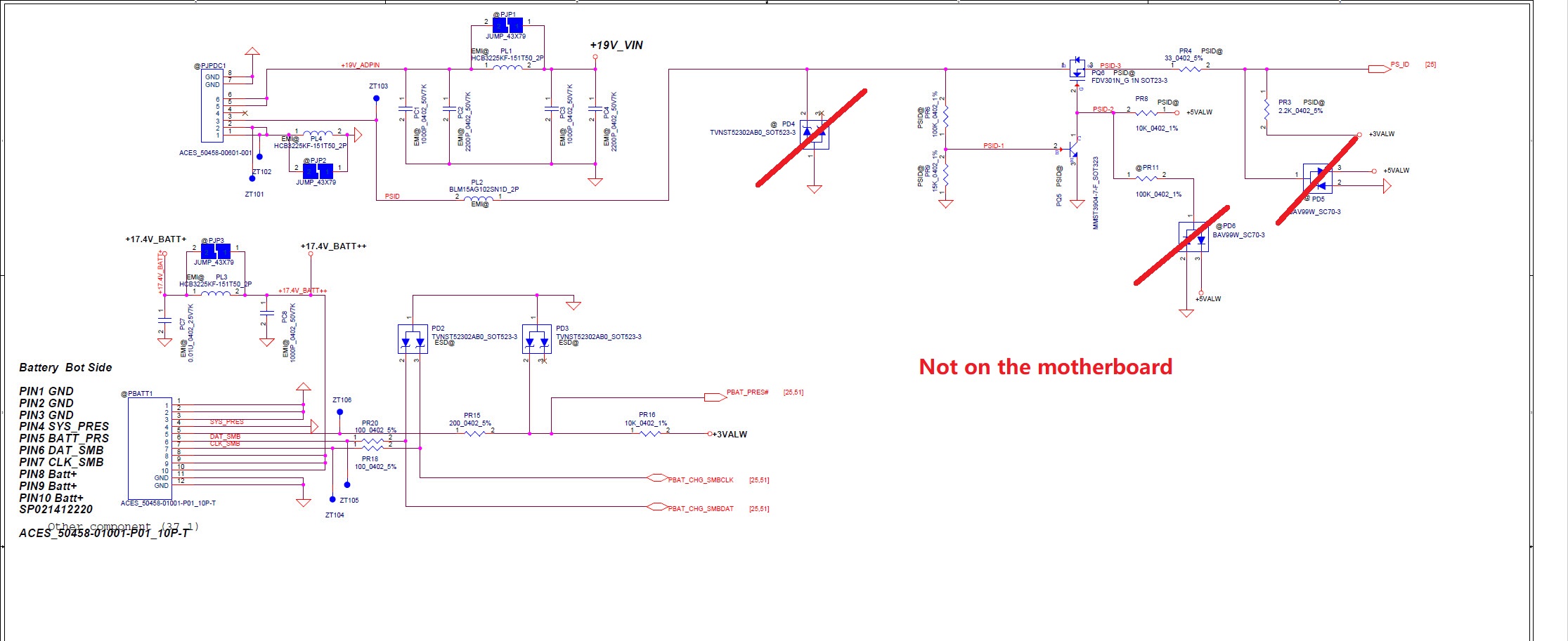

    Hello; so, i have this laptop; it came with battery charged only at 5%; when i plug in charger, led laptop is lightning white for 2 seconds, then it turn off and stay off.
    In bios, health of battery is excellent; charger is unknown.
    I test it with 3 dell oem chargers, all are ok.
    Laptop in rest is working perfectly.
    I upload schematics and picture with PS_ID flow; before PQ6 i have 3,1v, after PQ6 i have 3,6v. On pin 36 of UE1 i have also 3,6v.
    Laptop came with charger socket kind of ripped off, center plastic was missing. I changed with a new one.
    I suspect that UE1 gone bad on function to identification of charger, because motherboard has no protection, from factory, because PD4 is missing.
    And of course, PR4 have 33ohms.
    I charged the battery with power lab to aprox. 11,67v = 27% in bios, but no change, charger is seen as unknown.
    What to do next, guys? Thank you.

                Going by your readings, PS_ID comminication is perfect and is reaching SIO. So you mean to say you are getting 3.6V-both sides of PR4 and if so, that could be the issue as voltage should be max 3.33V here. I doubt PQ6 is bad. Try removing PQ6 and then put a jumper wire between S & D pins of PQ6. Do you get 3.3V on PR4 Now??

                  How did 3v1 on input to PQ6 become 3v6 on exit? I think PR3 is supplying the 3v6.
                  That was the reason for the questions that the OP did not answer.

                    @mcplslg123: I take down the PQ6, i put a jumper wire, still the same.
                    @mon2: you maybe are right, the PR3 on schematic have 2,2kohm, on mainboard have 1,95kohm; of course, on mainboard, i'm not take it down to measure exactly; but, it make sense that i have a higher voltage
                    OEM chargers that i have, 2 are 45watts and one 130watts
                    @all: saddly, because bad things get happend sometimes, because i think that my problem was related to signal PROCHOT(but that signal, i read it after that, is no where near my problem), i do many search here, on badcaps, i heating up the PU703, not to take it down, but just to resolder; and i burning it; right now, i don't have light on led at all, and when i put charger in socket, PU703 heating up baddly; after that, i take it down, i clean it up good and resolder; but still the same, it's getting very hot very fast; i don't imagine how it get burned that easy, but this is it.....i order another on aliexpress (i don't have much money), because i searched and this chip is puttit only in new mainboard, 7 and 8 generation intel cpu; and i don't have any defective motherboad with this chip.

                        hi @c.daniel. Believe to understand what may be going on here.
                        So, just to learn, in SIO, PS_ID have to have exactly 3,3volts?
                        No. As originally posted, this 3,3 volts is most likely due to the local pull-up @ PR3.
                        The HP chargers are analog in nature and use resistors as voltage divider, the ID pin on the adapter emits an analog voltage. The EC than uses an analog-to-digital convertor to sample this voltage and then decides the power rating of the mated power adapter.
                        Unable to locate any such detail for the DELL adapter. Rather, review the very good article linked earlier that identifies that DELL (like Apple) uses the Dallas Semiconductor 1-wire protocol.
                        https://en.wikipedia.org/wiki/1-Wire
                        https://hackaday.com/2014/03/03/hack...dentification/
                        The 1-wire protocol is a bidirectional communication interface that allows for your EC and the external adapter to chat and exchange vital digital packets.
                        The gateway between the logic board and the external adapter is the mosfet PQ6 which is the reason I have asked for the voltages in the list posted earlier. Only once we know these voltages can we determine if the mosfet is OPEN or CLOSED (acts like a bidirectional switch / solid-state relay). Suspecting that the mosfet is OPEN. In 1-wire communication, there is a definied low but no logic high. Instead, the communication line (PS_ID) is high impedance so an external resistor (PR3 on your logic board) defines the soft high level = 3v3.
                        Seems like you have other repair issues now that must be resolved first but stick with the highest power adapter (130W is good). The 45W is too low to power your logic board AND charge the battery.
                        The EC must be able to communicate to the PS_ID pin to send out digital commands (that the author referenced above documented) and the Dell branded adapter must send back replies along with a valid CRC (math operation to confirm that the original packet has not been tampered with). If all of this hand shake goes well, your logic board will not complain and allow for the charging and use for your box.
                        So back to the issue:
                        1) there are many clone 'OEM chargers' on the market. If your chargers work with other Dell laptops then it is ok to move forward using these power adapters (130W only is recommended).
                        2) the PS_ID communicates via the PQ6 mosfet being closed. Suspecting that this mosfet is NOT closed. You can power down; meter in resistance mode.
                        Check and post the resistance for the following:
                        Source & Drain
                        Source & GATE
                        GATE & Drain
                        for PQ6.
                        3) Still interested in the original requested voltages surrounding PQ6 so we can determine if the mosfet should open or close. Use the 130W adapter.
                        If it is not safe to power on this logic board - wait till you have repaired the other faults.

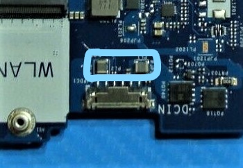

                          • nix30101
                            • Dec 2019
                            • 29
                            Re: Dell Inspiron 15 5567 unknown charger
                            check to see if one of these is burned or shorted. if so remove it.
