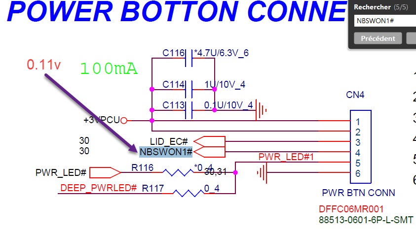

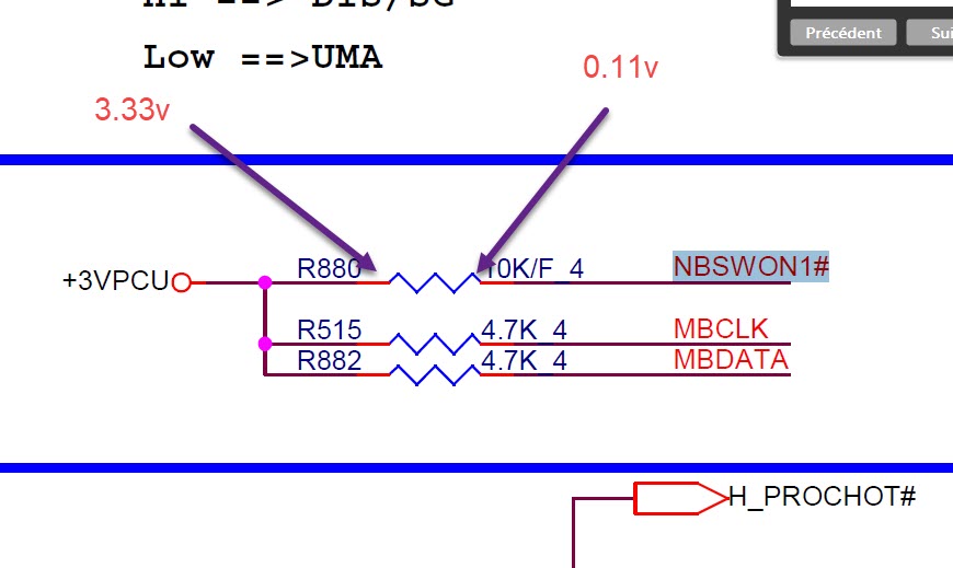

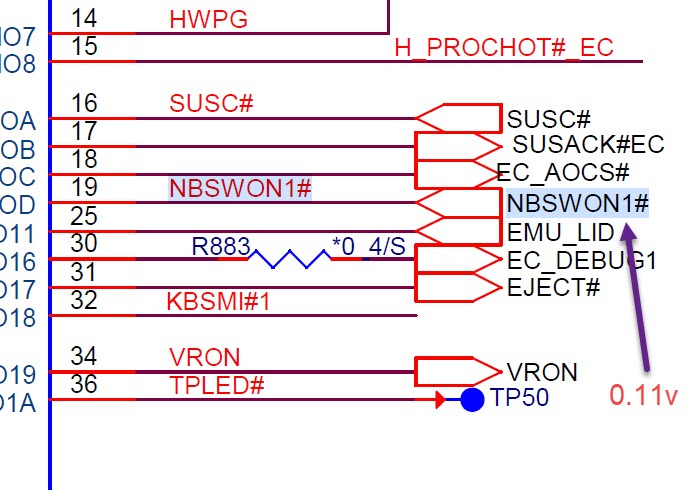

    hi
    i have laptop hp pav 15-r
    hp pavilion 15-e077ek
    motherboard: da0r62mb6e0 rev:e
    no power up
    all volts are ok only power boton have no 3.33v volte i change it but the same.
    i replace the risistor r880 but the same.
    every think is discribed in picturs attached
    any solutions pls.

        Do you have voltage on SDA/SCL pin??
