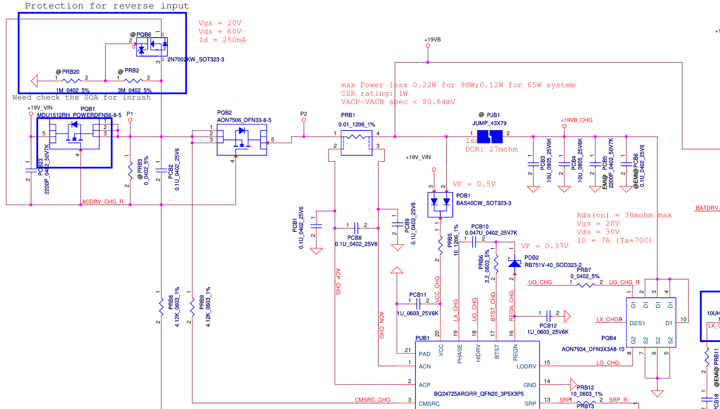

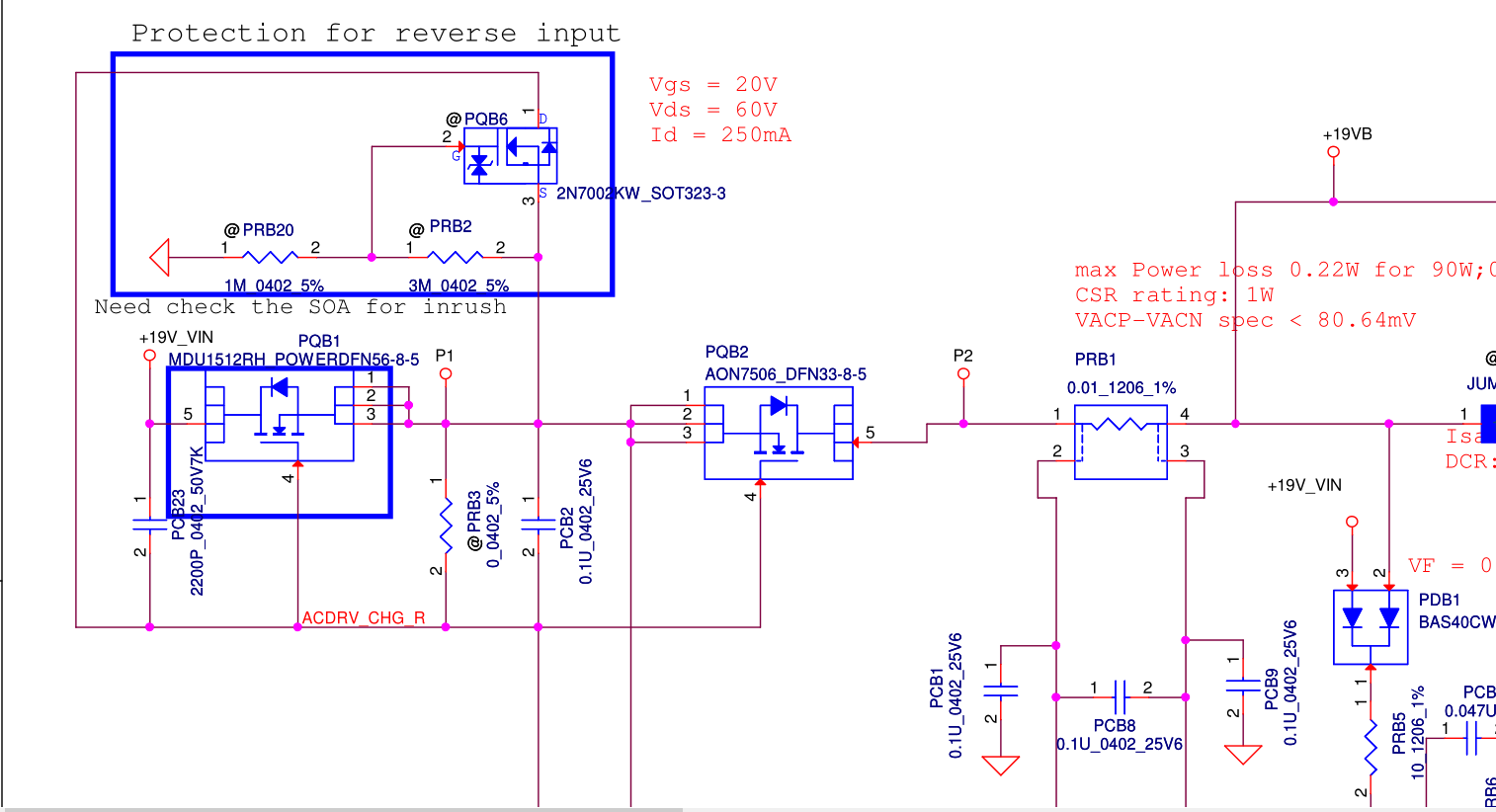

    1) my schematic database is showing different labels for the first 2 mosfets. Perhaps you can post your schematic to confirm ?
    2) Check the DCIN at the first mosfet. Also post the voltages for the GATE, DRAIN for each of the first 2 mosfets.
    PQB1 & PQB2

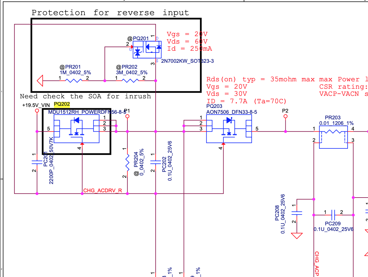

      Hi thanks for your answer,
      See attachements for the schematics, the labels are corresponding to the ones on the motherboard so I guess it's correct schematics in my case ! But it looks very similar to the one you have.
      Regarding the values I have on these 2 MOSFETs :
      PQ202 (MDU1512) :
      S = 19.8v
      G = 25.7v
      D = 19.8v
      PQ203 (AON7506) :
      S = 19.8v
      G = 25.7v
      D = 19.8v
      For resistance values I have several Mohms for each junctions for both MOSFETs !
      I guess the issue is not from one of these MOSFETs but I may be wrong ... The point is that I'm not sure about what to check next and which power rails should be on when the computer is off but connected to power supply (I don't use the battery yet)

        Yes, the first 2 mosfets are ok.
