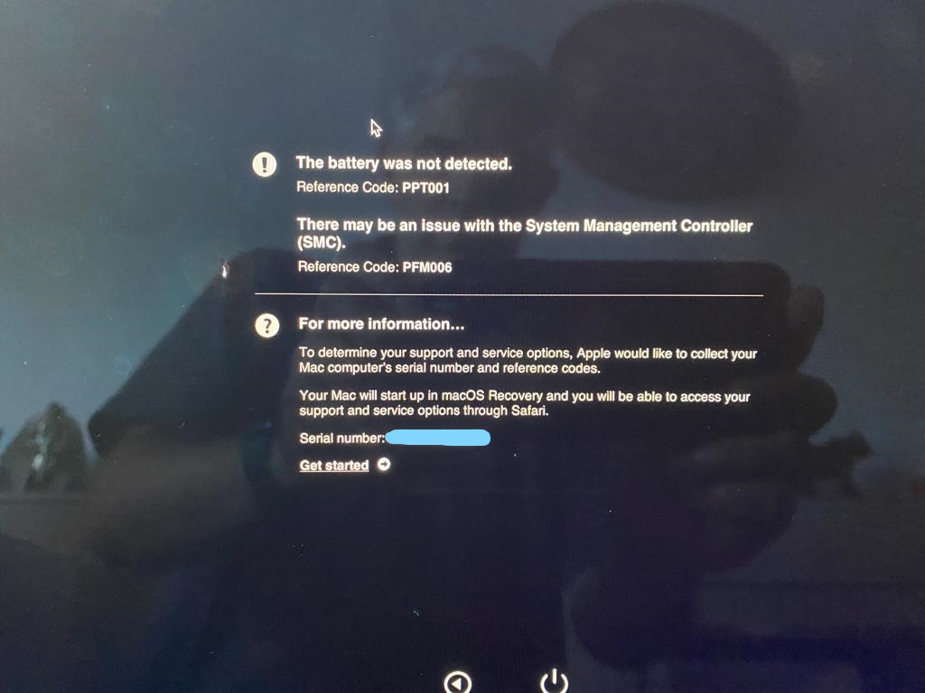

    I don't have to much experience with Mac devices and ask for your help
    I got this Apple device: Macbook Air A1932 EMC3184 which is running very slow , battery percentage stay on 1%.
    I opened and found swollen battery inside, unplug the connector from logic board.
    I tried to reinstall the software, Catalina, but it so slow , no success , with some errors on network connection. I tried again from an external USB-C stick , very slow, and I got different errors, no success, even with procedure: press power button and connect the charger adapter for running in safe mode.
    It's any software for hardware diagnostics for SSD or RAM ?
    Any ideas will be very helpfully.
    Thank you

    Re: Macbook Air A1932 2018 late
    Try a pram reset.
      Good battery required for machine to work properly.
        Changed the battery first. Second chkdisk HDD for bad sectors. Common to need a new HDD.
          There's no HDD…
            Yes, it's not any removable hdd/ssd, it's solder to motherboard.
            I made another diagnostic test ( press power button and quickly press D until you see a menu "choose language").
            Should I be worried about the SMC error or it's related with battery missing.
            I will try another test with the battery connected.
