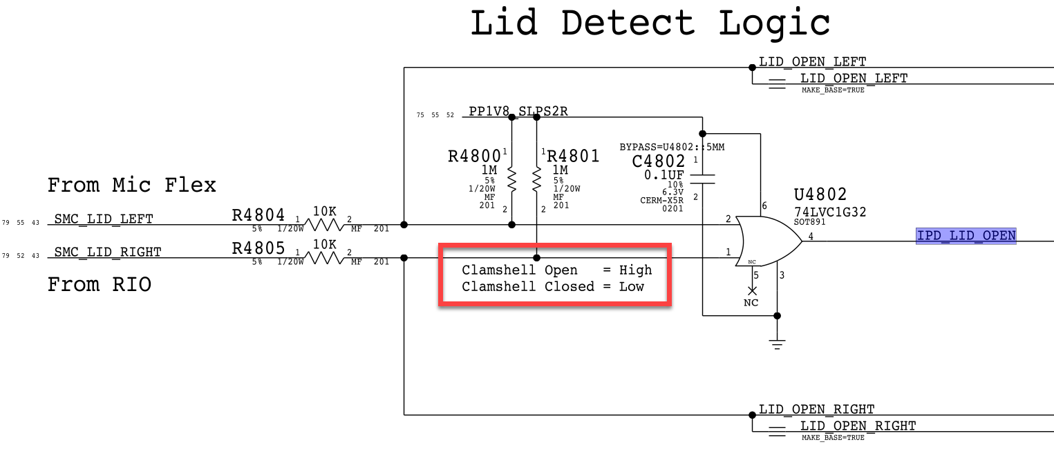

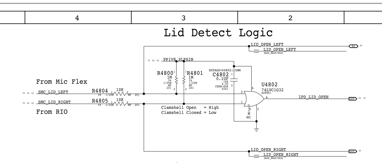

          Re: MacBook Air A1932 2019 No Sleep Mode
          What is the 820-xxxx marking on your logic board ?
          Is it 820-01521 ?
          For (A1932) 820-01521, the partial schematic is attached.

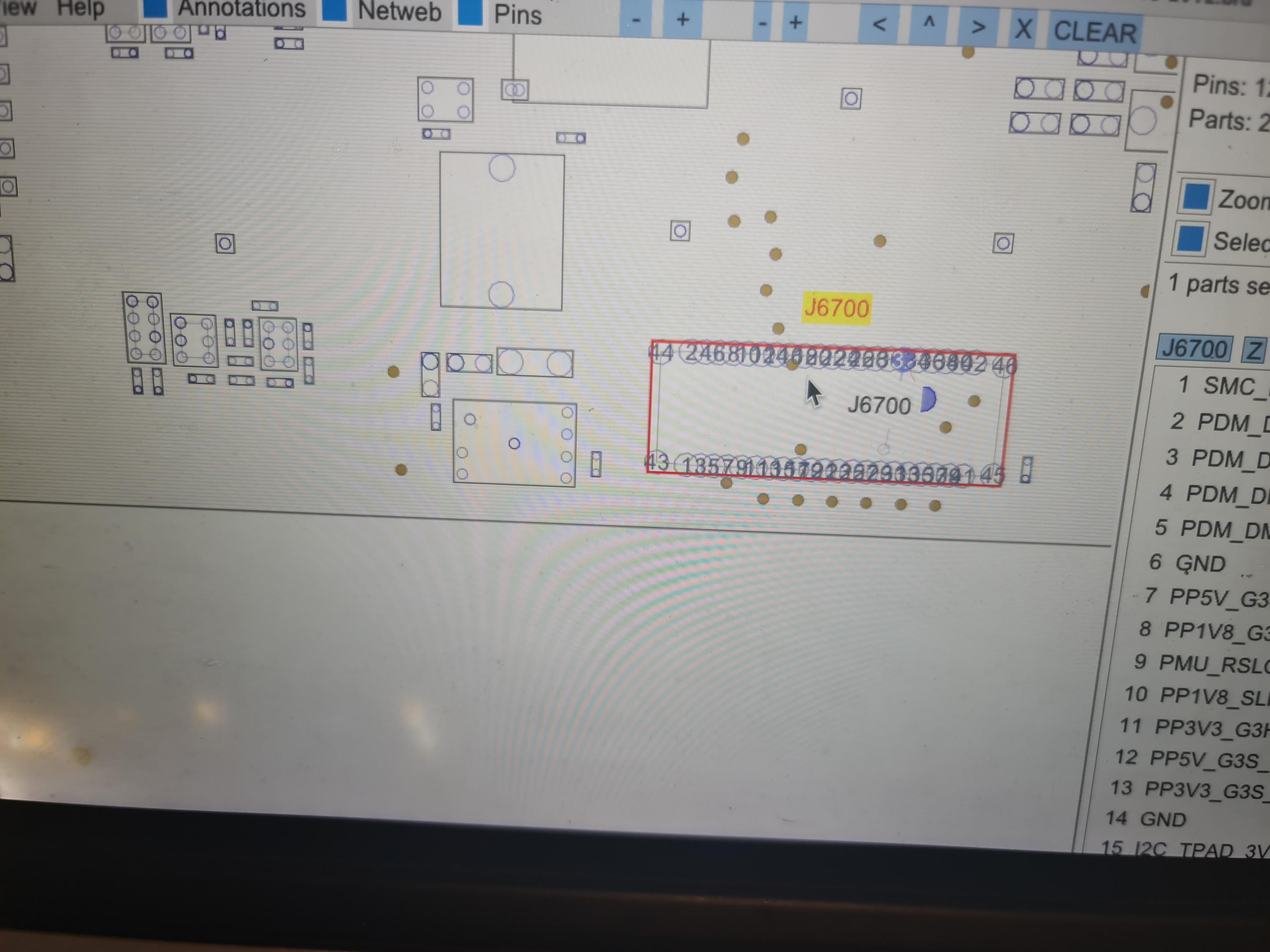

                        Hello, can I measure at pin 32 of the J6700? it goes to pin 4 of the U4802. Because the U4802 is on the back of the logic board. thx
                        • Strolch
                          • Nov 2017
                          • 245
                          • Deutschland
                          J6700
                          • mon2
                            • Dec 2019
                            • 14672
                            Yes. Highlight the net and find any easy to measure point. They are only common connections (traces) between the parts on the same net.

                                1) See attached. The lid logic is not working properly.
                                The OR gate @ U4802 is operating @ +1v8 so it is OK for the output pin # 4 = +1v8 = '1' (Logic HIGH) when the lid is OPEN.
                                When the lid is closed, pin # 4 of this single OR gate should be Logic LOW.
                                2) Next, let us check if the OR gate is receiving the proper signals upstream for the lid open / close.
                                Locate R4804 resistor and R4805 resistor which will be on the same side as the J6700 connector you just probed. These resistors are to the LEFT side of this connector.
                                They are tiny 0201 parts so probe with care.
                                Check the voltage on R4804, pin 1 when lid is closed. Then confirm the same voltage is present on pin 2 of R4804. Post the voltage when closed.
                                Check the voltage on R4805, pin 1 when lid is closed. Then confirm the same voltage is present on pin 2 of R4805. Post the voltage when closed.
                                For starters, you could probe J6700, pin # 1 = SMC_LID_LEFT
                                probe J6100 (on the same side of the PCB), pin # 27 = SMC_LID_RIGHT
                                What we wish to ideally see is that when the LID is CLOSED, both of these points should be logic LOW.
                                For the Dual-input OR gate to output a LOW, both inputs must be LOW.
                                Respectively, if the OR gate is stuck to HIGH then
                                either one of the inputs is stuck to HIGH OR (no pun)
                                the OR gate is defective. Personally we have seen single gate OR gates from Diodes Inc. being defective even though we purchased them from factory and in full tape & reels. Such a pain to desolder and fix so we switched suppliers for this component.
                                Post your voltage readings for the SMC_LID_RIGHT & SMC_LID_LEFT labels while the case is CLOSED.
                                Update - have a suspicion that since this single gate OR is near the edge of the PCB (bottom side from your connector you reviewed), at least one of the input signals is NOT making it to the gate due to corrosion. That is, the local pull-up resistors @ R4800 or R4801 are parking this OR gate to the fixed logic HIGH. Will know more once you probe the lid voltages.
