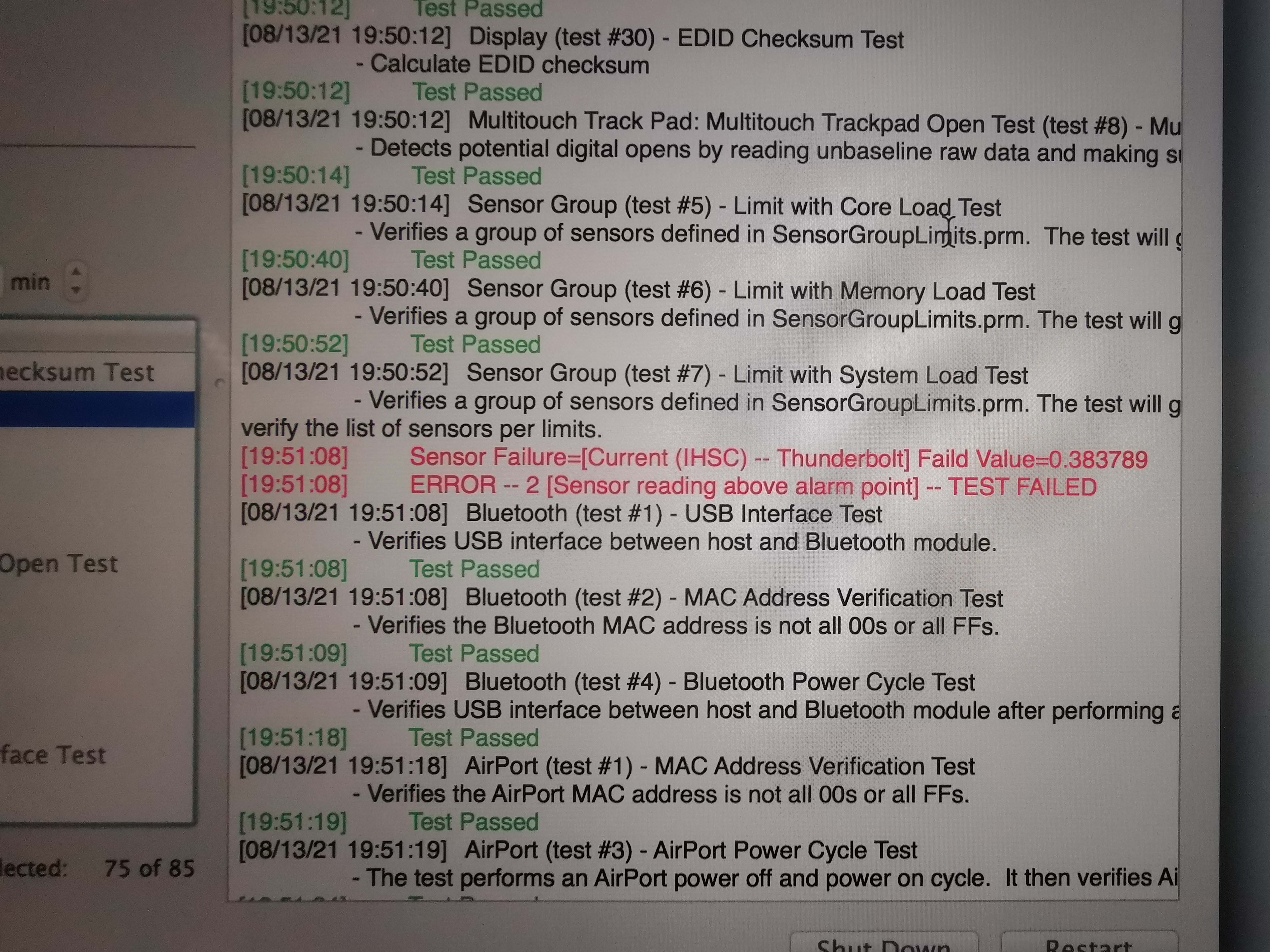

    Got a Apple MacBook Pro 15-Inch "Core i7" 2.5 Mid-2014 (DG), this is a unit with discrete/separate Graphics GT 750M. S/N: C02NK14CG3QP, Logic board model: A-820-3787. Issue I'm having with it - is after booting to OS FANs kick in at full blast. Software is eliminated as tried to run off external SSD and done complete fresh reset with Catalina = fault still present.

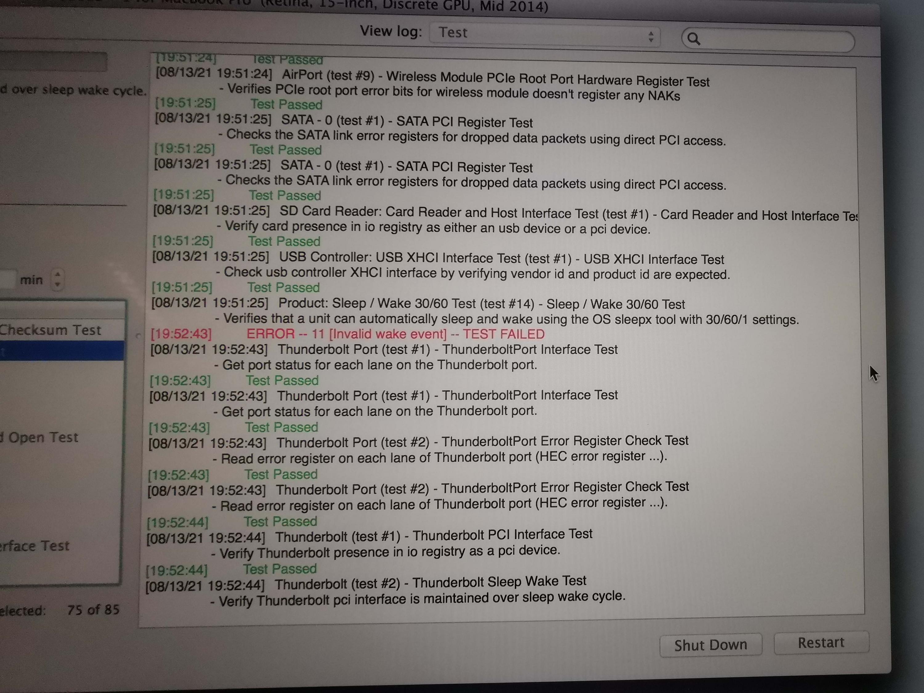

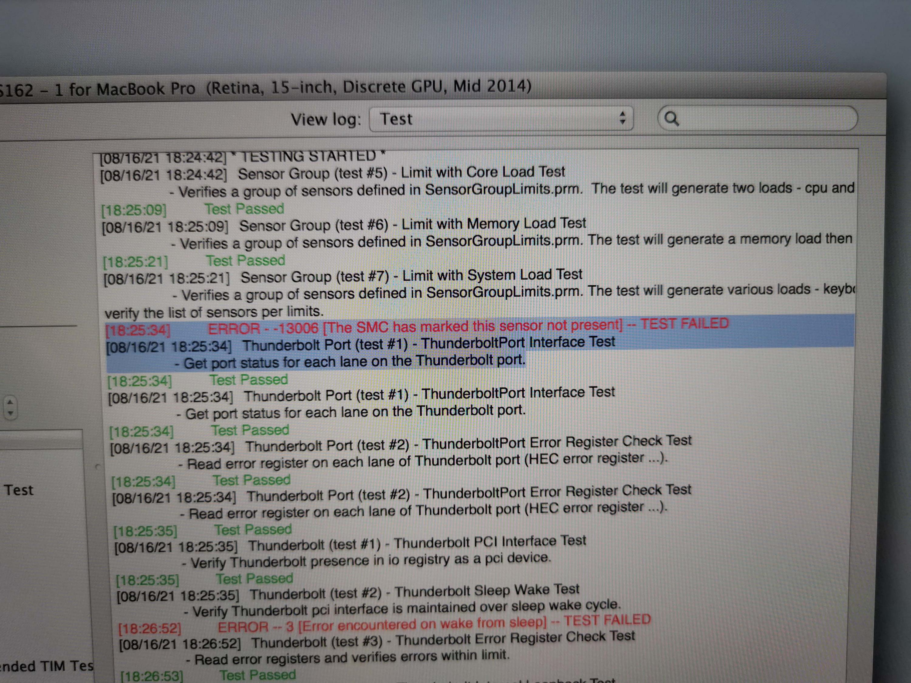

    Have checked it with running ASD diagnostics with a result:
    Sensor Failure=[Current (IHSC) -- Thunderbolt] Failed Value=0.383789
    ERROR -- 2[Sensor reading above alarm point] -- TEST FAILED.
    Fairly clean logic board, I've cleaned it with Isopropyl Alcohol, checked Thunderbolt area to see maybe I can identify a possible component, which would the this IHSC Sensor but had no luck yet. Maybe someone knowledgeable about those Mid-2014 MBPs had similar issues? Basically everything is fine with board/the rest apart from this sensor somewhere... It's not slow or anything like that, no limp mode, works great but is on crazy MAX FAN RPMs while running.
    Got the boardview logic board schematic for it. Which component I need to look for on the board? OK with desoldering micro stuff, got fresh microscope sitting and waiting in case necessary as well. Attaching ASD log screenshot and sensor temps, which doesn't reveal anything suspicions. Lost a bit with diagnostics on it now..

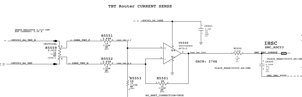

    Re: MacBook Pro 15" Mid-2014 (DG) A-820-3787 fan FULL SPEED & ASD IHSC Sensor error?!
    Only error when continuing on errors? No screenshot attached.
    Open schematics PDF, Ctrl+F "IHSC".

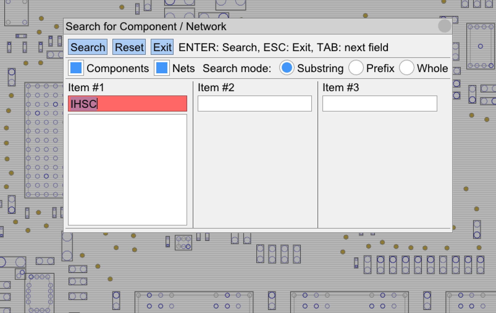

      Here are my screenshots, this with the Sensor error. Regarding searching IHSC for components obviously I did it - nothing comes on.
      What to check? Any advice

        • 21907
        Search in the schematic PDF,not the boardview https://www.badcaps.net/forum/showthread.php?t=62268
          This is current sensing and not temperature sensing issue. You need to check the corresponding resistors and whether the output capacitor is short circuited. Please, closesly examine the area (you can find it using the boardview) for any traces of corrosion or missing components.

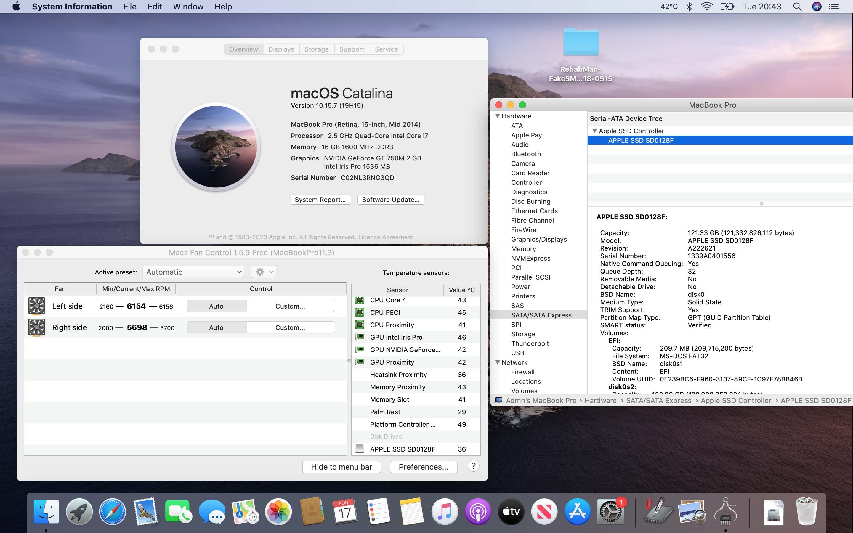

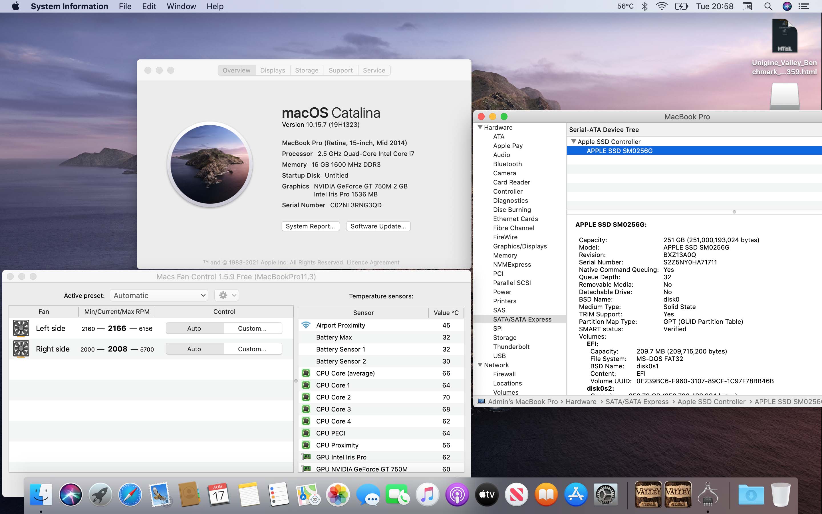

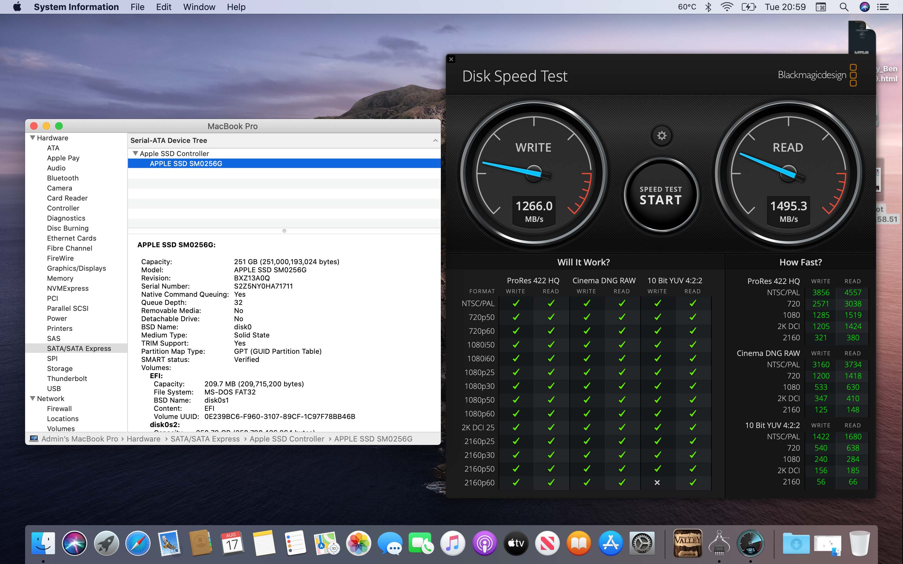

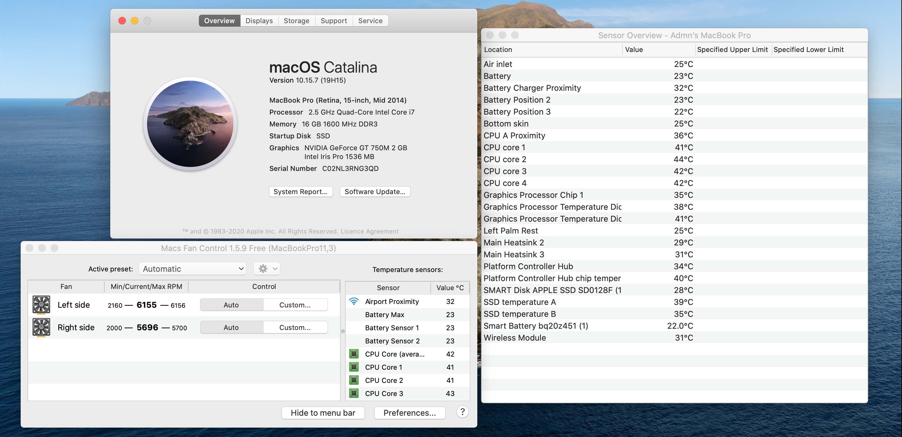

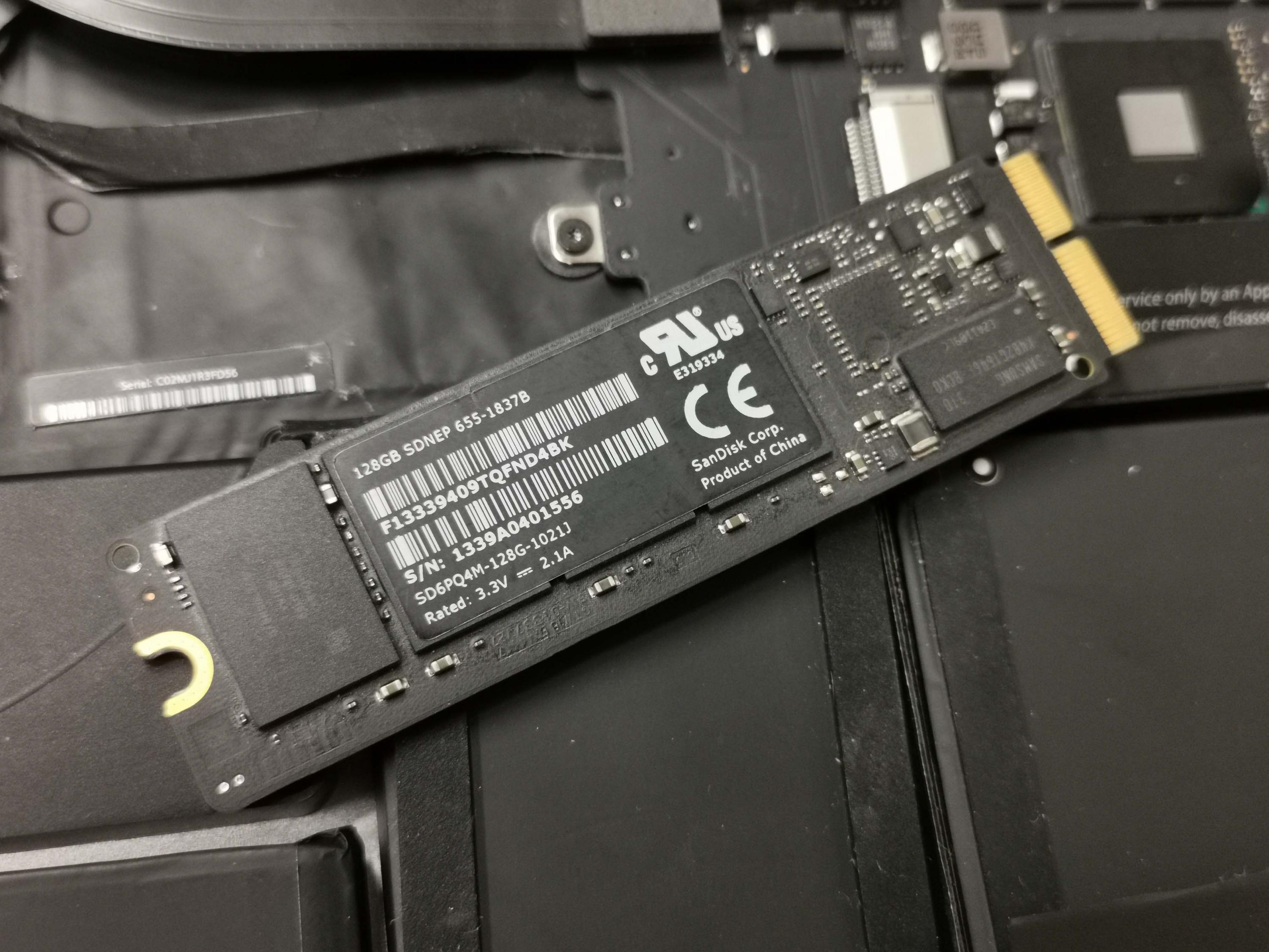

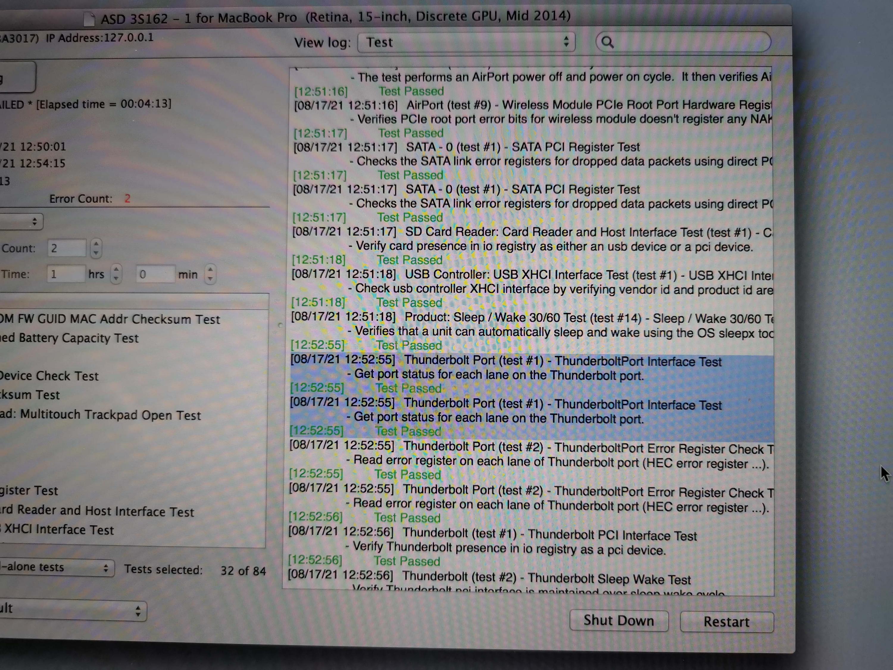

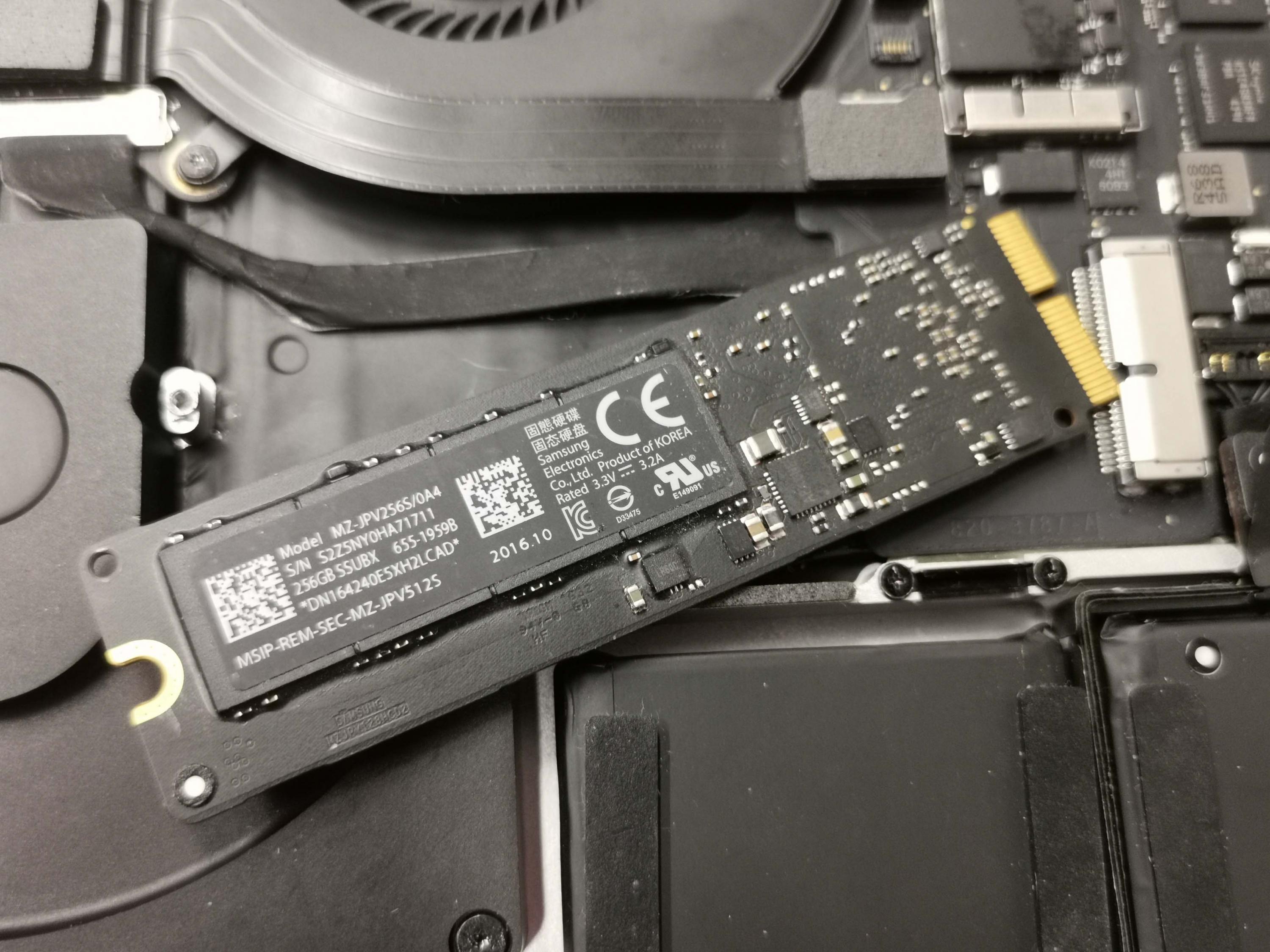

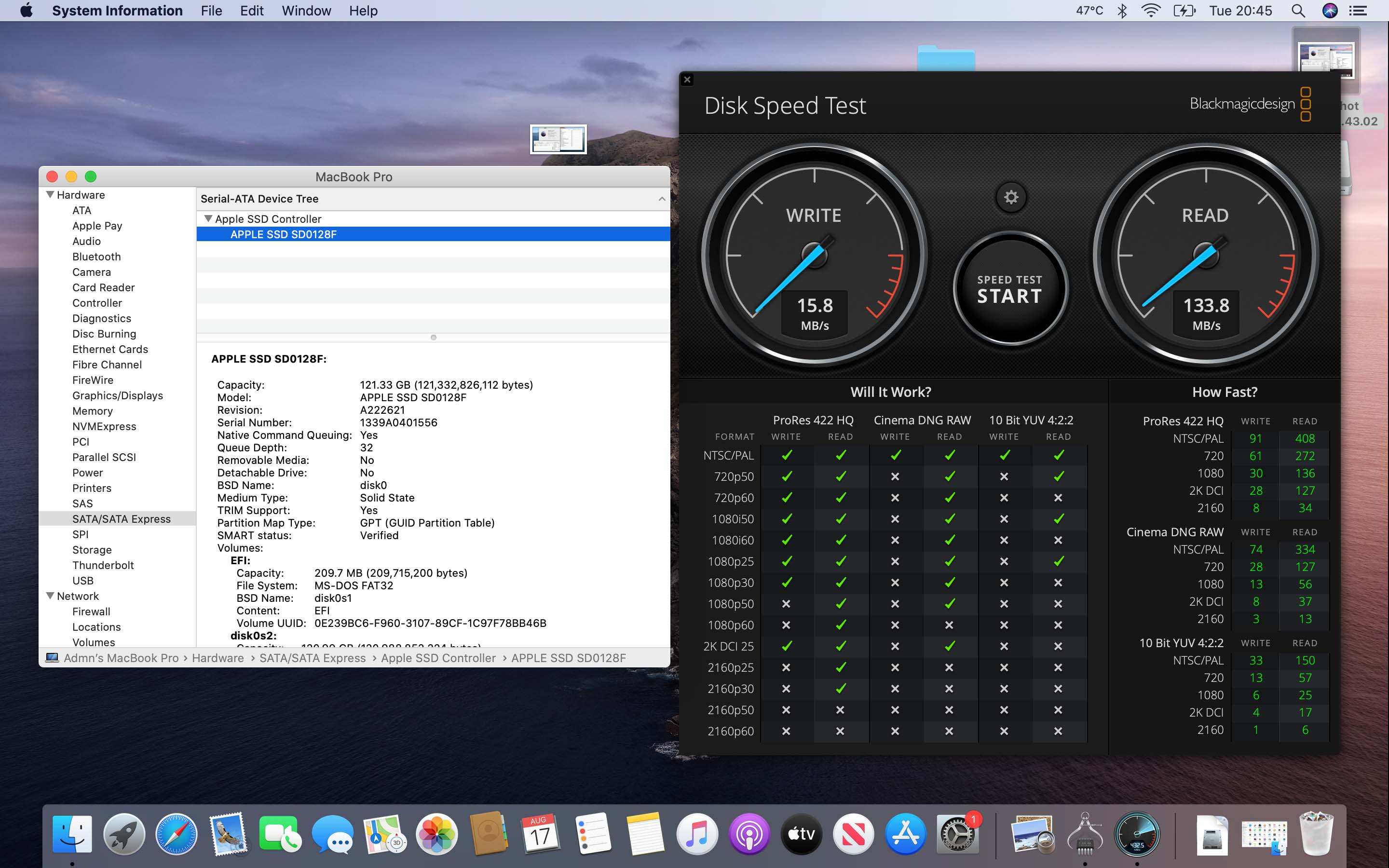

                Wanted to update with situation and close this thread. Issue resolved, however rather unexpectedly in a different way.
                With good intentions I didn't want to use original SSD with data while doing testing. Had a spare 128GB SSD from iMac, which has exactly same connection and was detecting and allowing MacOS install without issues (except FAN panic obviously). When I had it plugged in all those sensor problems were present. As soon as I plugged in original 256GB SSD for those models it all went to normal: no error on ASD, no FAN panic. Macbook returned with replaced logicboard and repair finished. Bizzare but fact that apparently it was reacting this way to another SSD from iMac. Something that I was surprised to find out later on. Only error when continuing on errors.
                Good thing that I haven't decided to ripping/replacing components in IHSC circuit - that would be fun to realize later ; )) Lucky decided to have a go with few more tests before that. Dismissed and many thanks for your replies, lesson learned.
