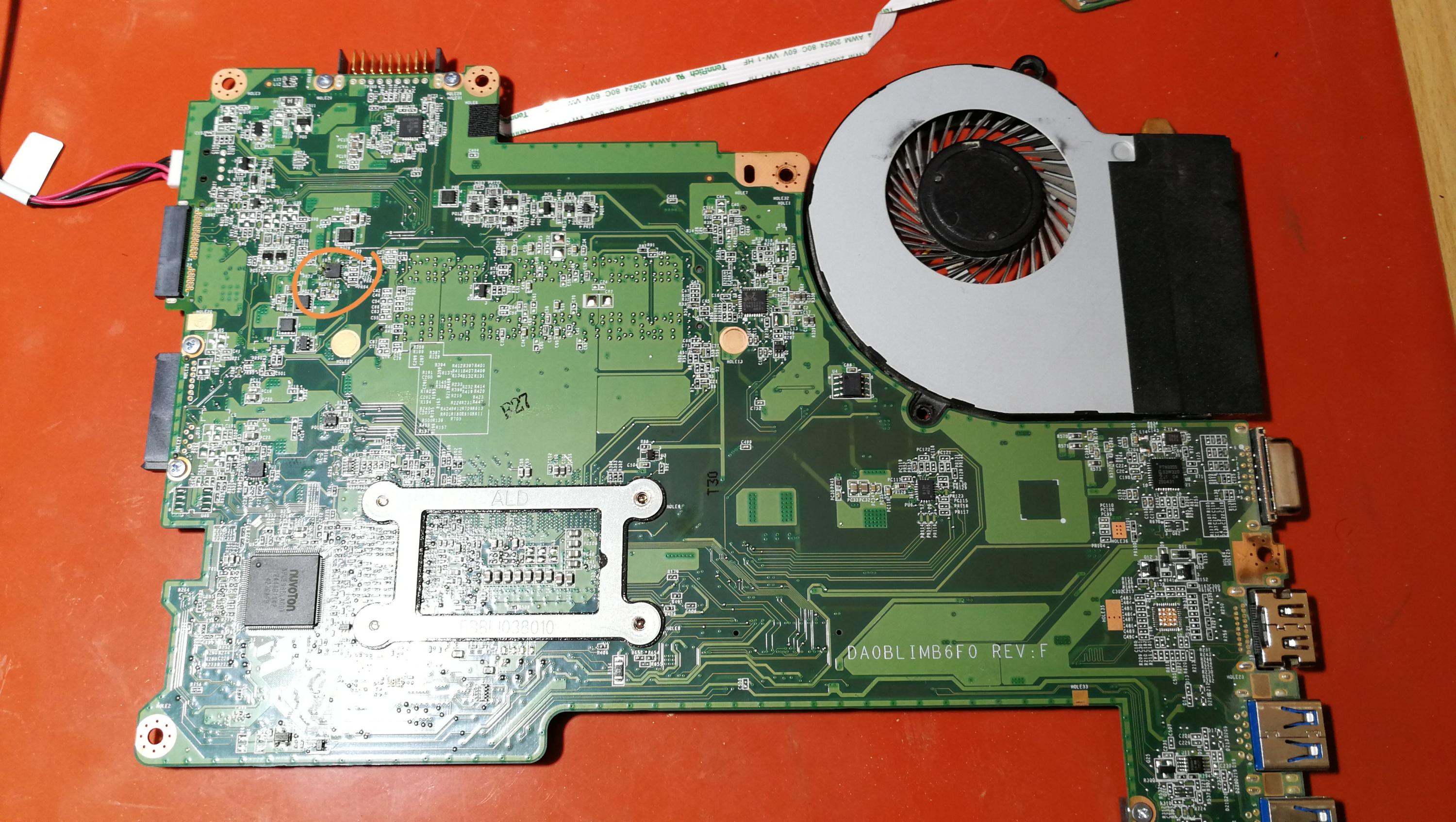

    Hello everyone, I have Toshiba laptop with DA0BLIMB6F0 REV F motherboard and
    i need to identify the number of PU216 IC (burned)
    Please help me!
    Thanks.

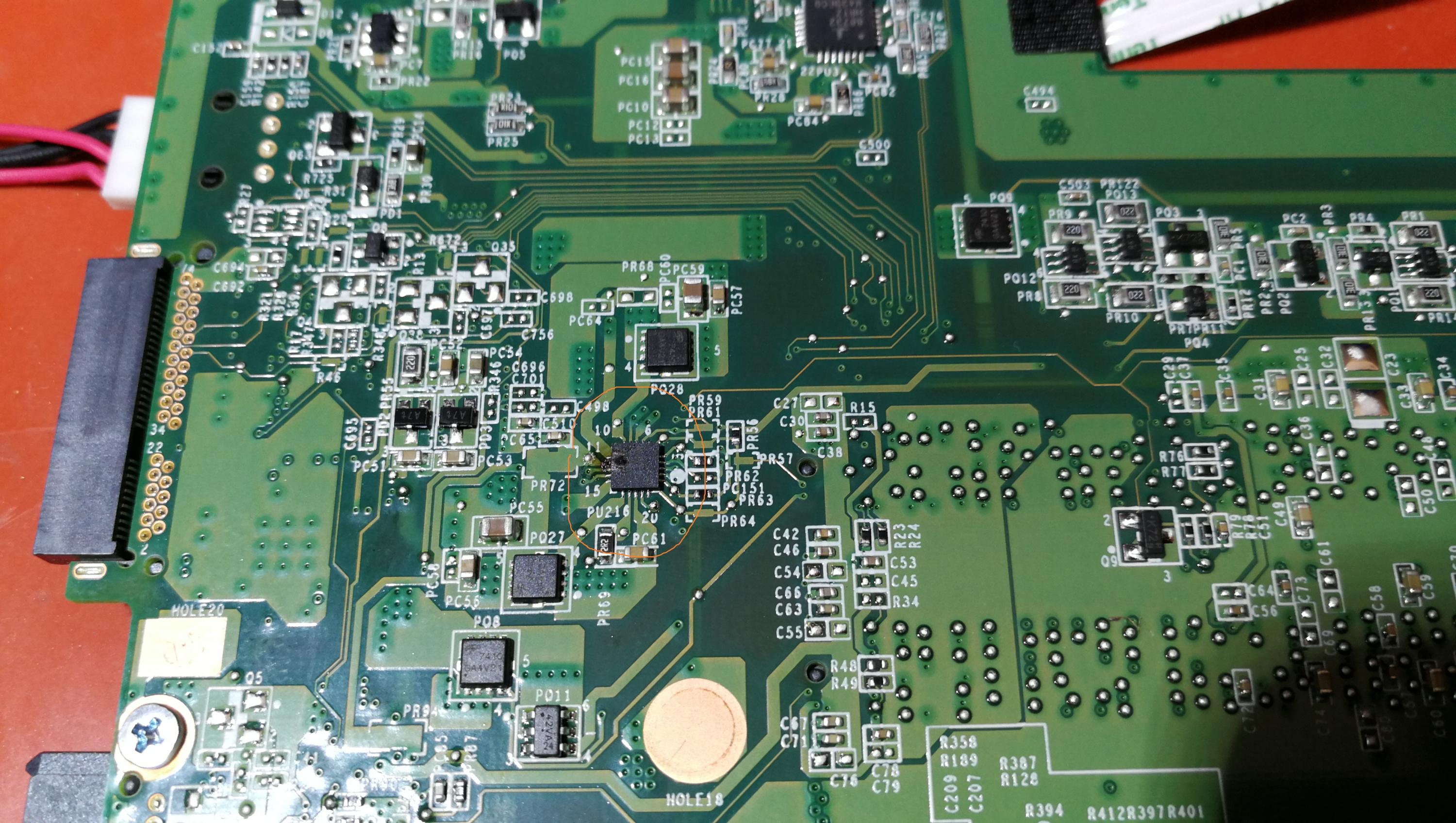

    Re: Helping me to identify ic number on DA0BLIMB6F0 board
    Apply a few drops of alcohol on the top surface of this burnt IC and then review the laser markings under a nice light. Post any markings you can view off the top surface.

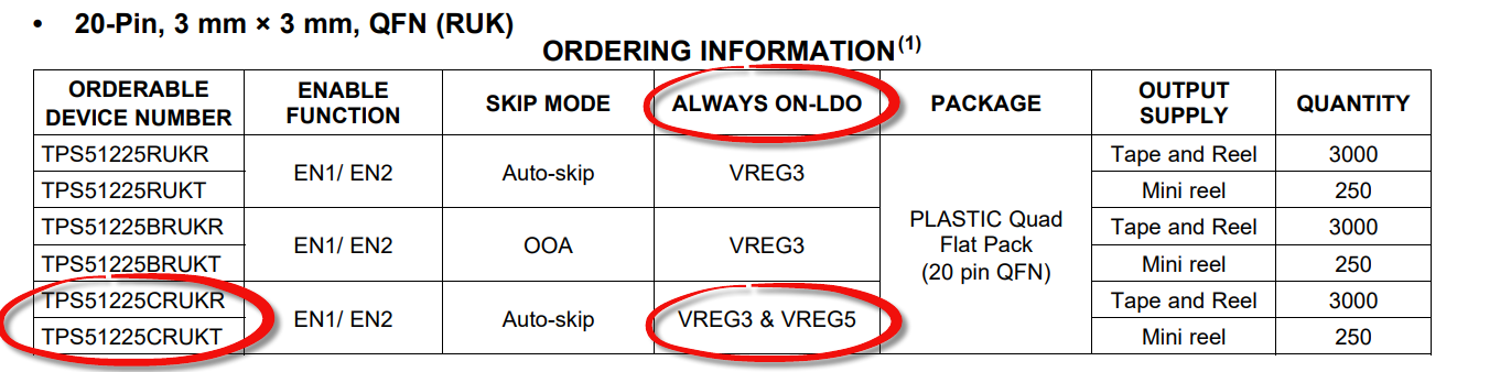

      I think your PU216 chip is TPS51225. good works. stby contoller.
        Good work!!
        My bets are on that it is p/n TPS51225C with VREG3 & VREG5 always on. The highlighted parts are present on the logic board.
          Yes, i's TPS51225C following the pinout
          Thanks.
