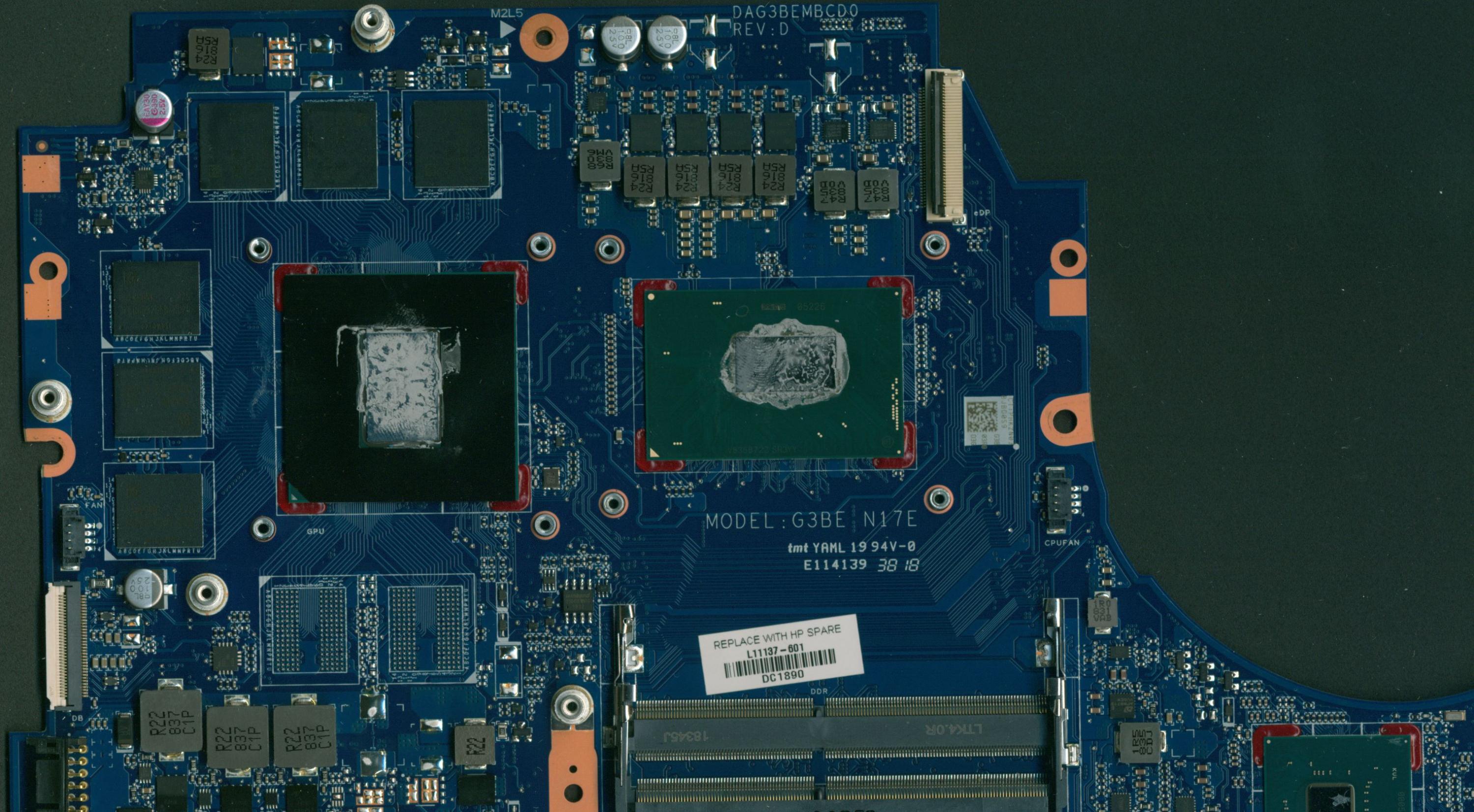

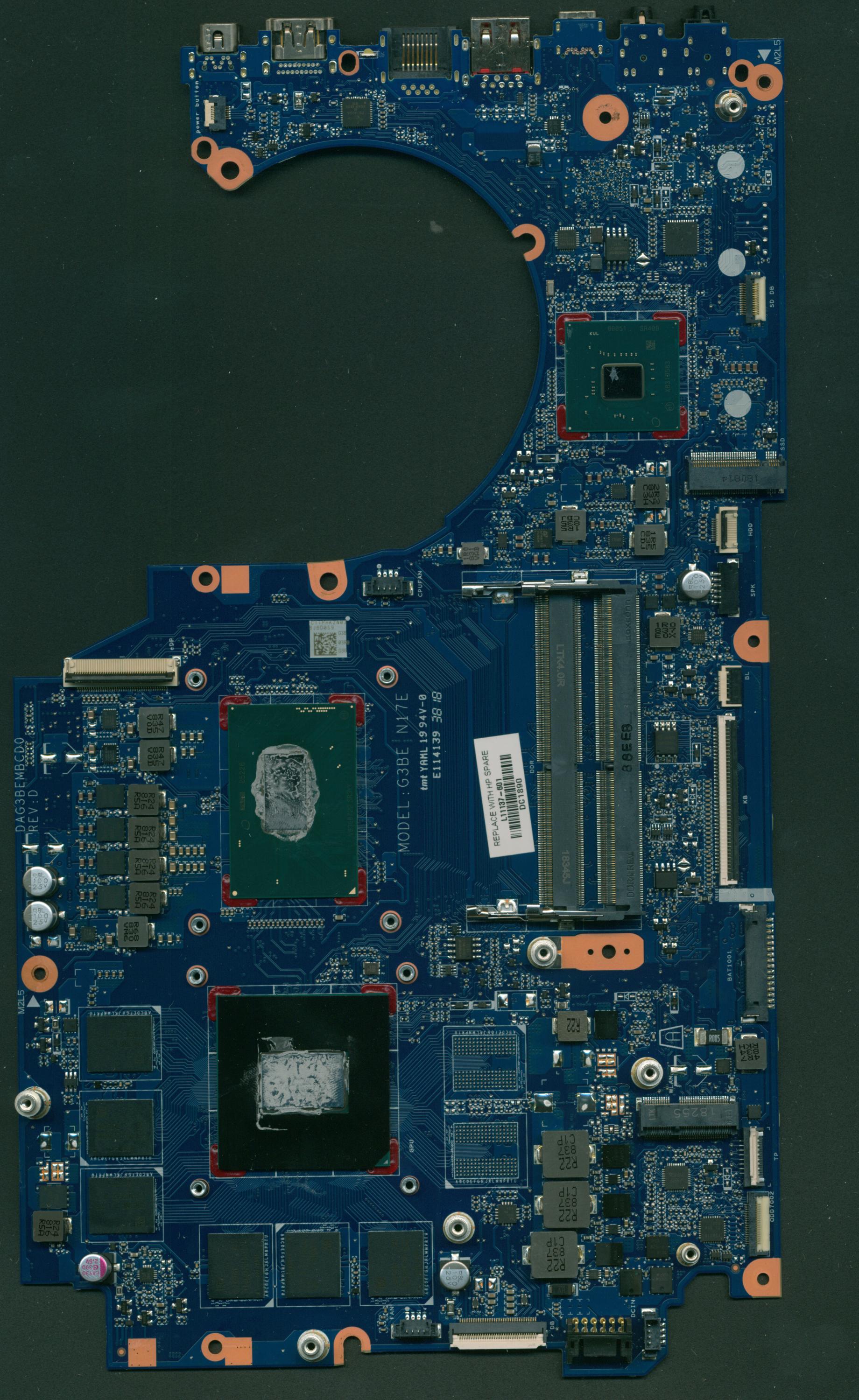

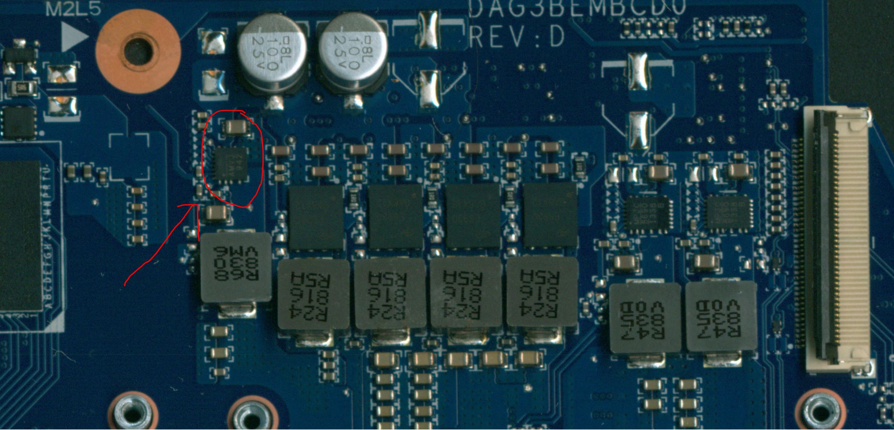

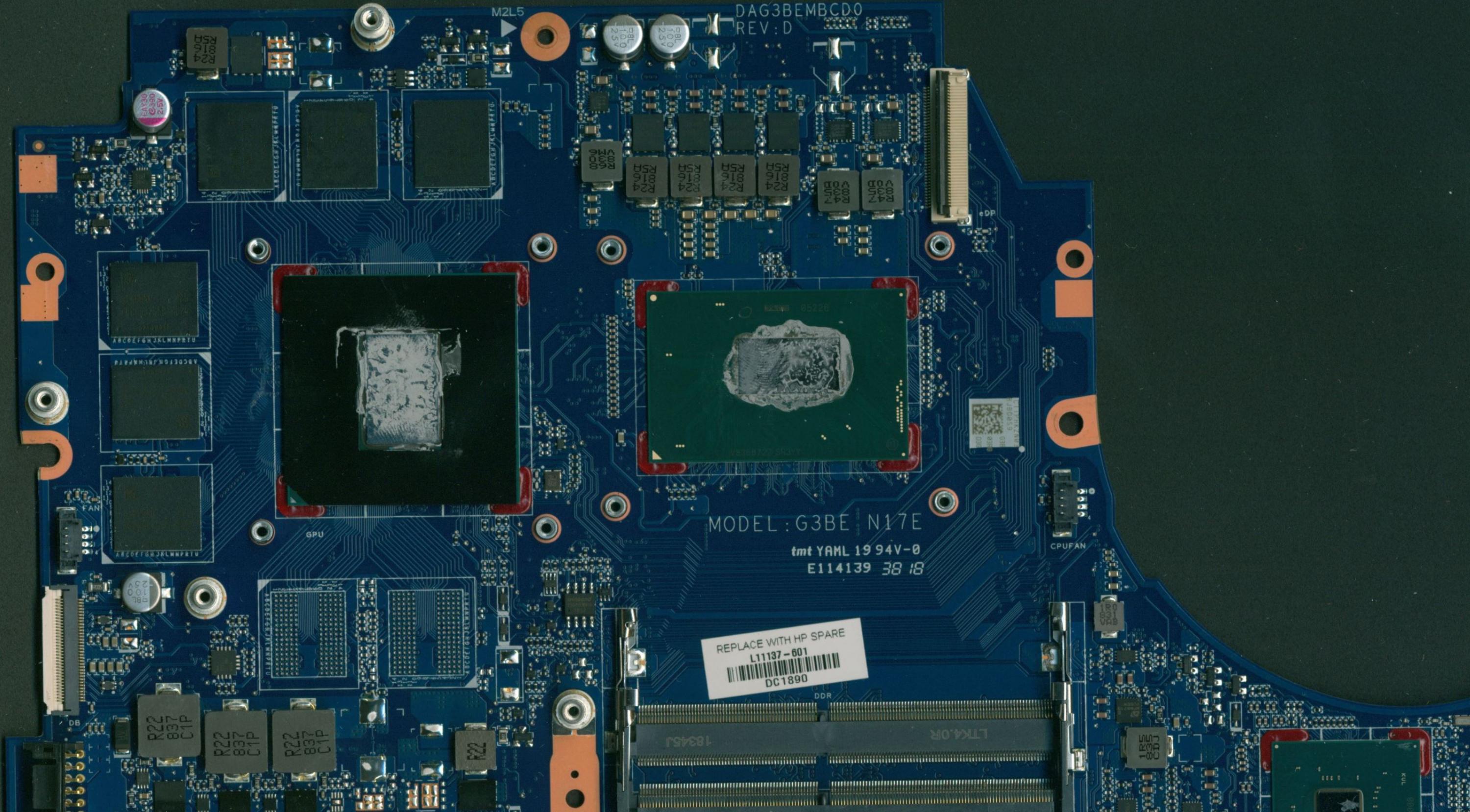

    Someone please help me - i want to know this ic number
    i didnt get the schematic
    dag2bembcd0
    IC AMVK672

    The marking code is AMV its a monolithic power MP86901-AGQTZ
