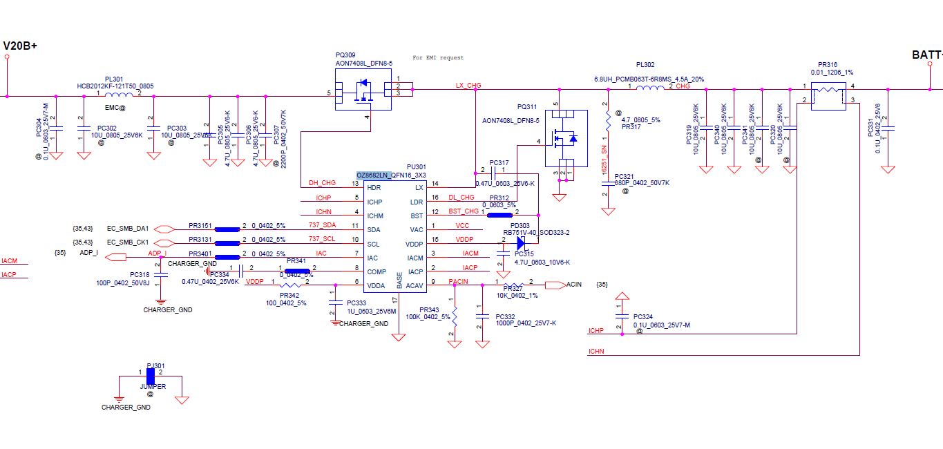

O2MICRO just for ref
  • emaghanim
    • Dec 2014
    • 129
    • egypt
    oz 8681l
    oz 8682l
    pinout

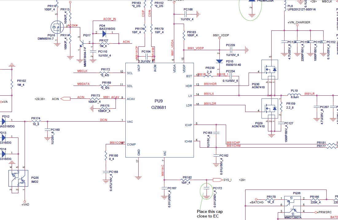

    Re: O2MICRO just for ref
    8682 8681 oz8682 oz8681

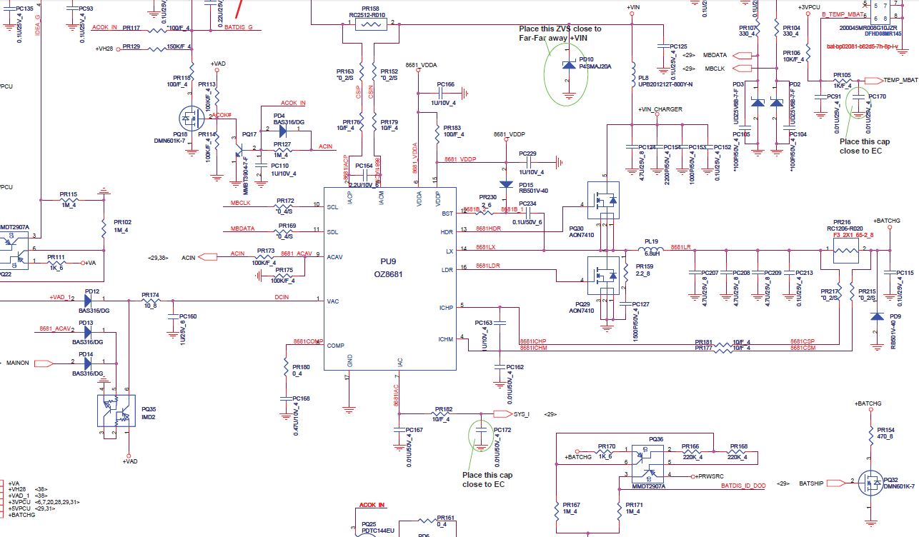

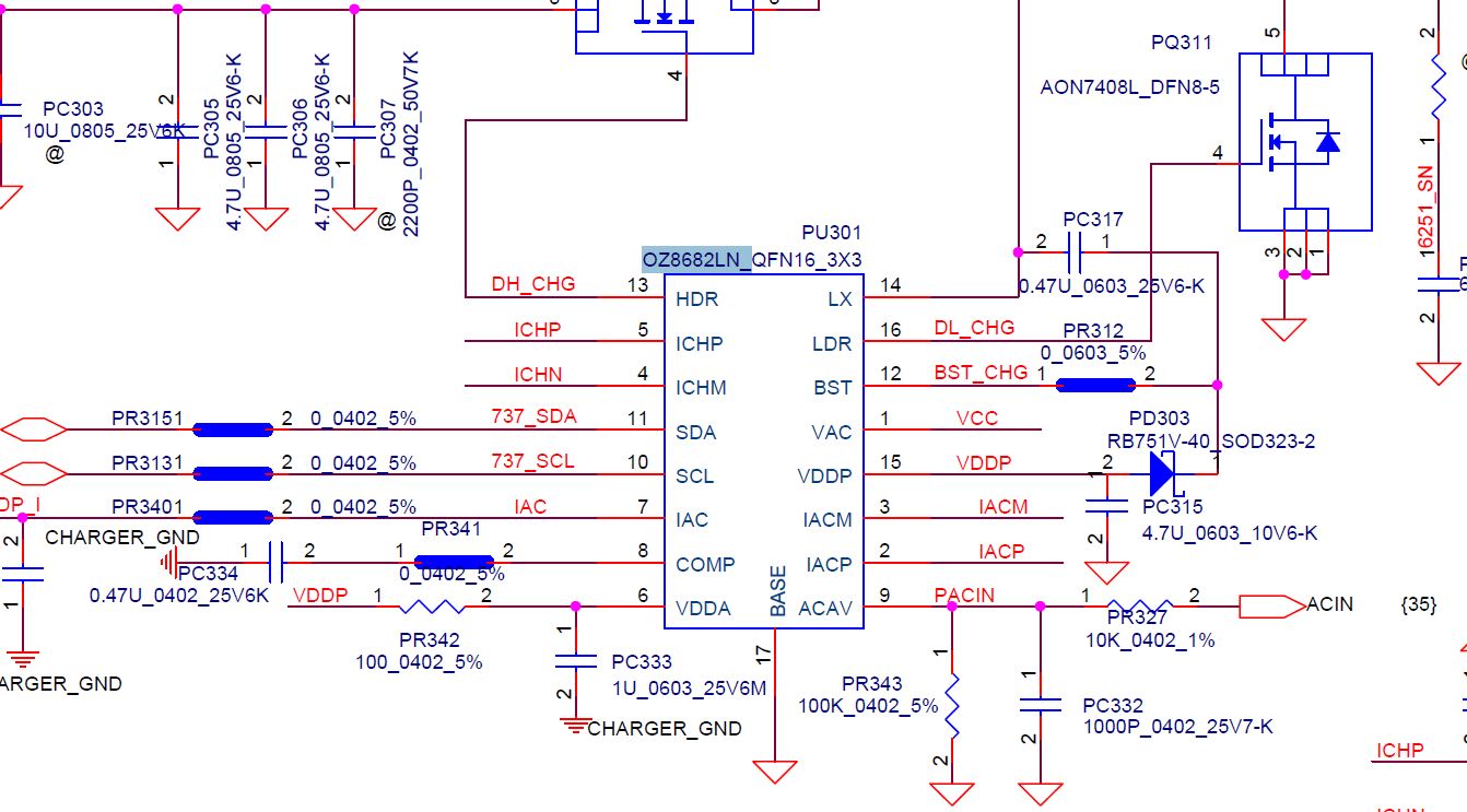

    • RichBon
      • Apr 2019
      • 54
      • Ghana
      Originally posted by emaghanim
      oz 8681l
      oz 8682l
      pinout
      sir please what will be the voltage at pin 9
      • mon2
        • Dec 2019
        • 14324
        You can calculate this value using an online resistor based voltage divider.
        However, from the referenced schematic, each resistor is @ 100k ohms so the pin # 9 voltage = 50% of Vin voltage. If it is not ~50% of the Vin voltage, then remove all power and measure the resistance of each of these resistors.
        • RichBon
          • Apr 2019
          • 54
          • Ghana
          sir please which of the resistors should carry the vin voltage. because I am not getting any voltage at PR327
          • mon2
            • Dec 2019
            • 14324
            PR173 resistor is mated with Vin. One side should be the Vin voltage. The other side mates with the next 100k ohm resistor to ground so the voltage @ pin # 9 = 50% of the Vin voltage since both the high side and low side resistors are of the same resistance.
            So even if you had 10k ohm for both of these resistors, pin # 9 = 50% of the Vin. As long as both the high side and low side resistors are the same, pin # 9 will be 50% * Vin.
