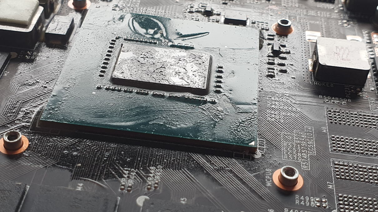

    Hello, I have a MSI GE73 laptop, I have no history on it except it was no falled nor liquid damaged. I dont started the diagnose, just saw the 19v rail is shorted at current resistor level.
    I noticed that ; GPU (on the pictures) seems was reballed, can you confirm pls ?

    Sorry, I mean "reflowed", not reballed. I confused.

      it has flux on it, it has been reballed or reflowed and not even cleaned after it.
      most like reflowed as it has all that flux on it. a good reball would have flux only under the bga.

        OK thank you, I'm giving up for this MB so
