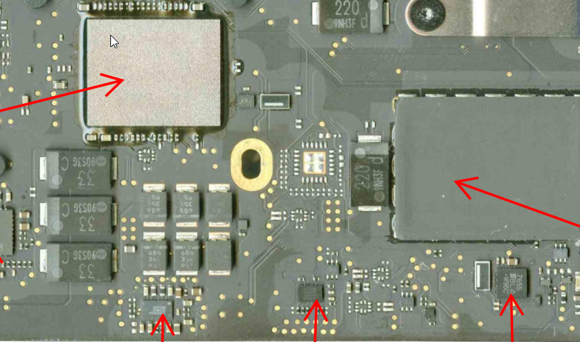

    Hi All,
    I'm trying to fix a 2019 macbook pro 13" 820-01598.
    I'll cut straight to the chase, if you need to see more history see below. Can the system boot without U5700? The caps & resistors surrounding U5700 and u5700 itself have been removed despite being told by it's original owner no one has opened this machine. Are these no stuff which has not been marked in the schematic/boardview?
    History is the previous owner left it on the roof of his car and drove off driving over the laptop cracking the screen, trackpad and whole chassis. He says he did not touch it after this incident just threw it on marketplace where I bought it. When I checked it out there were no signs of life, no image, could not see any backlight, no track pad click and no caps lock light. I opened it up it seemed like I was the first one in there. It seemed like the system was actually still on, no fan spin but the whole board was quite warm not hot hot but pretty warm so it definitely seemed to be powered on. I tried holding the power button to turn it off but that seemed to do nothing. I disconnected the battery and hooked up my amp meter and it looks like the board is taking 19.93V 0.0035a.
    I disconnected everything than powered the board and the board only. Again I was still only getting 19.93V 0.0035a. I noticed on the protocol it came up as Samsung. I switched over to my 29w Apple charger but that only changed the protocol to PD MTK everything else stayed the same. I than connected the board back in the chassis and hooked everything up and the board went up to 14.688V 0.349A and started fluctuating between that and 0.36A than briefly shot up to 1.126A and back down to 0.58A than back up to 1.36A than back down to 0.264 than I removed the power and re connected and now no matter what I do now I only get 19.93V 0.0035A. Even tried removing everything and powering only the board still 19.93V & 0.0035A.
    I went to go check the power sequence diagram so I checked PPBUS_G3H on CD760 & that is when I noticed all the caps & resistors surrounding U5700 and u5700 itself have been removed. I have not checked anything else as I'm assuming there's no point if U5700 is missing?
    Thanks for your assistance!

    Re: 820-01598 Crush damage - 20V 0.0035A
    Appears to be a no-stuff @ U5700 - does your logic board look like the attached pic ?
      U5700 has BOM option LOADISNS, not populated on production boards.
        Few, had me worried thanks guys! With these should connecting just the charger to the board alone power them up? I'm worried there's damage in the accessories (trackpad, screen, battery) so I want to try confirm the board works before I go adding more variables not to mention things that are likely damaged. Just seems strange that we shot up so high just once, when resetting the adapter it went back down to 35 ma and can't get anything since that initial blip. Is their any common damage areas with crush damage or should I just go down my power sequence diagram and see what's missing?
        Thanks!
          Thanks, Yes that area looks identical.
            Somethings not right here. Just checked for PPBUS_G3H on CD761 and I'm only getting 0.5v. Ohms measurements in the millions range so there's no short on the line. I'm thinking the boards not being told to turn on despite the charger being hooked up.
              This is a USB Type C powered logic board so the CCx lines on the Type C connector are used between the logic board and the external power delivery capable adapter (Apple is recommended). Check the power rating for this system to use the same.
              Once the two parts are mated, the power adapter and the logic board will exchange power contracts and the adapter will be required to supply the 20V rail to power this unit.
              1) Post the voltage @ PPDCIN_G3H.
              2) PPBUS_G3H @ F7000 without battery but with external power adapter.
              3) PPBUS_G3H @ F7000 with battery.
              From my (limited knowledge) of the Samsung products, funky D+ / D- lines with assorted resistor voltage dividers are used to dial up the proper voltages for the target Samsung units. The results from the Samsung devices is not relevant for the Apple devices which are USB Type C Power Delivery designs.
              Just saw your new post...
              Confirm the input voltage is ok. Check status of fuse F7000.
