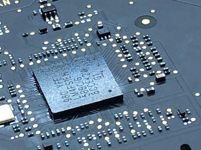

    ok someone already touched smc as it doesnt have glue on its sides.
    try reflow or reball it.
    ps: what is that mark on smc ? burn or some very small damage ?
    at the begining all measurements drive me to the same direction and I start to reball SMC, first of all, because I didn't find water damage / no liquid ... after SMC reball no change, same voltages ...
    I clean SMC now, it was dirty

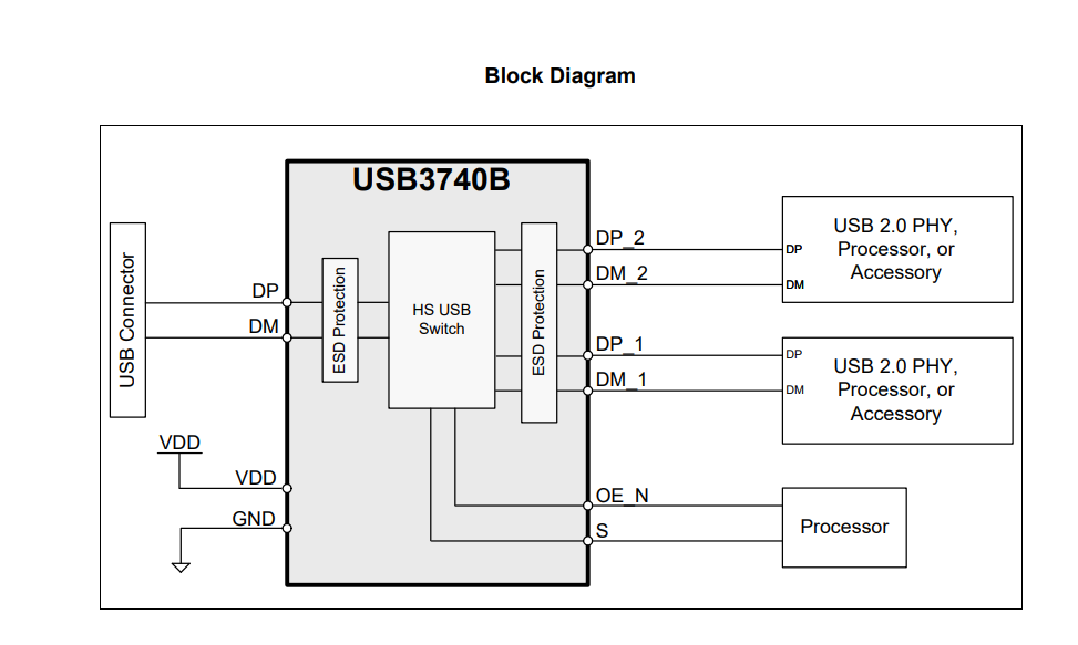

                  found short on U3510 ...
                  removed, and now I have voltage on most rails ...
                  USB3740, it's usb ic or bluetooth?
                    #29
                    Re: MacBook Air a1466 820-00165-a doesn't start
                    Very nice!
                    https://www.microchip.com/wwwproducts/en/USB3740
                    It is a USB signal switch so that a single port can mate with 2 different USB devices. Like a DPDT switch.

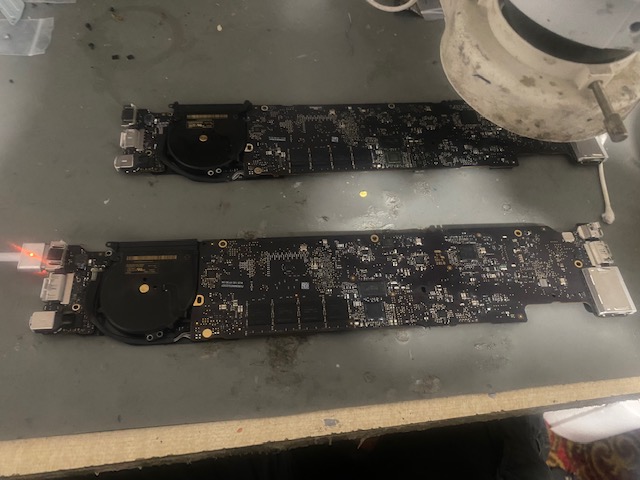

                      hi there i don't know if i am allowed to post on the same thread or not, i have same issue, the reason why i am quoting here is that i have measured all pp3v42_g3h and every where i do get 3.42v but l5001 pin 1 there is 0v
                      i am trying to understand is this smc issue, i have the exact same board
                      regards

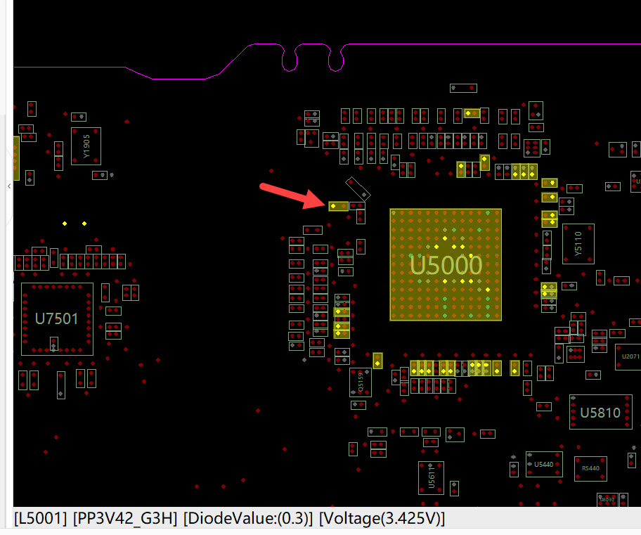

                        That is a very good observation !
                        Indeed there should be 3v42 present on pin #1 of L5001.
                        Remove all power / no battery.
                        Meter in resistance mode (2k scale is ok). Use the meter to check for continuity between a known good PP3V42_G3H point and pin # 1 of L5001.
                        You should see ~0 ohms between the 2 test points. If you see OL = over limit then there is most likely a damaged via or trace so the voltage is not reaching L5001.
                        After this confirmation, consider to take a piece of wire from a known good source for the PP3V42_G3H rail and solder it onto the pin #1 of L5001 to make up for the broken connection.
                        Confirm the continuity with the meter and then proceed to test again with your power adapter.
                        Post your results.

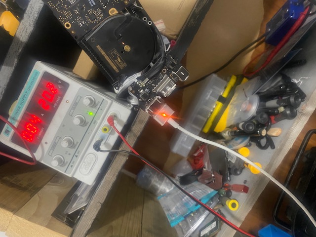

                          so i measured in quit a few places with a good pp3v42 and i am getting red probe pin 1 l5001 3.50 kΩ
                          do i still proceed with the wire?
                          also to add board draws 20v 3 amp
                            #33
                            Are you using the original power adapter ? 20V ??
                              #34
                              hi yes i am and also i have power supplier

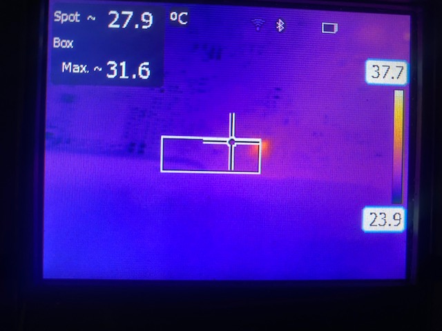

                                the only thing on thermal camera which shows is u7100 but i have changed this with a new one, i have about 10 spare new ones
                                i don't understand 2 boards with same thing showing on thermal camera both faulty
